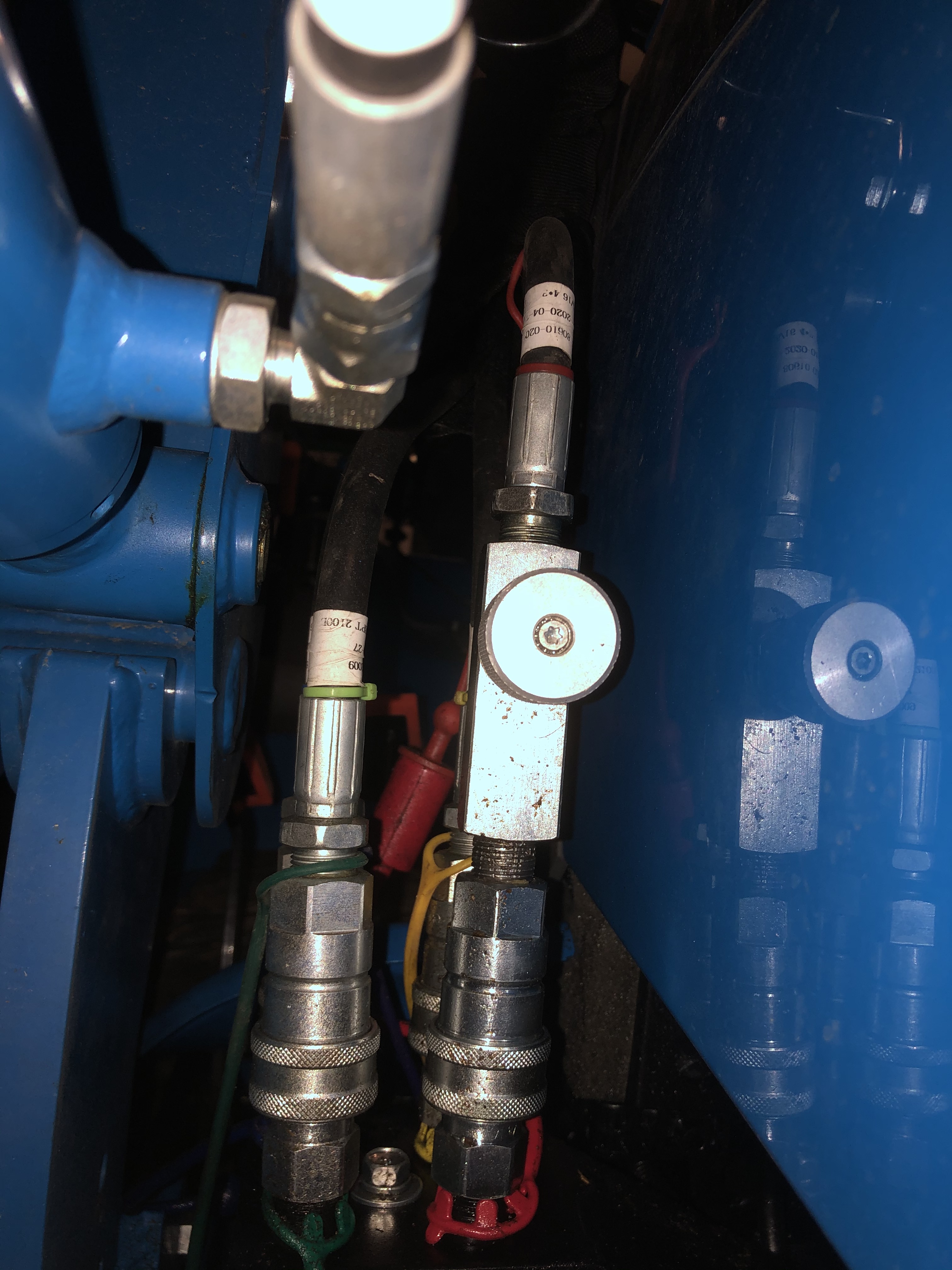

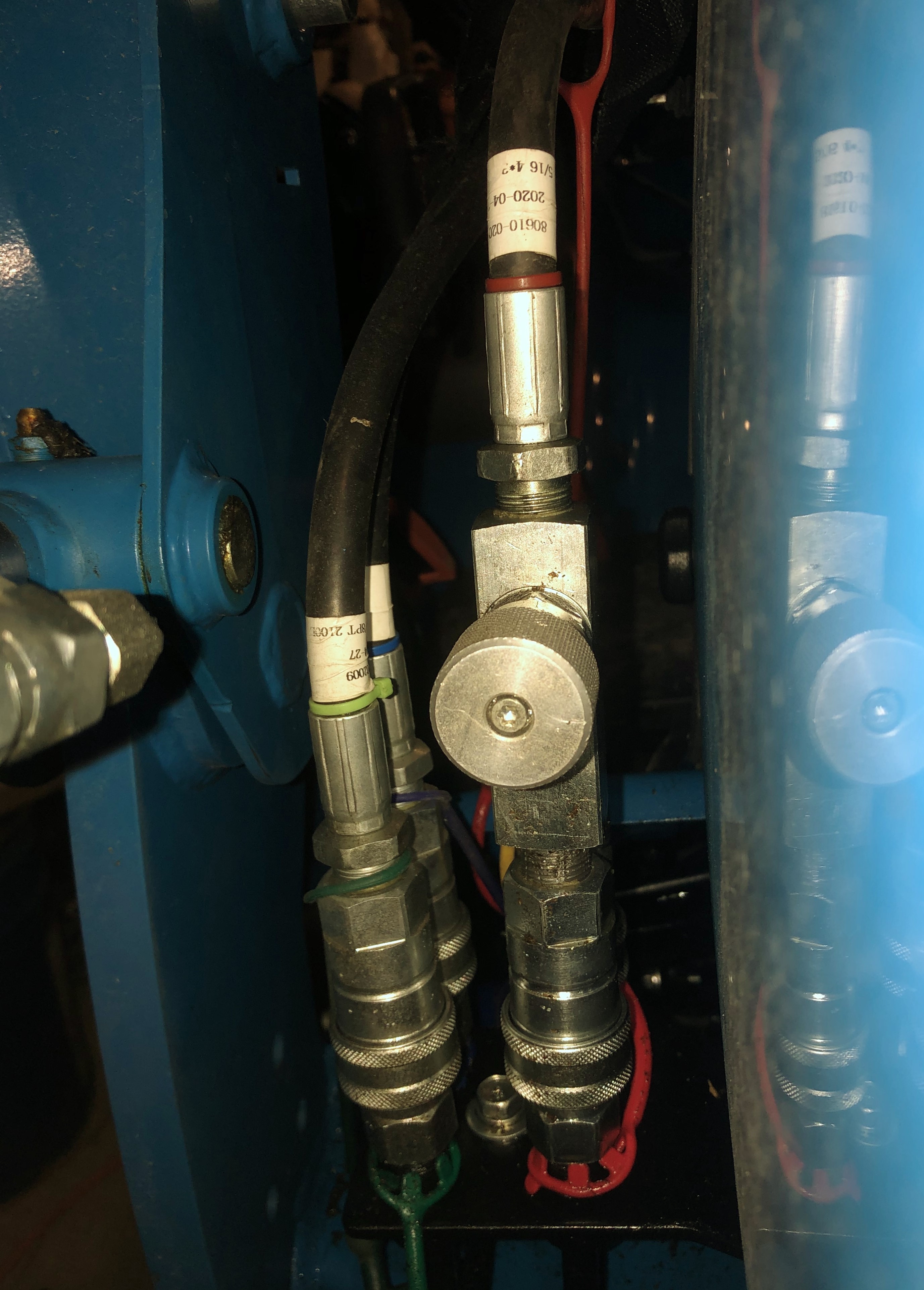

Thanks for all to comments! I have dug out a couple of stumps, moved tons of dirt and manure (at the stables where we keep horses). I did put a flow restricted vale on the FEL hydraulics that helped with the floppy bucket issue.

Could you explain a little more about the "flow restricted valve on the FEL? Sounds like and interesting mod.
   / New LS MT 125 owner!
The dealer placed a restricter value on the drop side of the bucket hydraulics. it is a rheostat type valve that I can manually adjust the flow. I keep it pretty tight which makes the bucket dump a bit slower but gives better control when using the bucket to scoop material. it seems to keep the bucket from rolling forward when digging/scooping.
