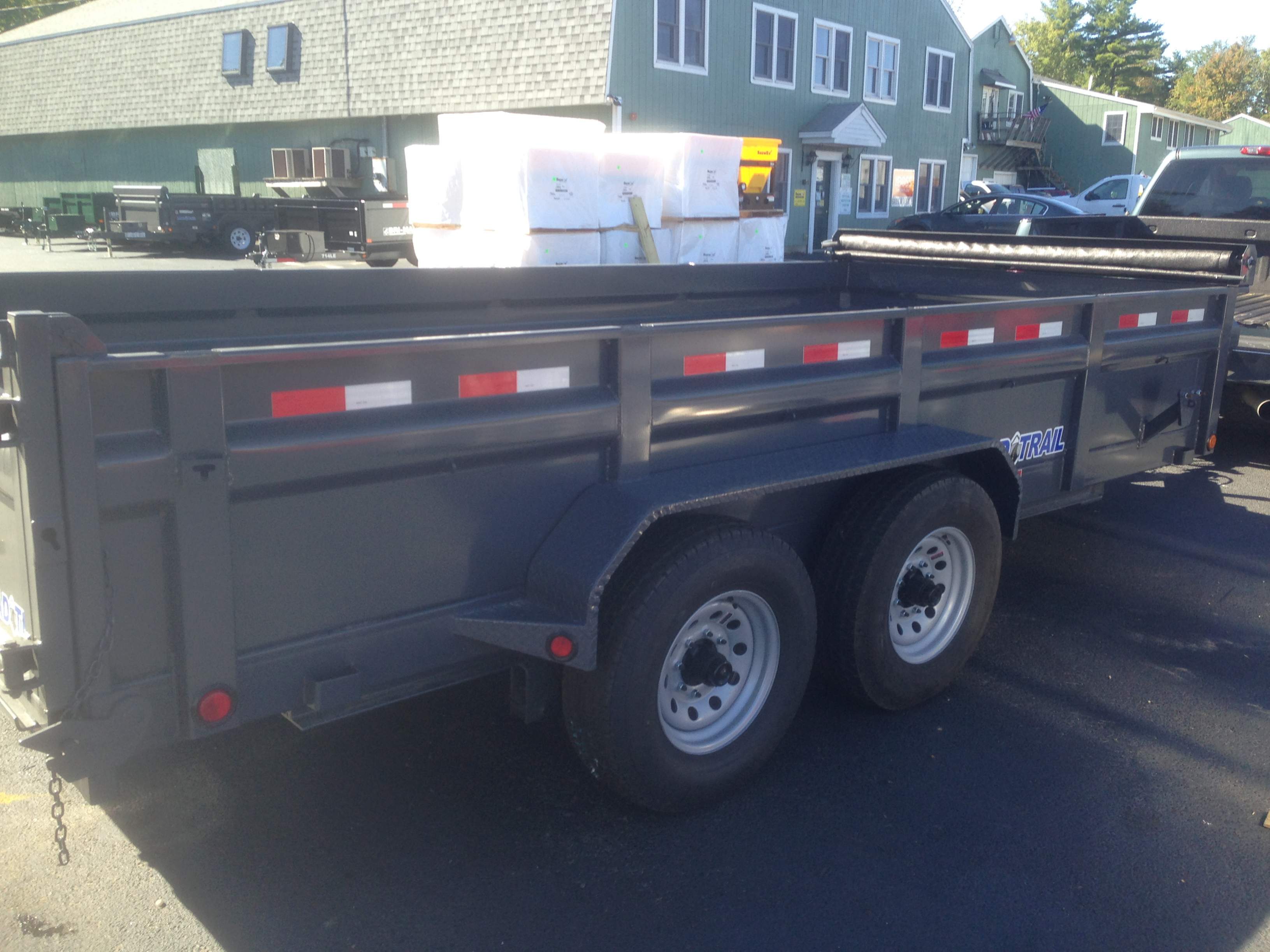

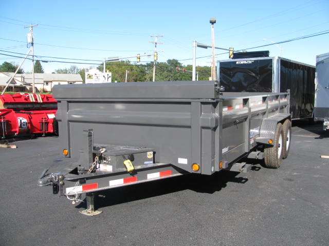

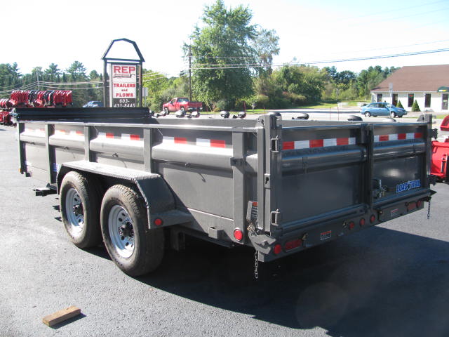

I picked up my new Load Trail 16' Low pro dump yesterday. I ordered about 4 weeks ago and it showed up at the dealer last weekend.
I had the fork pockets done custom as they weren't an option on the low pro dumps. Overall the trailer came out great and tows like a dream(for a bumper pull).
The paint job is pretty good overall. I did point out a few imperfections to the dealer who's getting me some touch up paint(even though it's powdercoated).
