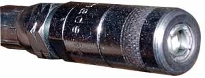

I bought a new Lincoln grease gun (1134). I loaded up the grease cartridge, stuck it on a fitting on my FEL (Kubota BX24), greased it up and then tried to get it off. Can't. Pull, pull, twist every way, pull some more...
Anyone have any suggestions? This really pisses me off.

Did you try and loosen up the end on the grease zerk?

On the grease fitting, you should be able to loosen the grip on the nipple by turning the knurled part of the fitting on the gun. You may have to use pliers the first time as it is tight from the factory. This will loosen the jaws grip on the grease nipples.

On the attached picture. The knurled end can be loosened and adjusted to fit different nipple sises.:D

OK, I'll try it. I did try to loosen it with some pliars, but I probably didn't do it hard enough. Thanks.

Sorry, that last post probably wasn't very helpful to the OP. After squeezing grease in the zerk the gun head build pressure making it near impossible to remove; loosen the gun head and it comes right off.

I got the knurled end loosened and it came right off. Thanks guys!
