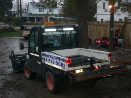

I installed some new LED lights on the back so people can see me easier for braking and turning. My rear blade hides the existing ones. They just plug into the trailer wiring harness for quick removal. I also removed the rear tailgate for better visability to the rear blade.
How effective do you guys find "float" mode to be when pushing the snowblower? Mine seems to take quite a bit of effort to shove forward. It really tears up the road surface as well. Any opinions?

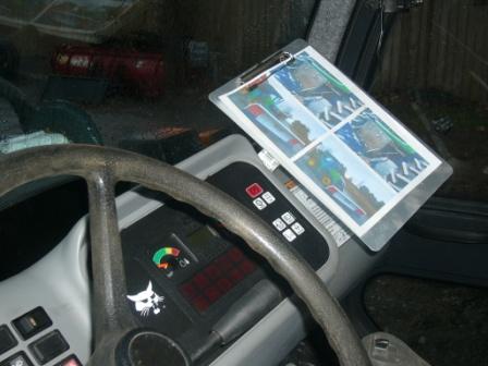

I also installed a clipboard so I can keep map of my route handy.
here are some pics.

Well, i figured out the problem with the float mode. The cutting edge was mounted upside down and instead of gliding along, it just dug right into the pavement making it difficult to push along. I knew something did not feel right.
I flipped it the other way, changed the attack angle and had smooth sailing. Must have been an off day at the factory.
