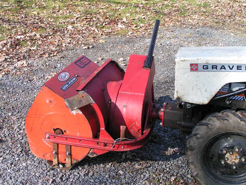

Hi! Last year My snowblower Gravely gearbox was broken. I found a good Auger and gearbox from A COLUMBIA 10-28 snowblower Same width same rotation same shaft dia. The Problem was shaft height of Gravely blower vs shaft of Columbia 10-28 Differ 2.5 in. Now I wait for snow. Good luck! Oldmech
