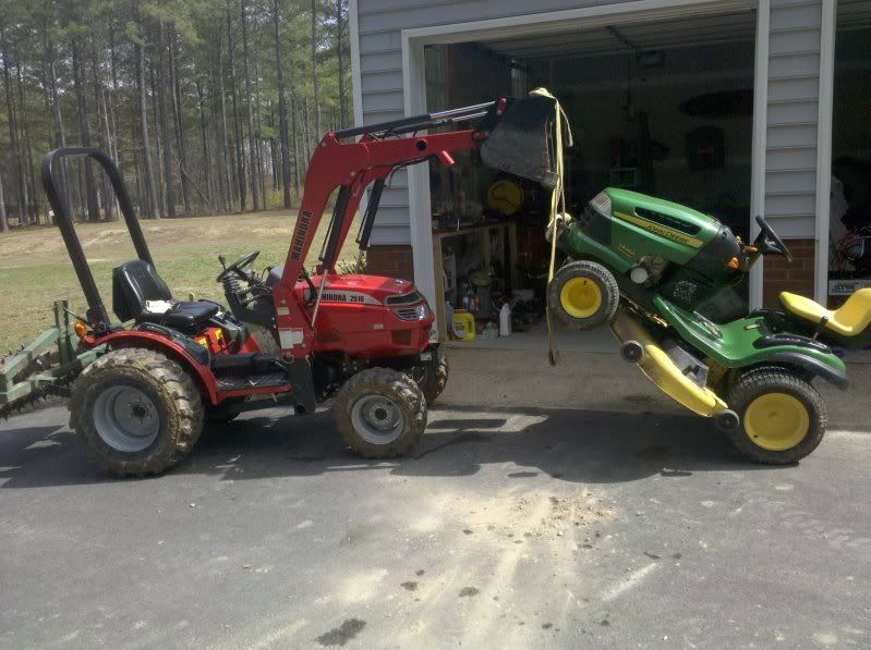

Good post Gator. Yes I had the same problems. One of the three blades were loose so I had to tighten it. Cured the "row" effect.
Mine will also backfire unless I throttle it all the way down before I turn off the key.
Also FWIW it is great to have a tractor around when you need to swap blades ;)
