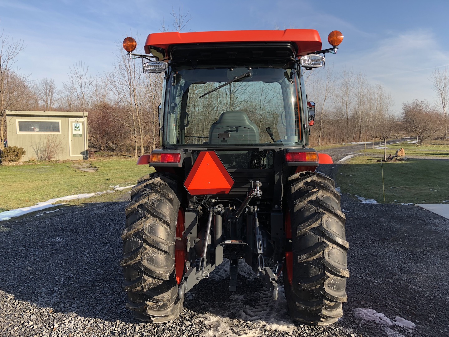

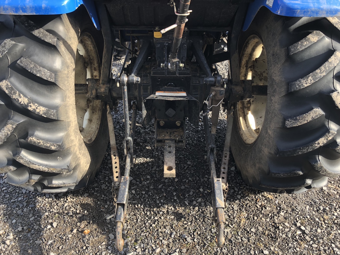

On the other business end - things are very similar here.
The telescoping arms were mandatory (and standard on the L 60). Another point for the TC45DA tho is that the drawbar could be offset simply by pulling a single pin and pushing the bar to the side. Now - the Kubota makes it easier to REMOVE the drawbar - so that's not really a big deal. But when I put o nthe big 2 bottom plow - the bar will have to come off now, not just be offset. Again - not a deal breaker - and - I'm telling myself the tradeoff here is again added capacity in the 3pt lift on the Kubota. At first I didn't really like the pin for the adjustable sways on the Kubota - then I discovered there's little pins that hold them in place - while I think I like that more - ask me again in the middle of summer when I'm looking for a dropped pin in the tall grass.

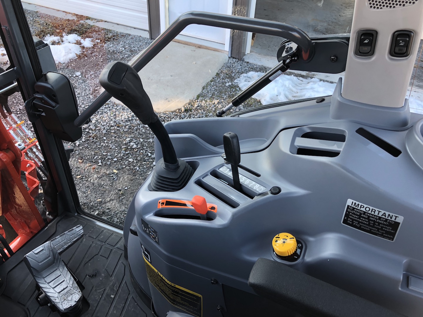

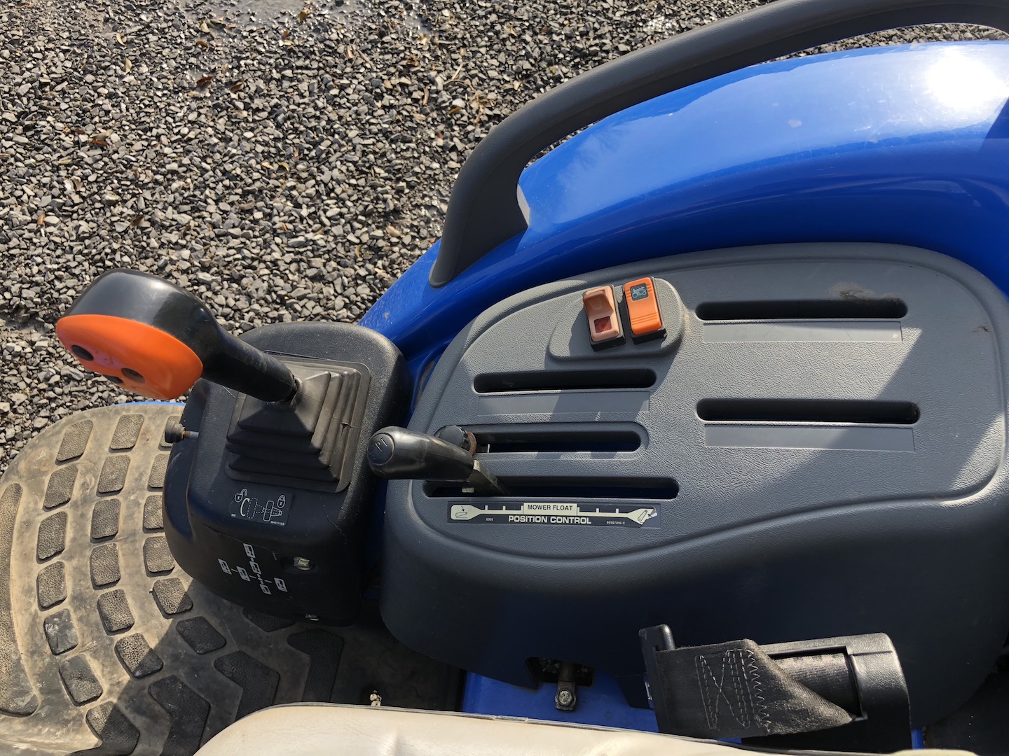

In the drivers seat - there's definitely an awareness that you have moved on to a new more modern and comfortable tractor.

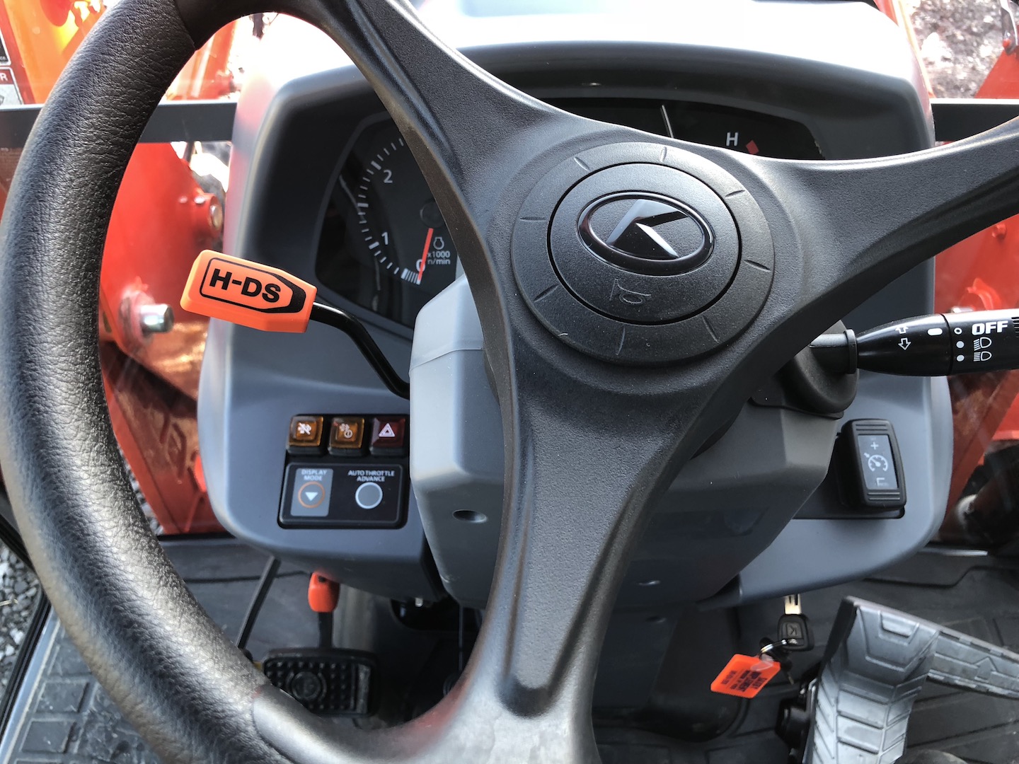

The array of buttons knobs and levers is strong with the Kubota. Lots going on and that's not even lookin at all the menu options in the IntelliPanel! The ease of adjusting the steering wheel on the Kubota is awesome. Step on a lever - move the column, get off the lever, done. All the buttons and knobs and levers feel solid on the Kubota and I don't worry about something falling off when I have big gloves on (i.e. when I'm not scared of the shine on the newness). Ohh - and the Kubota has a horn. That will actually be useful when I need to get my wife's attention... and it will also be useful in getting her to wave at me with a single finger - I'm excited about this feature! All the buttons and gauges and lights are very visible - I like this layout a lot. The digital "RPM speed" is friggin cool as opposed to trying to get your RPM's to the tic mark on the tach... technology is cool.
As for the other operator controls - the TC45DA was sold a a "deluxe" tractor - so the jump in creature comforts isn't HUGE - but Kubota did a great job laying things out.

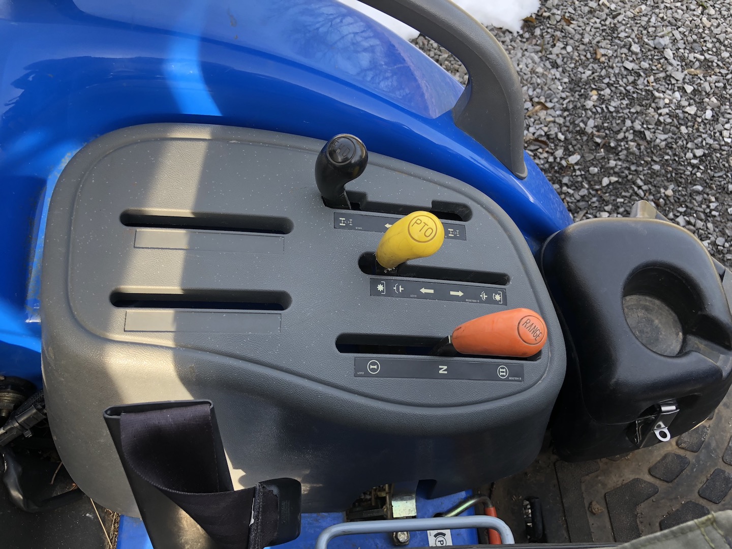

I tried to show you the NH view of the right and left fenders of the operator platform and then again the same thing for the Kubota. I don't know that anything anywhere is really better - although there is one thing that is a "I miss it". So - the TC45 had on the loader joystick a rabbit and turtle button... so while the physical shifter had a high/low range - you could cycle between high/low in a given range... JUST LIKE THE KUBOTA (except the Kubota has 3 physical ranges L/M/H)... the difference here is the Kubota uses an orange lever on the left of the steering column to let you toggle between the L/H of the physical range. THe NH had that option as a switch on the fender AND as 2 buttons on the back of the loader joystick. That was REALLY nice when you were doing loader work and needed to slow down for a pile - puch into it - and then go back to H to deliver the bucket.
At first blush - I miss having the range selection on the joystick... BUT - it's really silly to - as the kUbota has so many features and modes of driving (and the throttle boost button on the joystick) that in practice once I get used to the Kubota and its setting for a given job - I don't think I'll miss those 2 buttons on the joystick at all. The Kubota's programming options are so much broader than just 2 buttons!

One thing I'll mention, as you do loader work, the left hand is on the wheel, where it us easy to flip that hi-low level with your fingers.

@buckeyefarmer - I see what you mean and that works most of the time (in my playing simple size of less than 10 minutes) but if you are doing loader work I still contend the buttons on the joystick are "easier"
