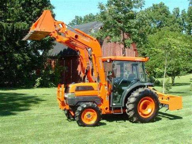

I have had similar issues with my L4330. I have the LA853 loader, filled R1's, 300lb wheel weights, and a 6' Woods Box Blade. I have had it weighed and it is about 7,300 lbs. I have killed the engine several times digging in clay ground with the front bucket/toothbar while in low range, high RPM. Using the hydraulics on the loader to pry and dig while driving forward in tough soil seems to max it out. I think that because of the 7,300 lbs of weight plus the force of the loader prying or lifting: the tires do not spin on the hard clay. If the tractor didn't have as much weight on it I'm certain that the wheels would spin before it stalled.
I absolutely love the tractor but if I had to do it all over again I would get the L5030 for the added HP.
