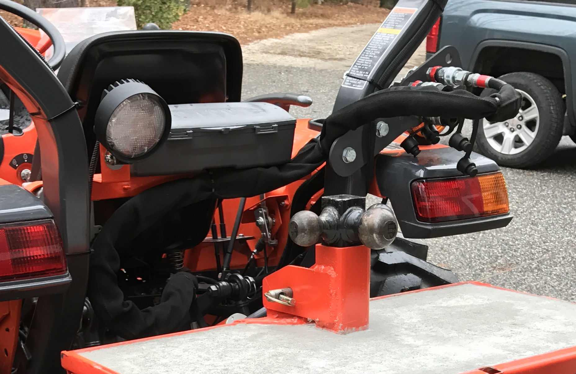

You can order custom hoses from Discount Hydraulic Hose -- get exactly what you need with the length and fittings desired.
The stock mounting position of the Kubota remote hookups is over the right fender. There really isn't enough room to have it inside the fender, at least not without interfering with many implements when you raise them on the hitch. So I wouldn't change that arrangement without careful testing.
For the top link on my L3200 (same tractor but previous generation of your L3301), I got hoses that were 5'6" and 6'2". The hoses run from the quick connects, across the toolbox bar behind the seat, and then loop around to the top link.
You can see the hose routing for the top link here:
For my side link, I used two 5'6" hoses. No good photo of that, but they just dangle down from the quick connects to the side link with a single loop twisted in to manage slack. The side link moves up/down with the 3-pt arms and needs a fair amount of slack to cover the range of motion.
