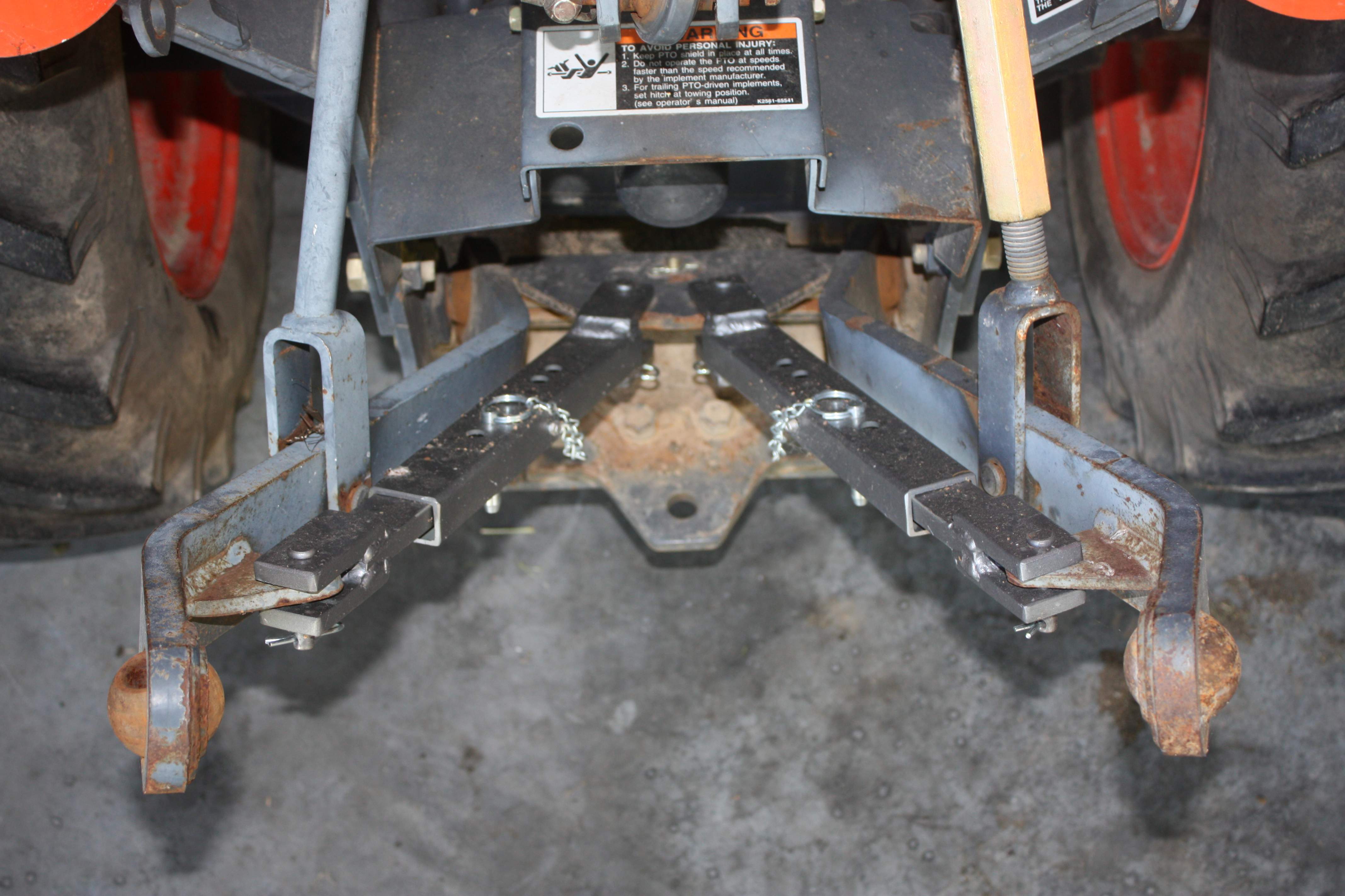

One of the best things I ever got for our BX's was a set of stabilizer bars to replace the turn buckles from hodge: StabilWorks
