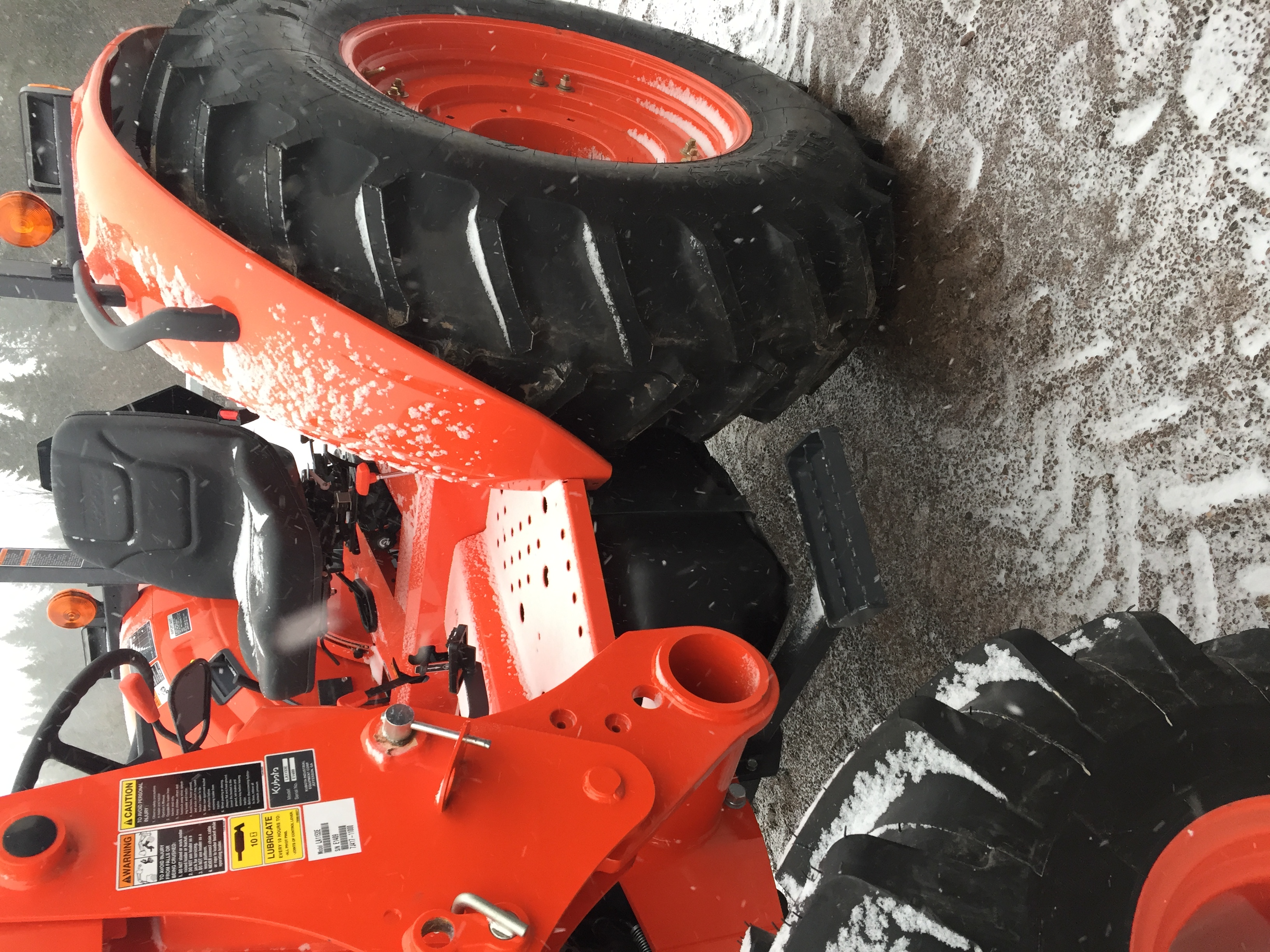

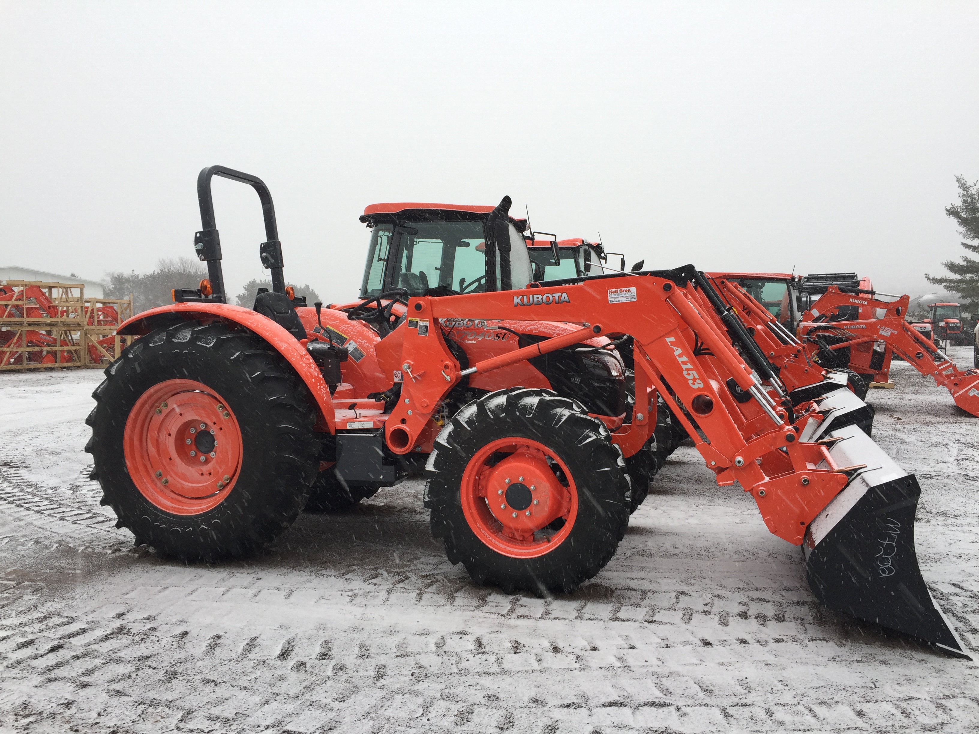

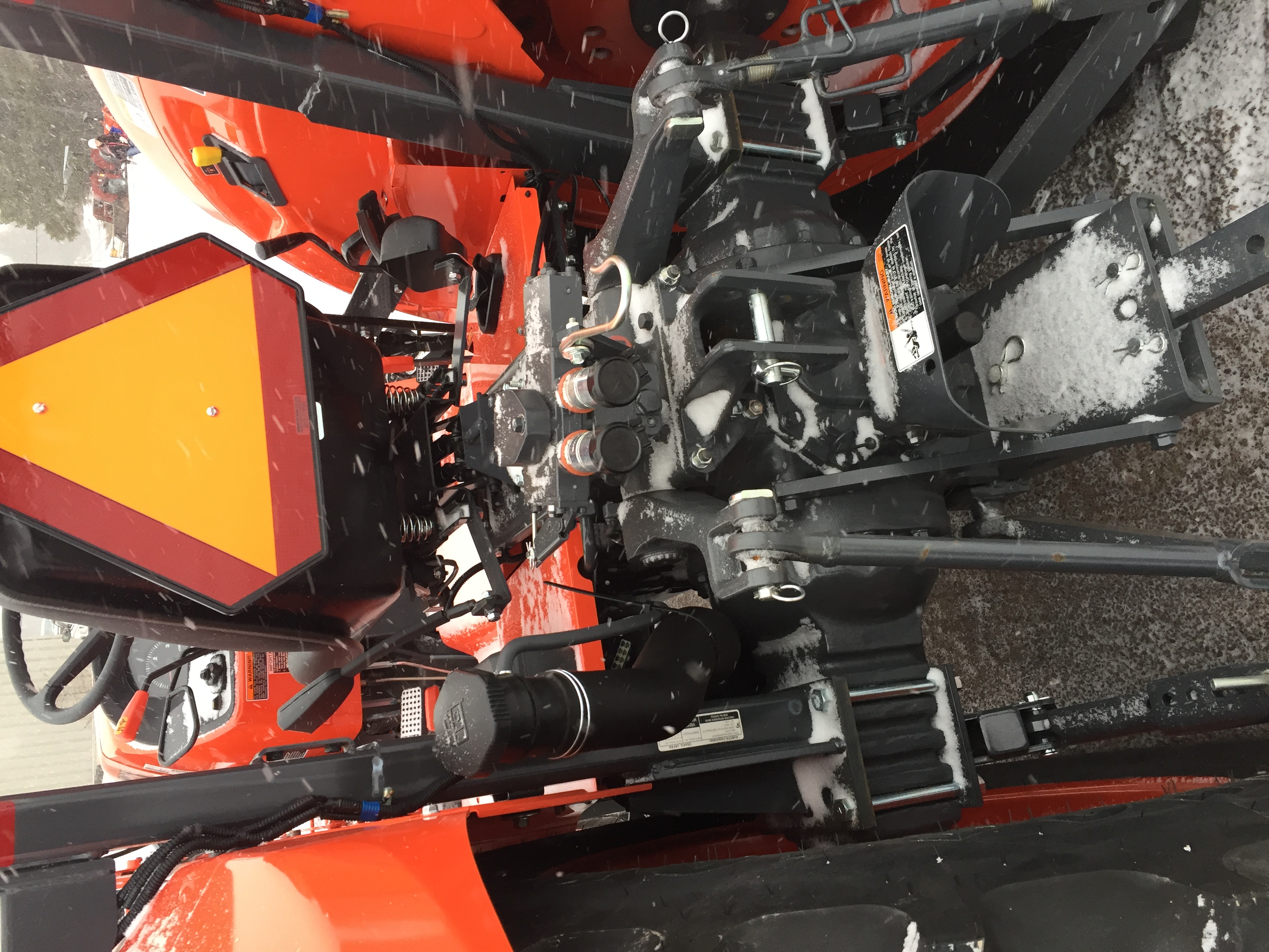

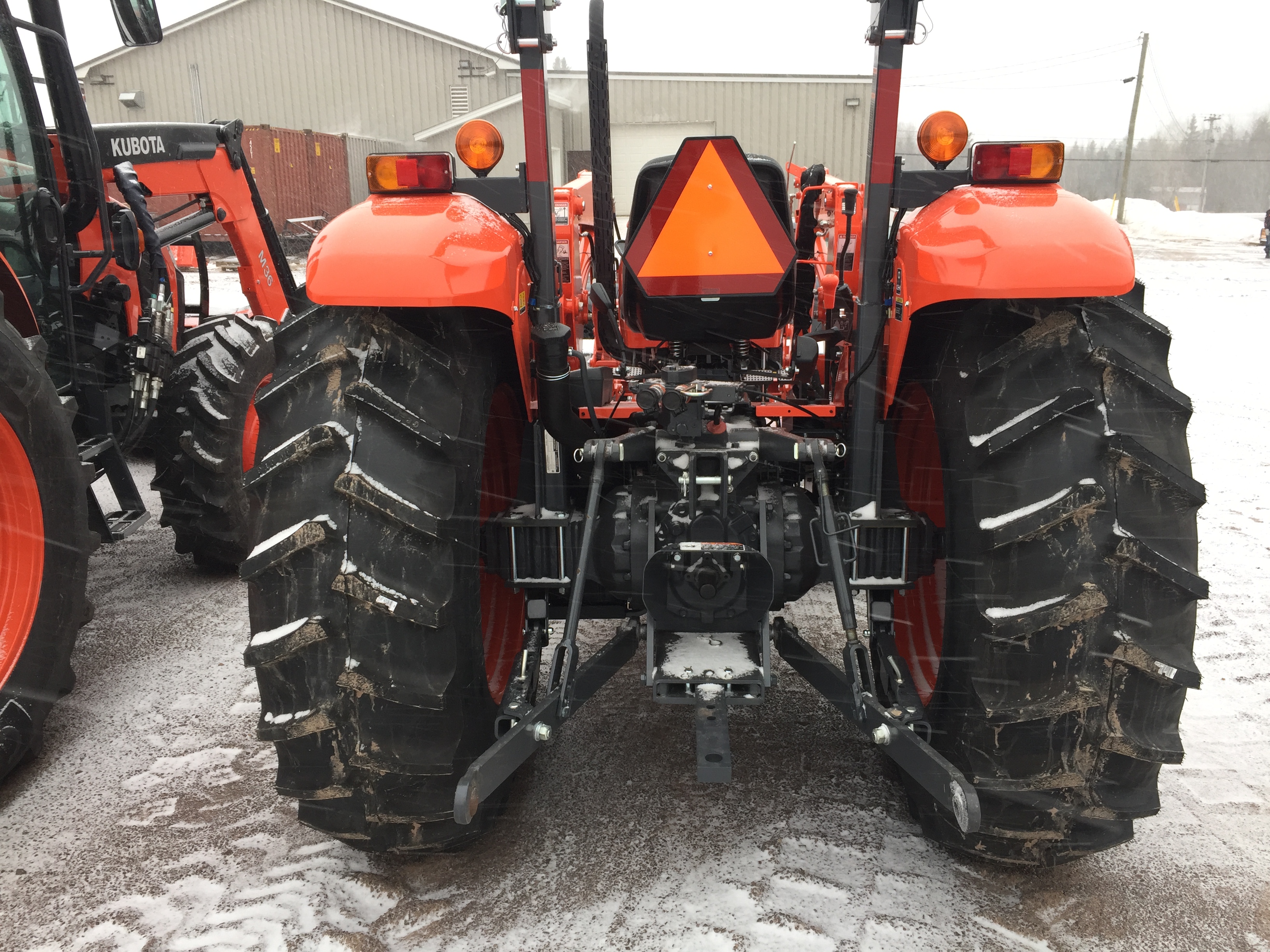

Hi Everyone,
New member here...I have the opportunity to buy a new dealer left over M7040SUHD. Dealer is about 2km (1mile) away, on 2 quotes, they have the best price.
I am just starting out into the farming/homesteading world plan to use the tractor for 10-20 acres of field work wheat and hay, for maintaining a number of vegetable gardens and a myriad of other things like logging, snowplowing, landscaping etc..
The reason for going to the 70HP is for the tax exemption (no tax for 60HP and up at the PTO), why not get the larger sized tractor for the incremental extra cost.
Been having a little difficulty finding any specific info on this model tractor (lots of comments on the standard model 7040) is there anyone out there that can give some insight into this machine pros/cons, likes /dislikes, experiences.
Is this tractor going to withstand the test of time in the 3 point hitch, controls, etc..
Any help is much appreciated.
Thanks
Mitch
