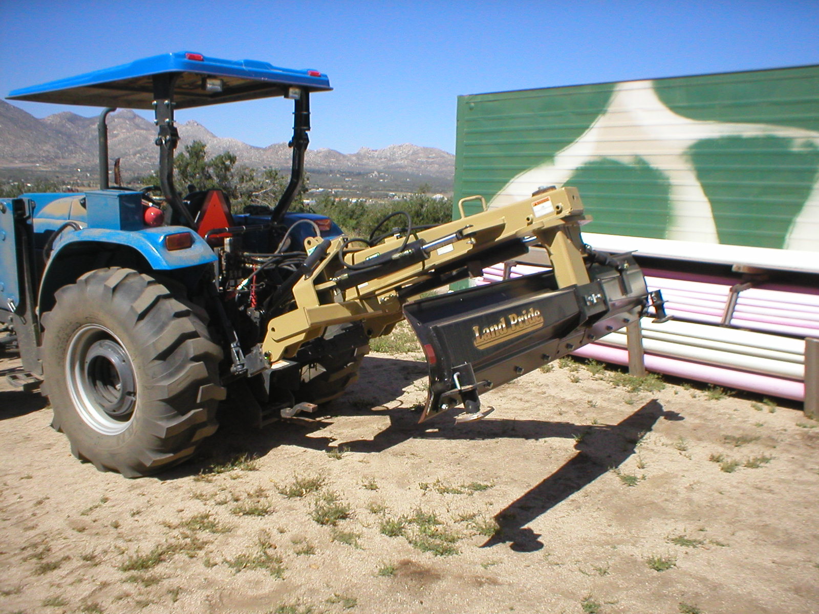

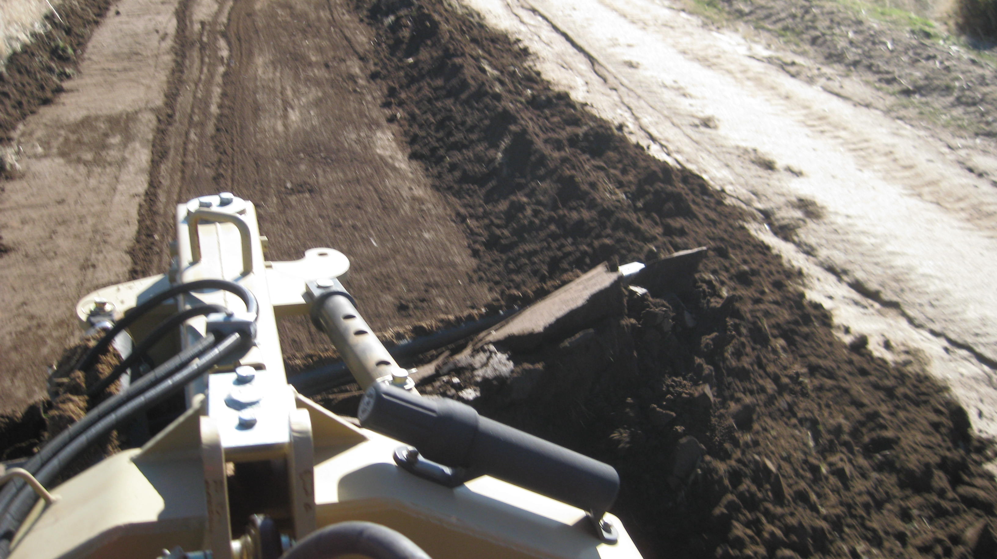

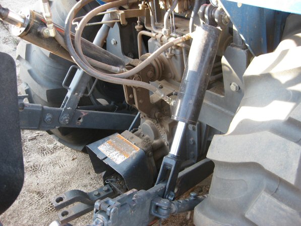

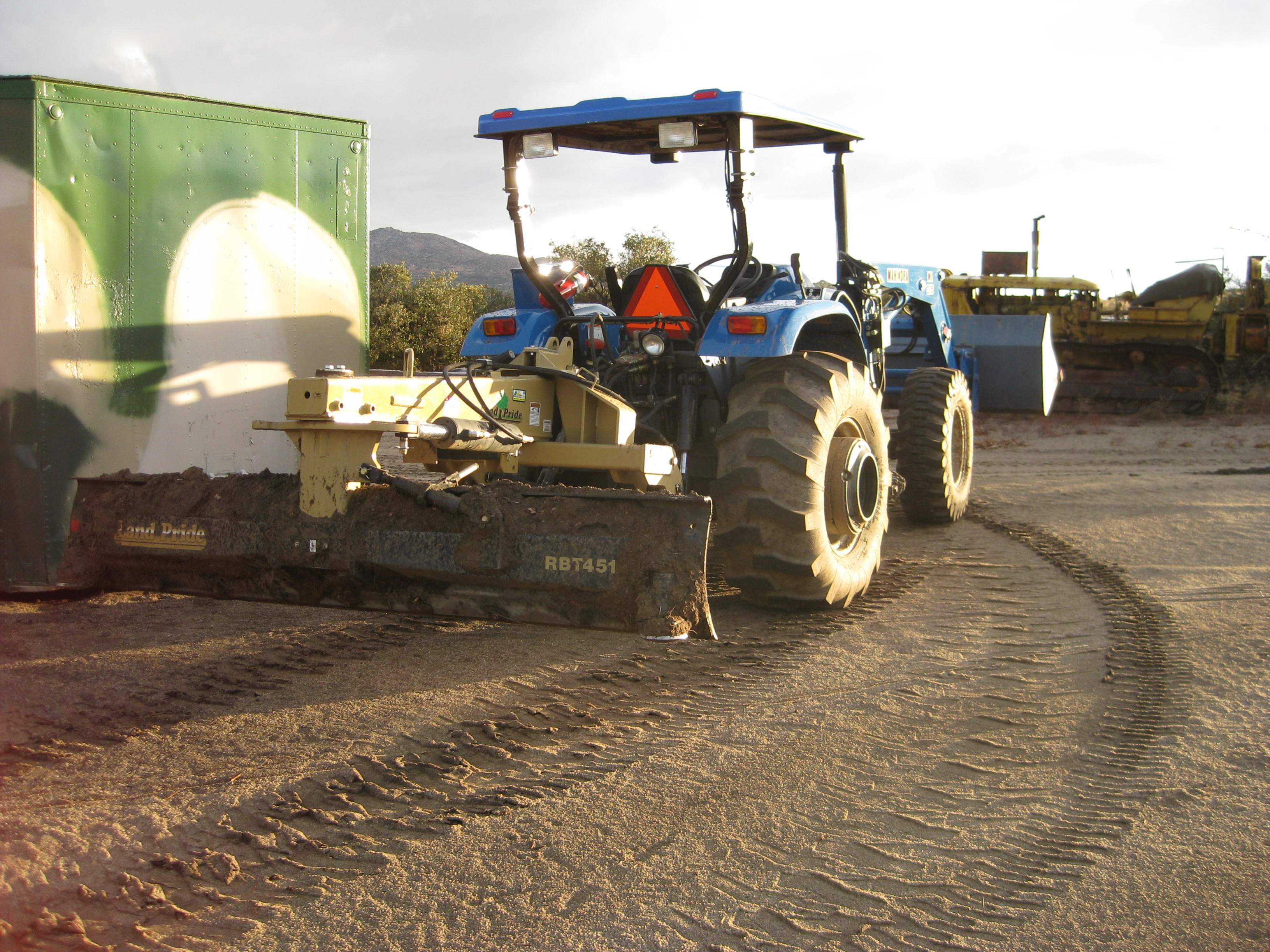

Top & tilt hydraulics for the 3pt hitch (2). Any 3pt implements that might have a or some hydraulics on them. Trust me, as we get older it's not so much fun stopping, getting off of the tractor and making manual adjustments. If you are going to have any trails or roads on your property, then you will be doing some grading of some sort. When you are grading, top & tilt cylinders on the 3pt are worth every penny. ;)
