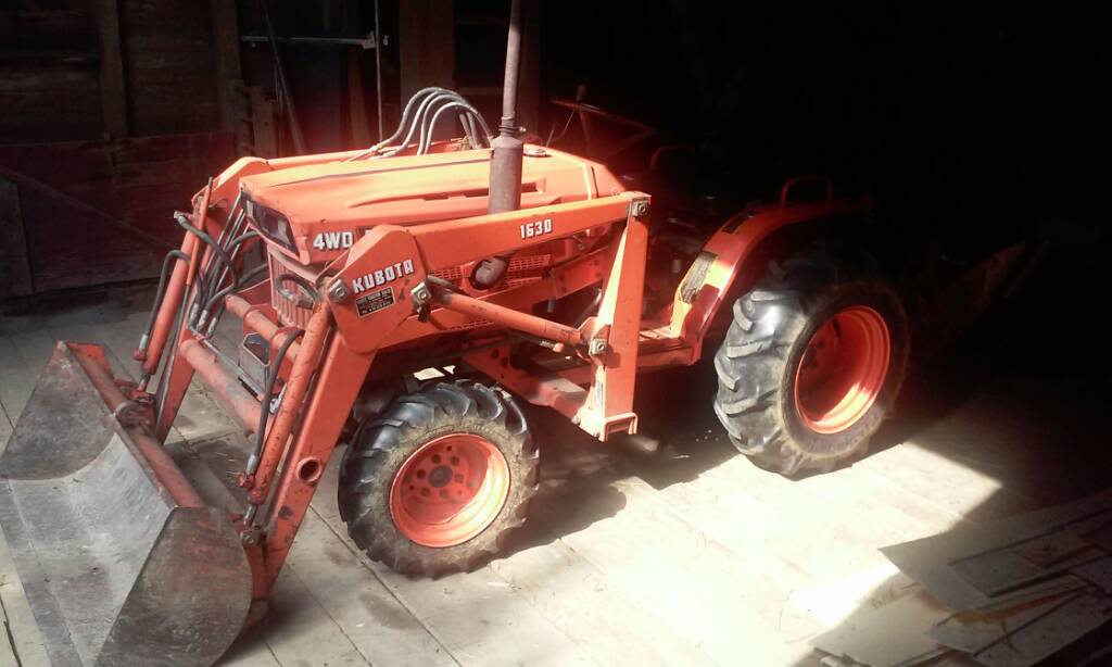

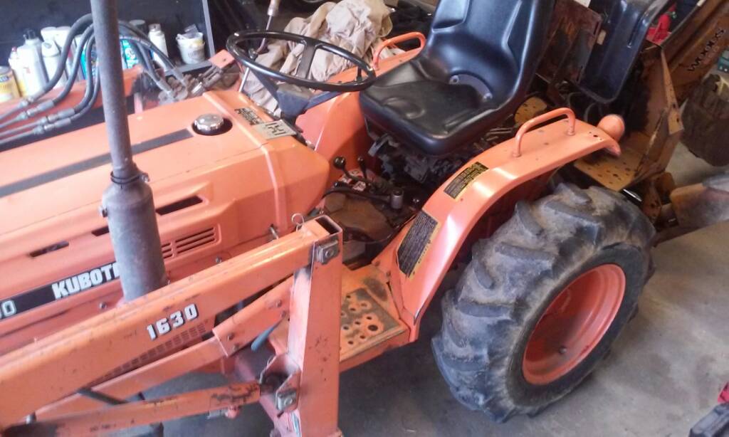

I just bought my first "real" tractor today. uploadfromtaptalk1470445134971.jpguploadfromtaptalk1470445147362.jpguploadfromtaptalk1470445158191.jpguploadfromtaptalk1470445169363.jpg It has a 1630 fel and woods 650 backhoe. Going to change the oil and give it a good greasing. The backhoe does have a slow leak somewhere that i will have to sort out. Previous owner said he always juat kept it topped off as to not ruin the PTO pump.
Are there any other items I should be looking for before I start playing with my new toy? Excited to use it!

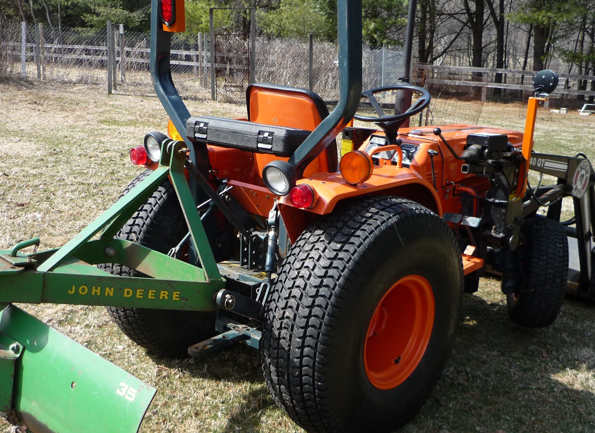

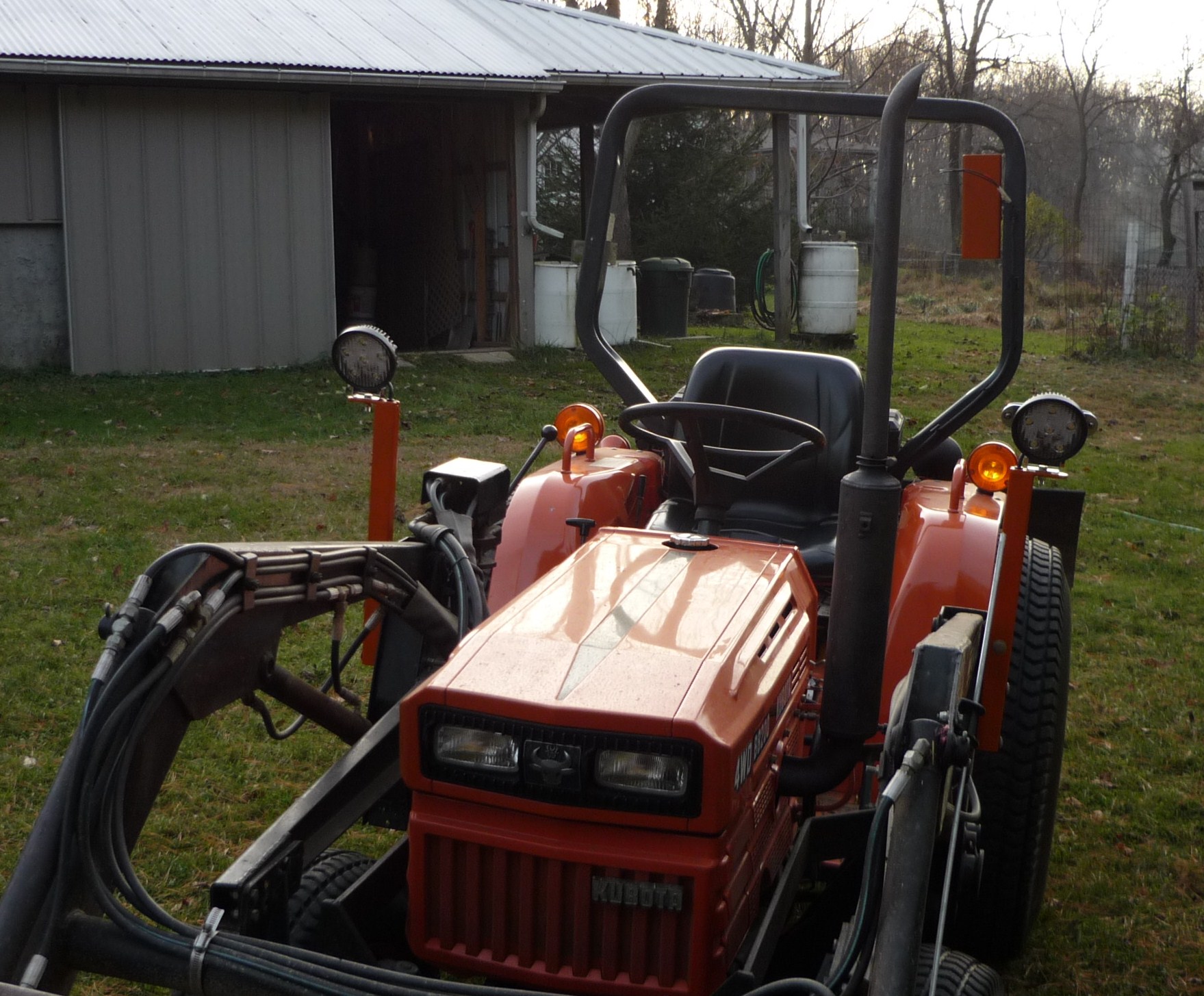

Ah- our first tractor was a B8200... the slightly bigger brother to yours. You might want to change all the fluids while you are at it, and be sure to check the fuel and air filters. Those were the tractors that helped build Kubota's good reputation. As you can see, ours was a barn-kept beauty, with low hours, and I had fun modifying it while I learned about using it.

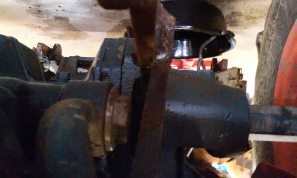

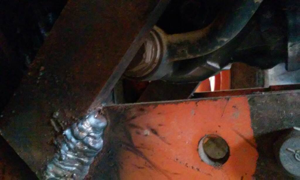

Ok new problem. Went to change the trans/hydraulic fluid and found this:uploadfromtaptalk1471194967181.jpg
Strainer is being blocked by a piece of 3/8" bar that the previous owner had welded in to prevent cracking of the trans case I'm assuming. Also tells me that it hasn't been drained in quite some time. After running it the fluid was a little low and looked a bit milky. After sitting for about a week the color looks normal and has come up on the dipstick so i am assuming the water has separated to the bottom for now.
Either way now it looks like i have some careful cutting to do so i can remove the strainer
