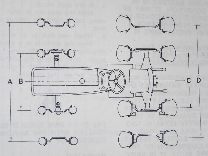

1 - My hour meter on the tractor is sitting at a genuinely unbelievable "2.7" - but there is noticeable wear on pedals and so forth. I assume I can use the hour meter for my own purposes (maintenance timing, etc.) but that it's almost certain the meter has been tampered with, correct?
2 - Is it possible to adjust tire spacing (width) on the 1610 to acheive maximum stability? If so, how is this best accomplished?
3 - What about weights? Seems like more weight up front to counterbalance the bush hog would be a good thing - is it? If so, should I add something to the front "bumper" (seems to be designed for a bolt-on weight of some sort) or just put a couple of 80 lb. sacks of concrete in the loader when I'm running the mower?

I went to a Kubota store up the street and bought 2 60 pound weights which hang on the front loop bar. Then you bolt them together. It really helped to keep the front down even with a rear blade on going uphill. I just bought a FEL and was planning on removing them because with the FEL on, that is another 500+ pounds on the front. Guess I'll findout soon.

Welcome aboard............your FEL should be more than adequate to keep the front end feelin really good......even on the hills.........I have tried mine with and without and the FEL really makes a difference........even when I put on 150 lbs of weight it doesnt hold a candle to having the FEL on........YESSSSSSSSSSS you need a ROPS and seatbelts.........If I didnt have mine I dont think I would use the seatbelts that I installed.......MAYBE I could jump to clear......up in the safety forum there is a lot of discussion in various threads on this subject........anyway.....good luck.....dennis

I have a TS1610, two wheel drive.
I assume the hour meter is set to zero when the tractor is reconditioned. However this reconditioning could be anything from adding a few hoses and paint to some rebuild in Asia.
I swapped the back tires from side to side to increase the spacing. Don’t flip the back wheels on the same side if the tires are directional.
I have a 4 foot rotary cutter, I don’t have an FEL. The front the wheels where not lifting, perhaps because I operate the cutter with the trailing wheel on the ground. In some cases the tractor does not corner well. It pushes in straight. I added 4 x 45 lb weights to font bumper, hoping this would help the front wheels to bite harder. I also spend a great deal of time using the diff lock to get traction on hills. That increases the tendency of the straight line pushing.
Consider using an over running coupler on the PTO with the rotary cutter on the TS1610. Otherwise the momentum of the cutter will push the tractor. The TS1610 does not have an independent PTO.

I hope the picture helps with making the wheelbase wider.
Regards
