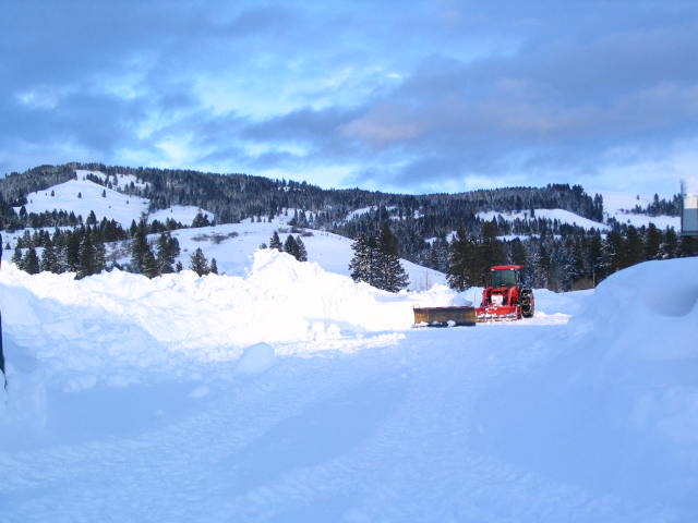

As I mentioned, if I were performing ground engagement ag duties, then that changes the paradigm and I would defer to a power shuttle geared system.
One of the issues in play here is something that I tried to reference in my first post. I have spent time in PA (Poconos), the middle Atlantic (southern New Jersey) region, and Arkansas (Mountain Home) and the snow conditions there are what I would describe as light to maybe bordering on moderate in the Poconos.
My frame of reference is different. Our average here is around 200 inches (at the lower elevations) starting late November until mid-March- early April. In the higher elevations, there will still be several feet left until late July, early August.
A foot of snow is something of a distraction that occurs during the breakfast hour; 6 inches is something you kick out of the way.
