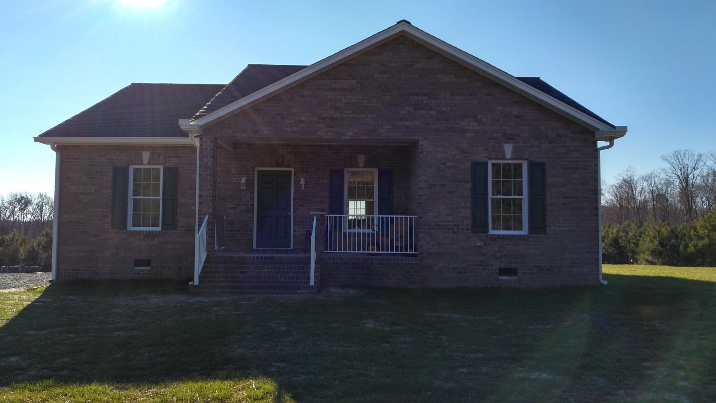

So, I love my new house. I finally have a master bath. Woo Hoo!. I know that no house is perfect and you can't catch every scenario. Having said that, here is a list of things I would do differently if doing it again.
  1. Next house will be 2 1/2 bath. I kind of let my builder talk me out of this. Had some family get togethers and definitely wish I had the 1/2 bath. I know I saved a little on the cost but if I ever do it again this is going to be a must have.
  2. I kept my house at a certain square footage based on dollar per square foot. I was worried to death about my appraisal. This caused me to have the architect draw a 2 foot bump out for the bathroom on one side of the house where the kids rooms are. I should of sucked up the 5 to 8 grand it would have cost to push the whole house out 2 feet and been done. (This is probably the biggest thing that bothers me about the house and my decision on the size).
  3. I did not put a garage in. Again, I was worried to death about the price of everything. Next time, if we do it again, I will HAVE a garage done with the house. This is the one extra I wanted and needed and still did do not have. Who knows when I will ever build one. Almost everyone I know that did not do the garage initially, still have no garage. I am currently building a shed, have a shipping container and will build a pole barn but I wish I would have done a garage.
  4. My kitchen could be bigger and I would have liked to have had more counter space. I do have a plan moving forward to add some more space to this.
  5. I wish we would have put an extra room, for an office/spare room, etc.
Here is a list of items I did right and happy with:
  1. Had the entire house bricked. Back deck, front porch all concrete and brick. Every time I come home I smile about the brick. Probably THE best thing I did on the build.
  2. 9 foot ceilings - I know this is an extra and not needed but I really like the tall ceiling height.

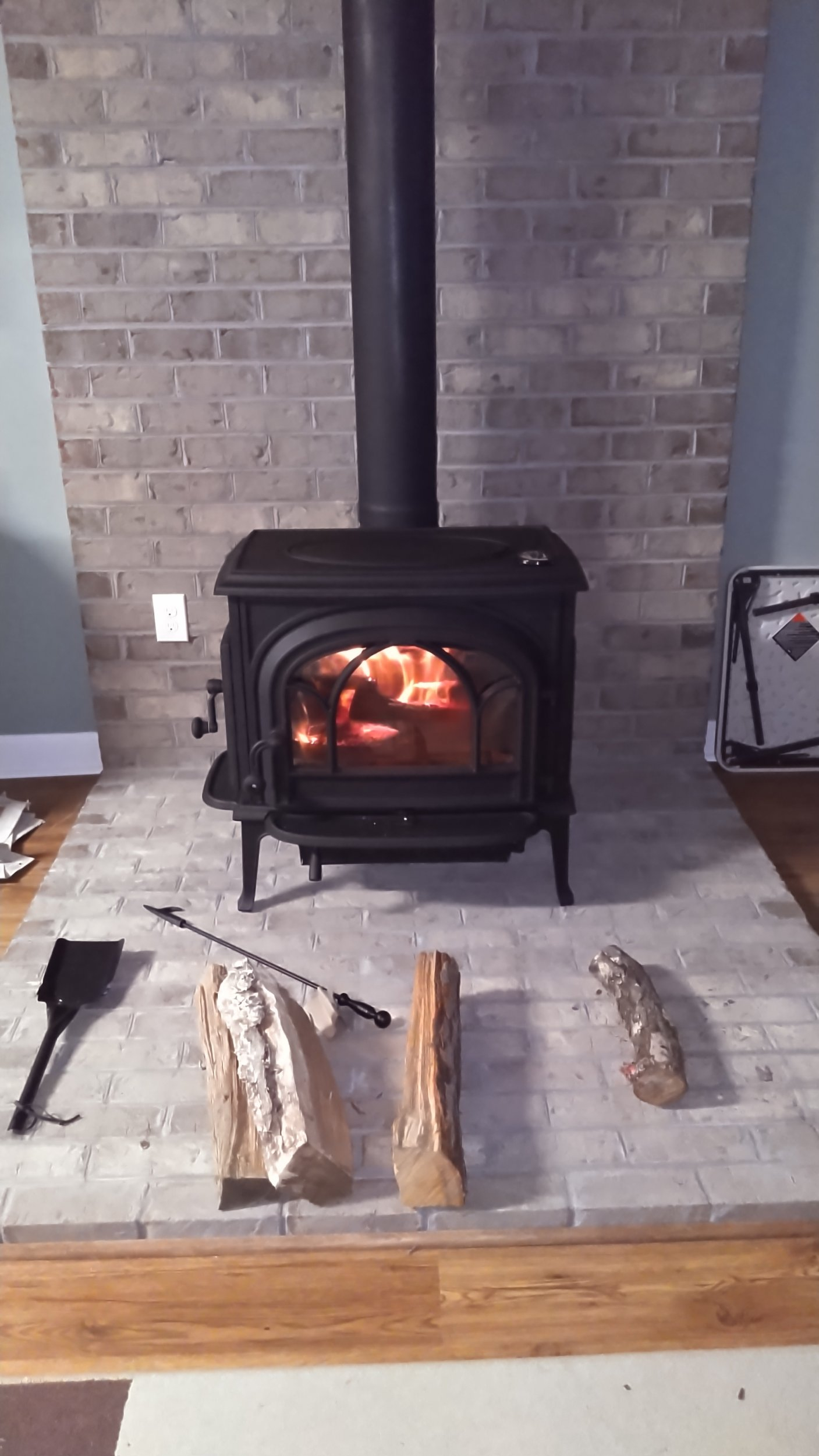

  3. House was designed around the wood stove. My house is like a square and I put the wood stove right smack dab in the middle. House holds heat great in winter and makes you walk around in your underwear.
  4. Bathrooms are huge. You can lay down in them. Love it!!!
  5. Me and the wife never needed 2 sinks, so we added more closet space in the bathroom. We have a closet and shelving in the master bath and Love it!!!
  6. 3 ft wide doors through out.
  7. We sacrificed a dinning room for a mud room/laundry room. This was a great decision. We are out door people and have lots of nasty shoes/clothes/jackets and other junk filling up these spaces. Really glad we did this.
  8. Utility sink in the laundry room. A must have!!!
Overall, I am very happy with the house. It is comfortable and cozy. It is easy on the light bill and is home. Just thought I would share for those going down this adventure with your own house build. I also highly recommend working with the architect and design that suits you. We really did not think about resale and built with what we wanted.

Congratuons on your beautiful home. We have just moved into a new one as well still lacking a little outside work finishing. I hope your new home serves you well for many years. I designed ours so the undertaker has easy access to roll me out the back door
   / New House Build (What I would do different after a year of living in it) #3
With your style would the garage be matching in a carriage house design?
I like brick but extremely rare in earthquake country.
A small extra room is always a bonus... call it office, sewing, etc...
Sounds like you did well.

The brick looks great! and no more worries about painting.
I know some folks are very hesitant to post interior pics of their houses, yet it would be fun to see how you used the spaces. How are you using the space above the front porch? Is this a loft or an unfinished attic?
