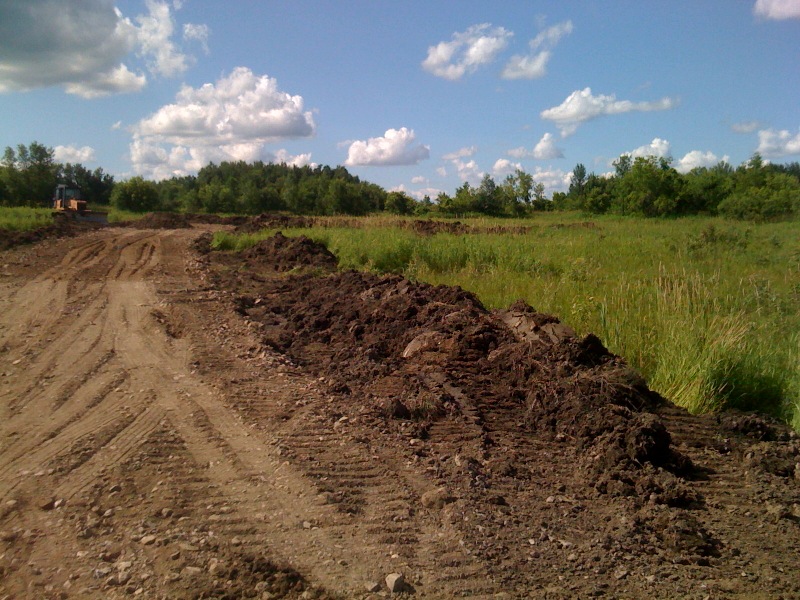

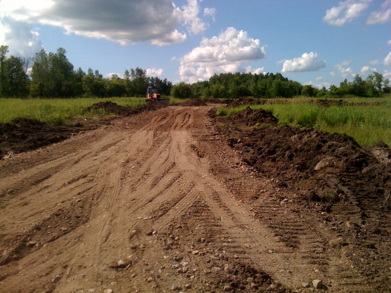

I am starting to build a new house and garage on a 250 acre lot i own. It is in Avonmore ontario. The house is a Viceroy home Custom Country Homes by Viceroy Homes - Custom Country Home Builders located in North America offering Custom Country Home Design, Prefabricated, Architectural Post and Beam, Viceroy Homes, Custom Home Solutions, custom homes, custom home, custom cou it is the invermere mkv . I will doing it with a walkout basement, anyone have any suggestions or tips on doing this type of foundation ? the house is a little over 2000 sq ft, and the garage will be 32x52 with a 12ft wall and scissor trusses. i added 2 pictues of were the house will be going. the house will be to the left of driveway and the garage to the right.

Hi,
Have you considered ICF for the foundation ? Considering the locale of the build, it might be something you want to look at.

I'll second the ICF idea. And make sure you avail yourself of all the great products and techniques for keeping water out. There's almost no good excuse for a wet basement this day and age, unless you dig below the water table. We're planning a walk-out basement (and ICF) for our build as well. It's nice to have windows and doors on at least one basement wall.

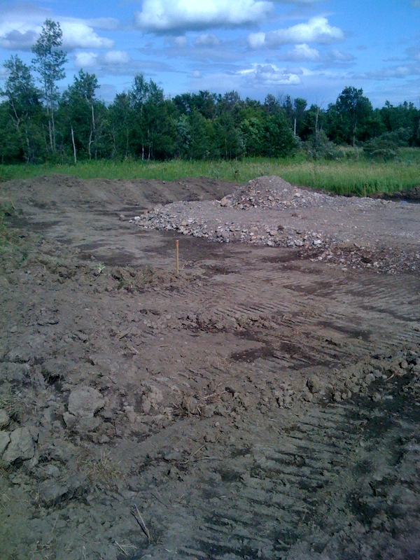

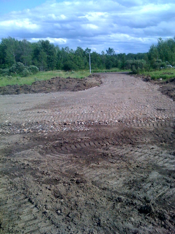

I will be spending some time this weekend finishing the driveway and raised area for the garage to sit, and if time permits i will be plowing and discking the area behind the house/garage because it is so uneven/overgrown with weeds.Because i'm going with a walkout basement and i dont have much natural slope in the rear i will have to sit the foundation fairly shallow and fill the front up. Seems like best solution is to dig a pond for the fill. The pond will go in the south east corner of the property roughly 900 yrds from the house. not sure how big to go. I will post more pictures monday to show the progress. any comments suggestions are much appreciated.
   / new house and garage build
here's a few pictures of what got done over the weekend, got the driveway finished and about half of the fill for the garage area. alson plowed area behind house/garage but forgot to take a picture one is looking down the driveway south and other is of area for the garage
