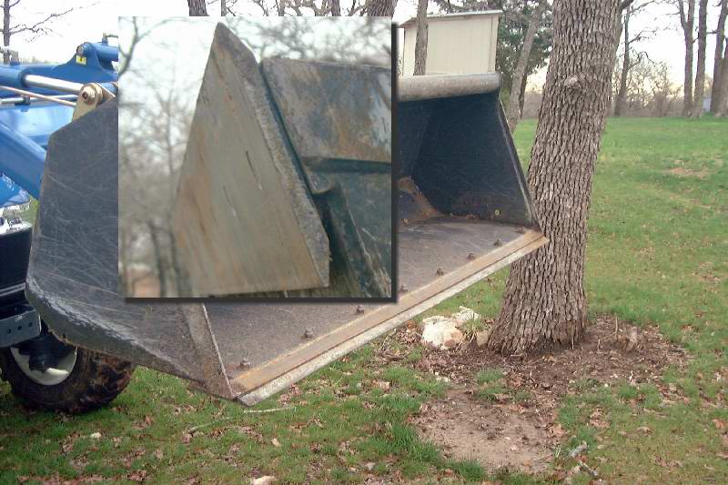

This part # (86599708DS ) ,came from Messicks web site, desicription states that it is a HD Toothbar 72" with 7 teeth , to be installed over the Factory Bolt on cutting edge.
Question is, is it simliar to Markham's , Slips over the cutting edge's and a Bolt through each side of the Bucket?
Or
Does it Bolt onto the bucket, using longer bolts and the same holes that the Bolt On Cutting edge uses?

I'm no dealer, but the toothbar bolts to the sides of the bucket and the cutting edge bolts to the bucket's lip. If the toothbar is cut properly, it will fit like a glove over the cutting edge or be a little loose if no cutting edge is installed. Some have elongated holes to the sides of the bucket, but I don't remember that being the case with my toothbar. Mine is made for no bolt on cutting edge.
/ New Holland ToothBar #3
The toothbar bolts to the sides, the cutting edge to the front. I can't recall seeing a toothbar though our shop that is not done this way... except for bolt on teeth that are not on a bar.

Just as Jim said, the holes in the front bottom edge of the bucket are for the reversible, replaceable cutting edge. The holes on each side plate of the bucket (total of 2) hold the tooth-bar in place. The tooth-bar locks over the lower edge of the bucket and as such adds strength to it.

Here's a picture that's worth a thousand words...:)
There is a bolt-on cutting edge (cutter bar) that bolts to the bucket edge and is reversible.

Ah Hah! So that's a wear item then, like the lower edge of my back blade. Does it make much difference in how the bucket works in dirt? It doesn't look like it would, but I can see why a guy working a lot of rocky ground or gravel would want to have one on there to save the bucket edge from wear.
/ New Holland ToothBar #10
I had the cutting edge for about 3 years prior to buying a toothbar. There was just slight wear on it's corner edges during that time. The thing I gained most with the cutting edge is that it doubles the strength of the bucket's edge and when it wears, it is easy to reverse or remove to put a new edge onto. For really heavy duty work, I think the bolt-on edge will prolong the bucket life far beyond not having one. However, I don't have any of that long term experience, so this theory is a presumption on my part.
