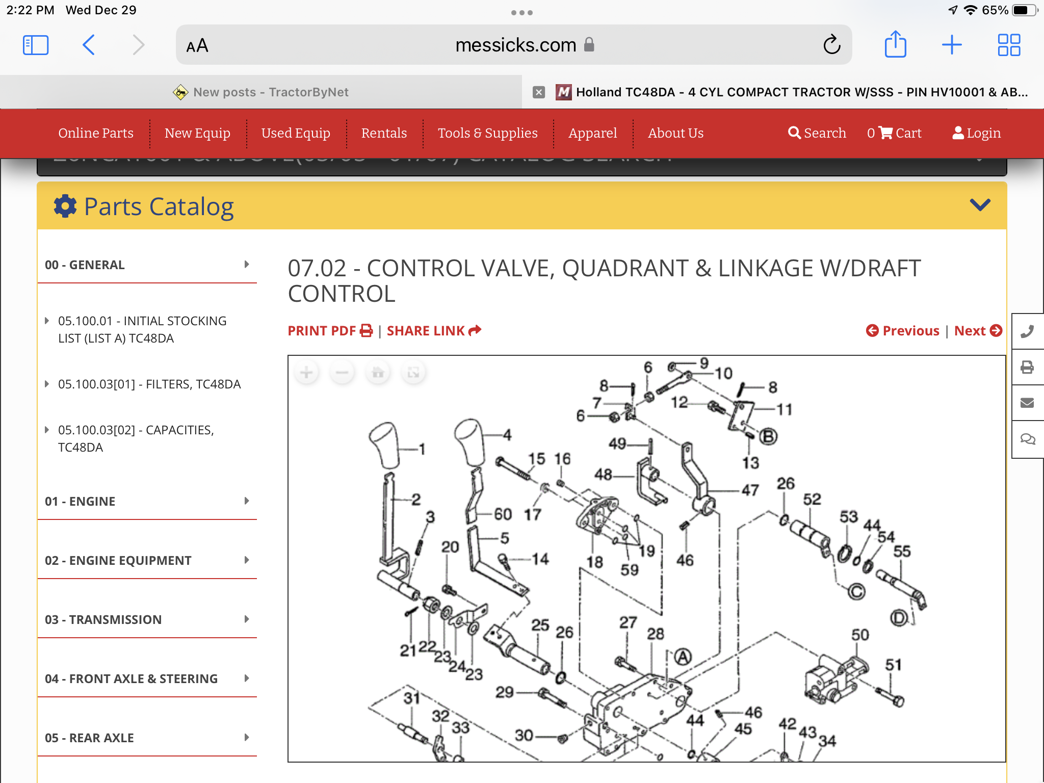

I am hooking up a Lane Shark mower on a New Holland TC48DA with FEL.
I am going to run the Lane Shark from the rear remotes, but need options on where to hook in the return line.
Thanks in advance !
   / New Holland TC48DA return line options #2
Item 16 is a 3/8" pipe plug that can be removed. You can use a street ell, nipple and either a 3/8" quick coupler or a reducing bushing and a 1/2" quick coupler to connect your return line. This location is used for OEM backhoe installs among other zero pressure return needs.
