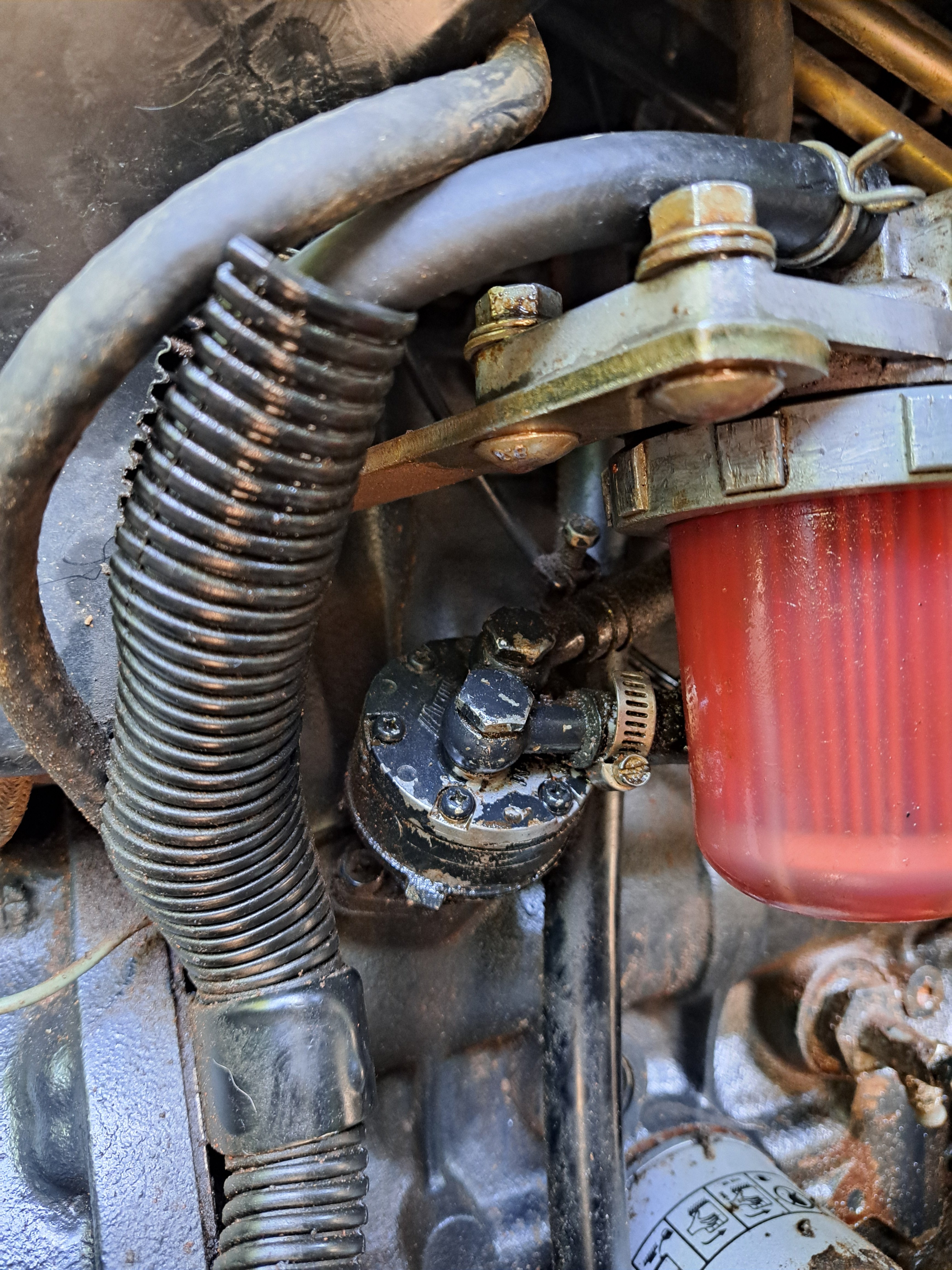

I know this is an old thread but, I am having fuel issues too. I have checked the system to the outlet that supplies injectors from the ( I assume) the fuel pump. Can anyone tell me how much fuel should be coming out here? It has some fuel flow but not much. Is the pump a bolt off bolt on kind of job? Any help appreciated.

So far I have blown all the lines out. Removed the tank (a few weeks back) Ran fine after. New filter. Getting fuel in and out of the bowl. Solenoid appears to work okay. I am not sure what the fuel outlet hooks to before it goes to injector pump. I thought it was a fuel lift pump but can't find any that look like it.
To be clear I know nothing about diesel. I am not afraid to get my hands dirty but I am afraid of doing more harm then good!
I should add. 2003 TC45D 4 cyl

Can someone please tell me what this is?

If that is based on the LS R series, the following links may help
Web Parts Catalog
The diagram looks like the filter feeds the injection pump with no pre feed. You may want to see if the screen on the pick-up is clogged if you're getting low flow & filters are clean. Or, since warranty isn't an issue, add an electric fuel pump before or after the filter o boost flow.
