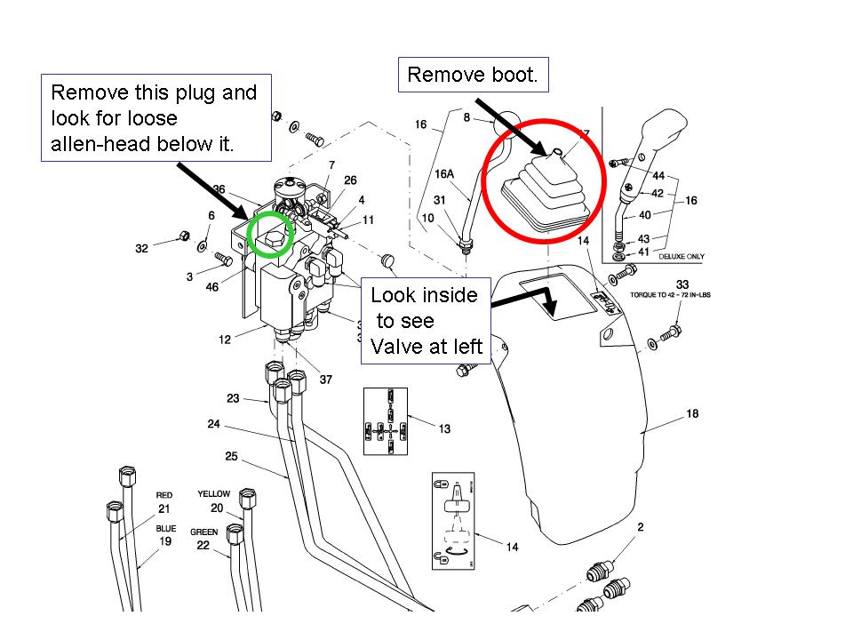

Loaded the tractor no prob went to unload backhoe inop front loader ok changed positions on diverter valve no change no pressure going to rear hydro lines feel no pressure going threw valve when changing positions what next is the diverter valve no good

Did that twice no pressure to the rear hoses front bucket works ok

Do you have remote hydraulics in addition to the backhoe? If you do, check that the lever is not sticking, causing it to not return to center. Your FEL is before the remotes in the open center system, but the 3PH and backhoe are after the remotes I believe.
Also, sometimes the loader valve itself has a power beyond plug that loosens.
Here is a thread that talks about it. I think it would have the same effect on your backhoe. I've attached a diagram that shows where to check for this.

Chances are a plug has come out inside your loader control valve. Underneath one of the outlet fittings (either the PB fitting or the 'OUT' fitting) is an Allen headed plug that keeps the PB flow from comingling with the 'out" or 'Tank' flow. This plug has probably backed out and is allowing PB oilflow to instead go directly back to the reservior.
   / New Holland TC45 backhoe inop #6
RickB and others, the OP told me in a PM that his Allen head plug was the problem and he has his tractor repaired and operating normally.:thumbsup:
