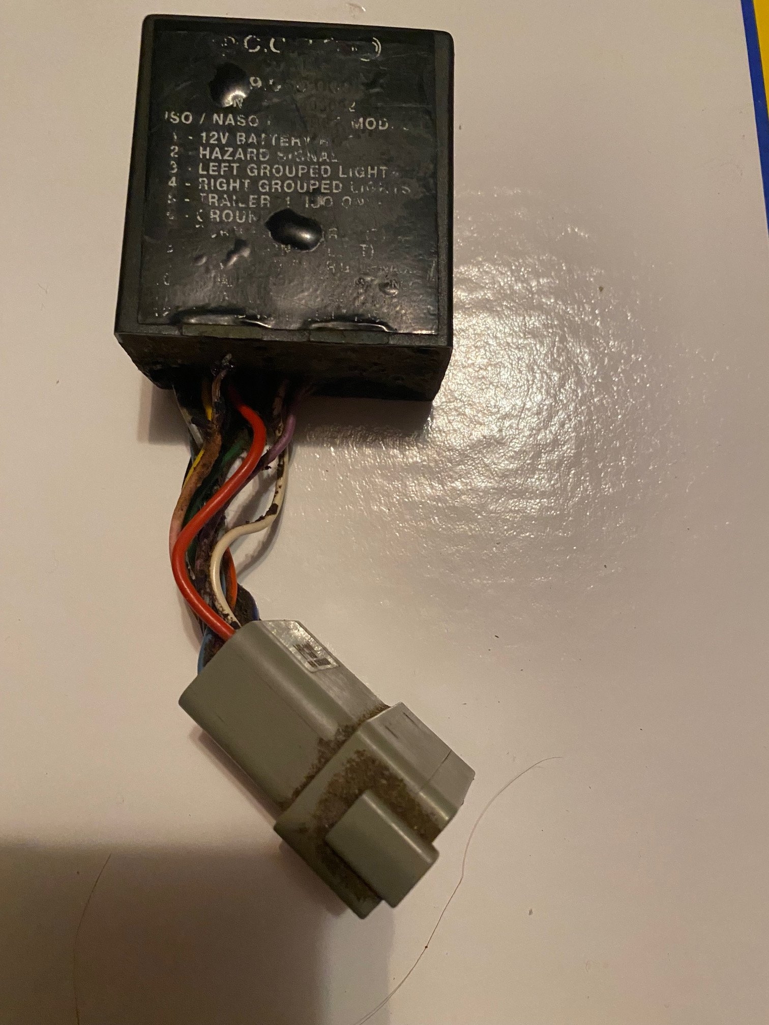

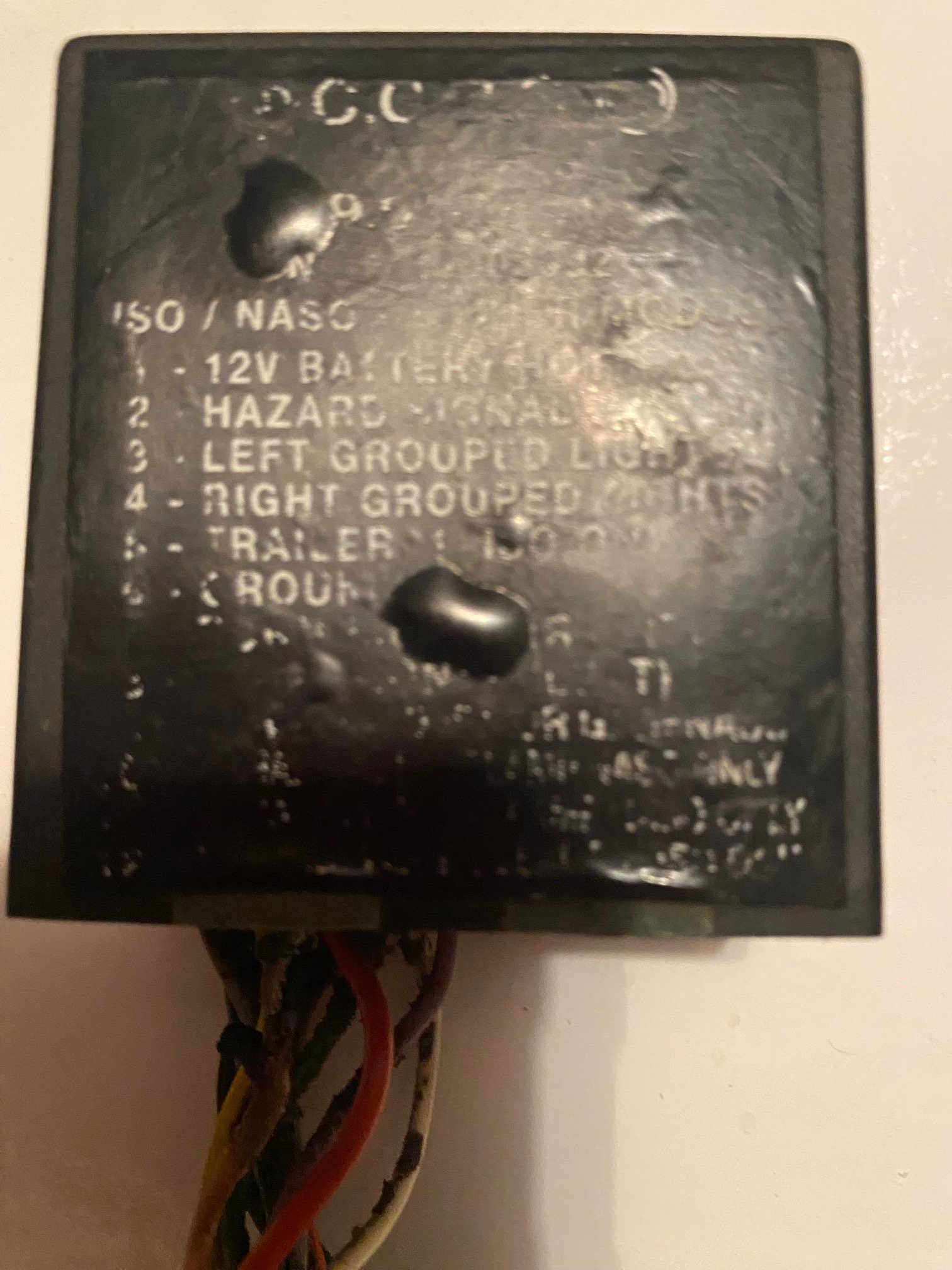

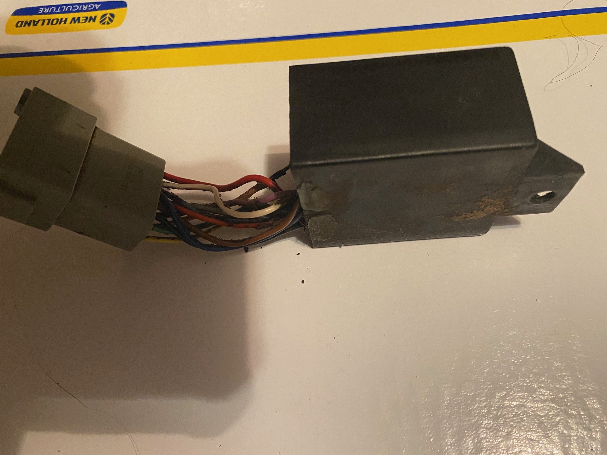

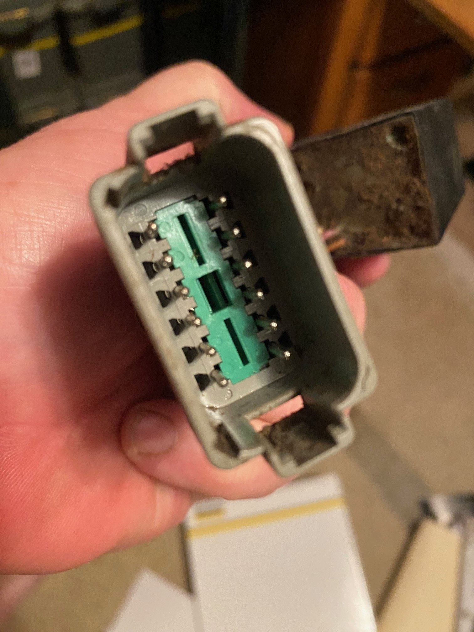

Started my tractor several months ago and smoke started coming out on the driver side dash. I quickly pulled it apart and shut off the tractor to find this smoking. I cannot find anything in parts list that match it and basically lost the lights in back flashers. Its not a big loss but can someone tell me where to get this part or a replacement?

I see $21.57 which is still too much. Go to your local auto parts store and match the plug config up.
   / New Holland TC35S - Flasher unit #4
According to the markings on the unit, it is for the tractor and a trailer. If you just need flashers on your tractor, I would look at a schematic if you have the SM and/or find the circuit for the flashers and install an off the shelf flasher unit from the auto parts store.
where did you find that price
prolly more complicated than I understand
