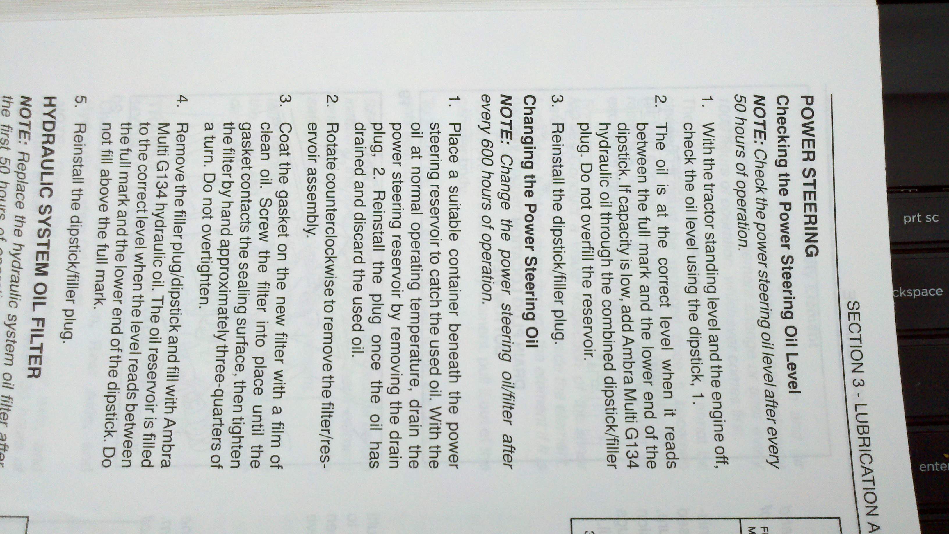

I don't know if your tractor is the same as mine, but the manual states that the power steering fluid should be changed every 50 hour of operation. Mine is a NH TC35A
   / New holland TC29 steering help needed also hour meeter dont work #6
I guess the oldtimers thing is setting in on me. I stated that the manual says to (change the fluid) I stated that wrong. It says to check the fluid after 50 hours and to change the fluid after 600 hours. Sorry I'm getting old in my old age.
