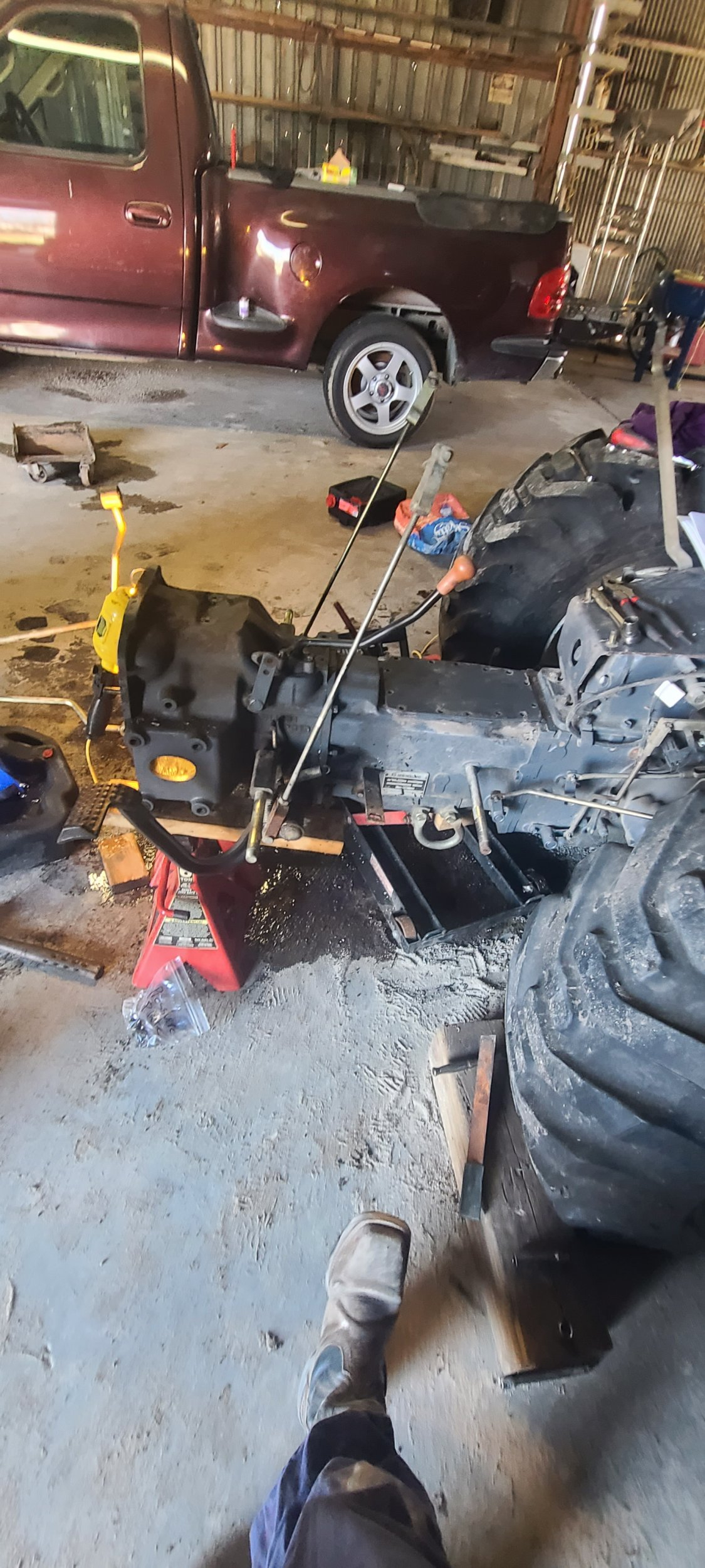

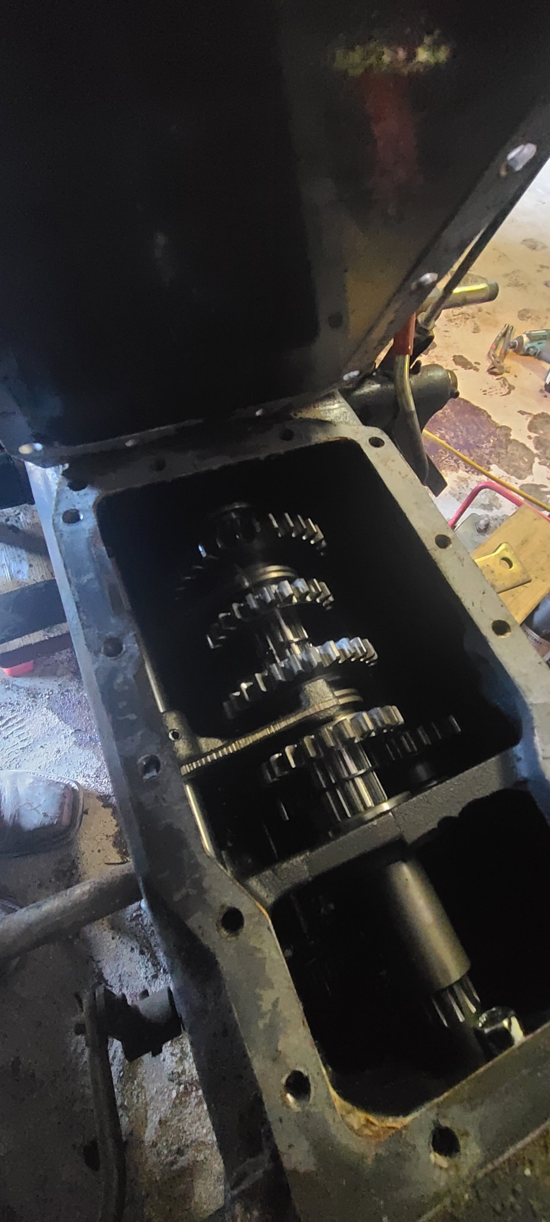

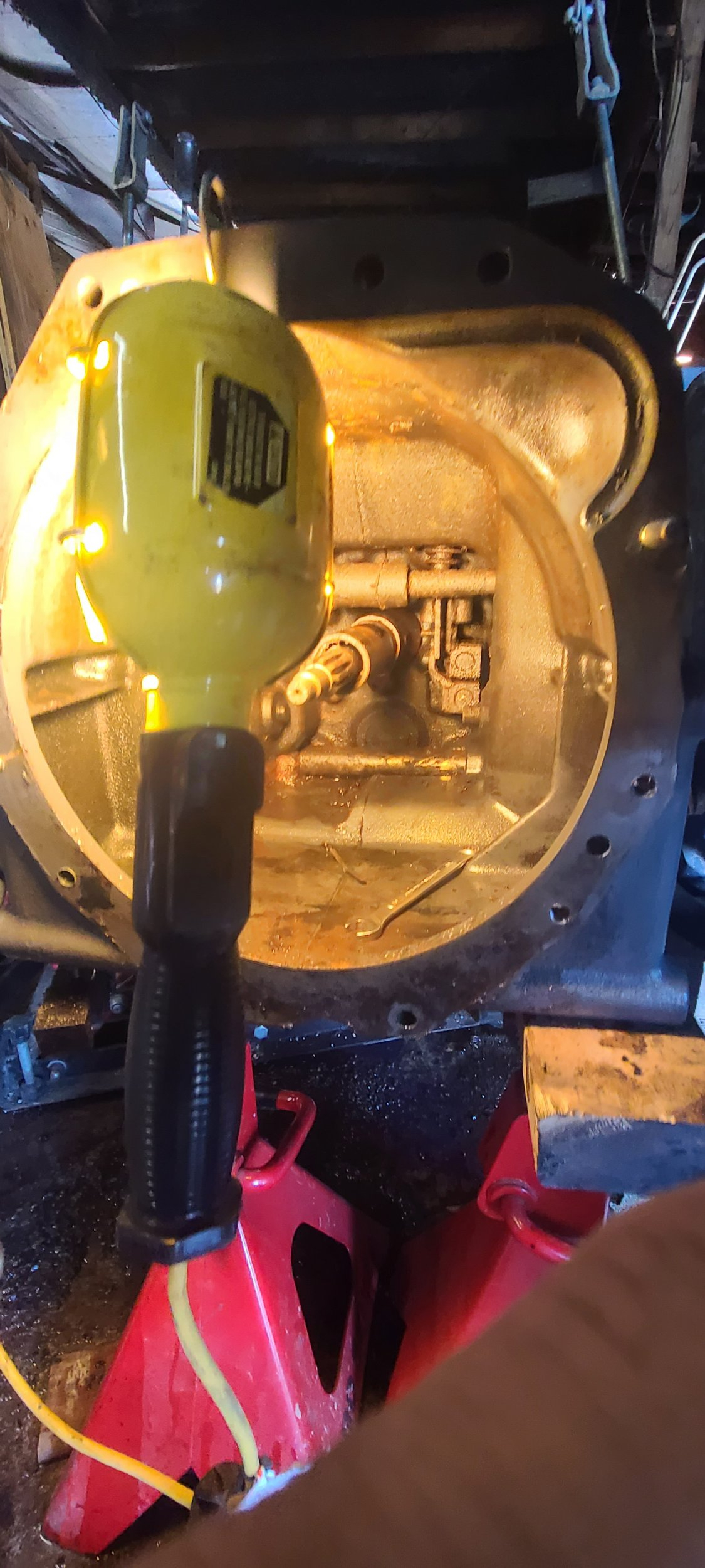

Update, I split it between clutch housing and engine. I still can't see where to split clutch housing from the transmission. The shift rods have bolts that hold them to some pieces for the actual shifter. Even after taking the bolt out of the top one it seems like I would have to get a puller to get it off. Once thats out I can go after the other bolt on the other rod. Seems like it should be easier to access and separate. The repair manual doesn't mention it at all and just says pull it apart.

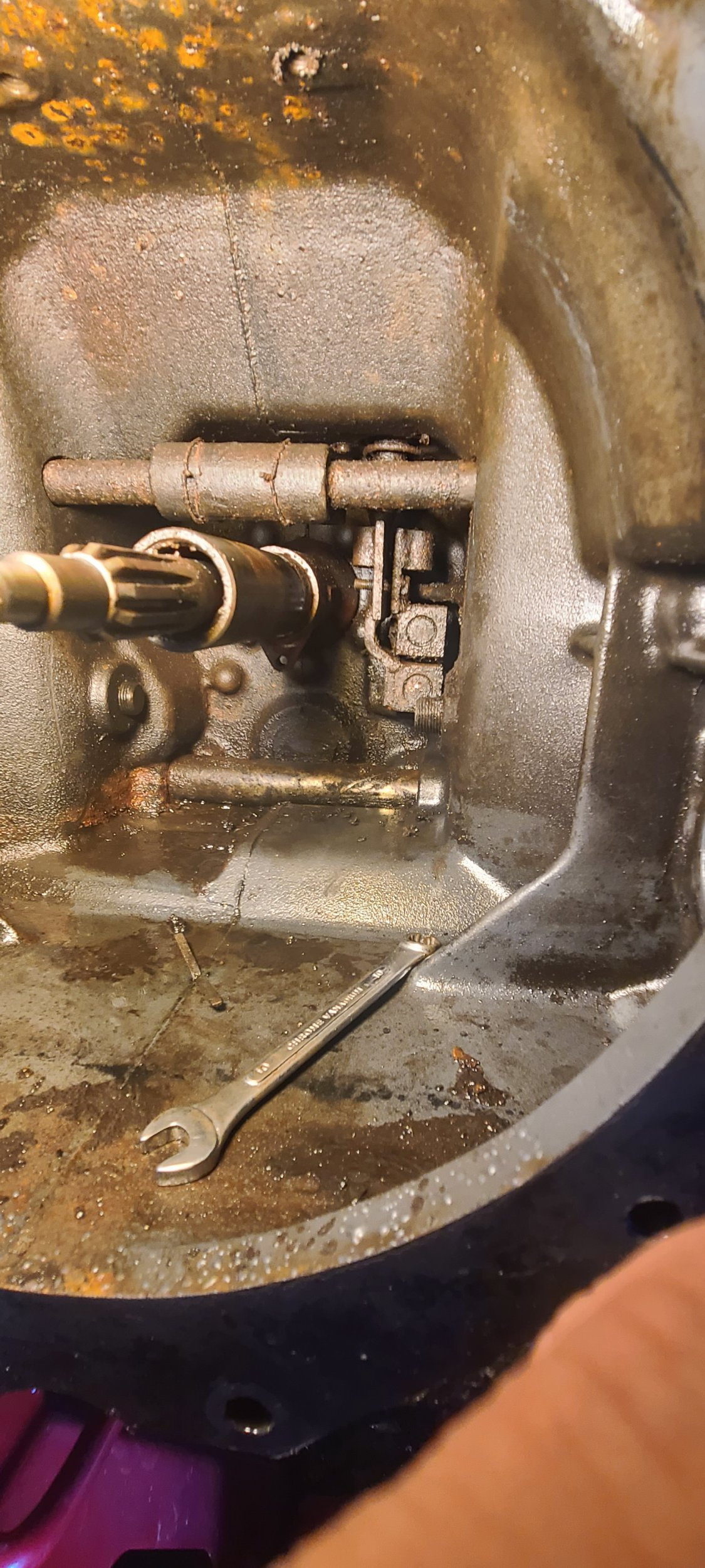

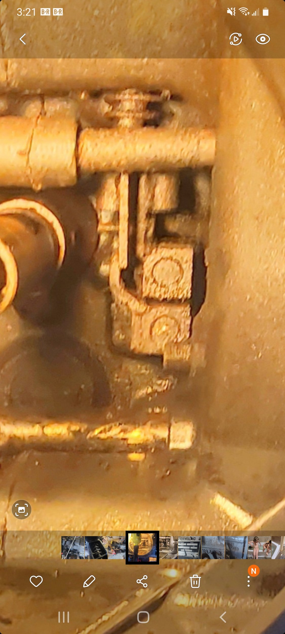

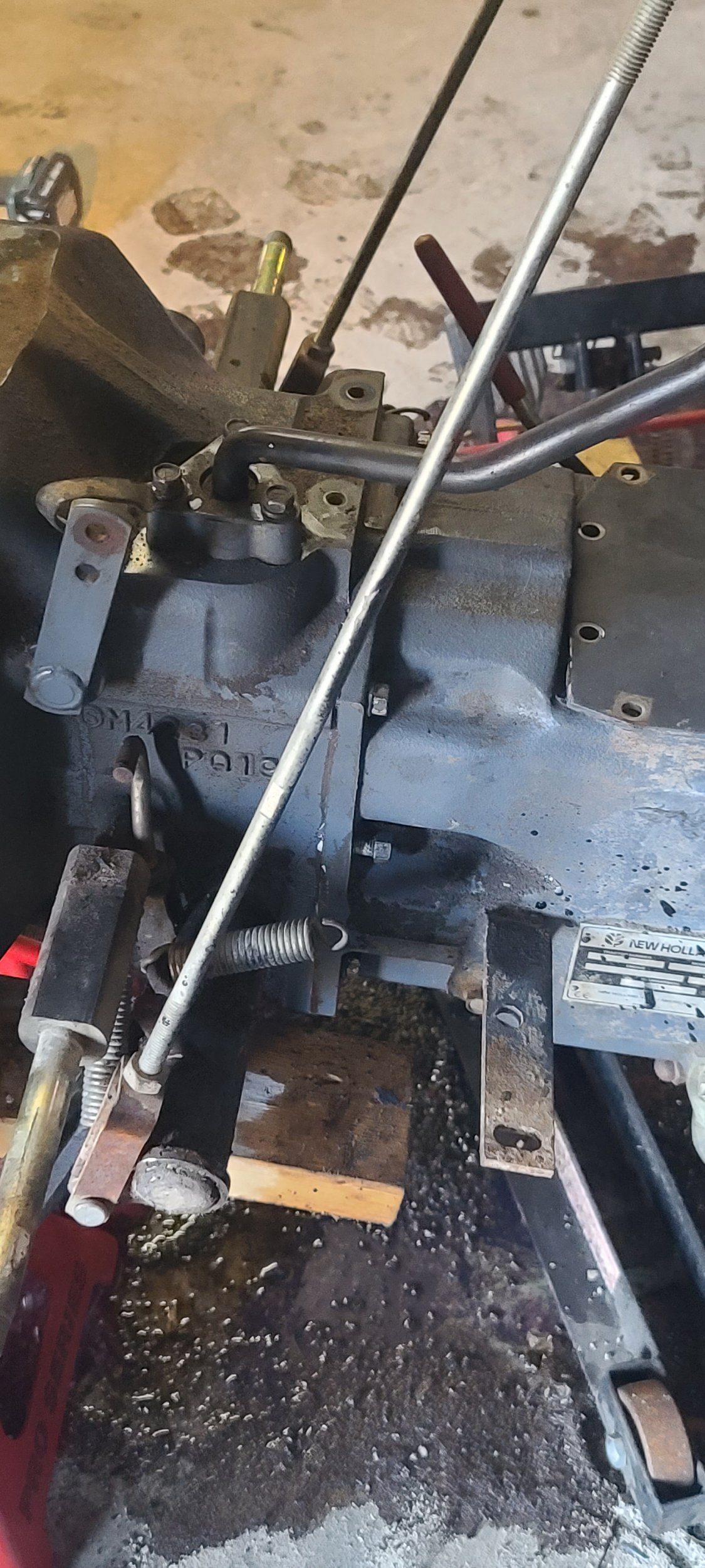

Here is a close up of the 2 rods.

From what I can see from the pics it looks like you do not have fwd on this tractor. It also looks like you may have to remove the bell housing to get at the seals. I had a look at the parts diagram and it looks like there is a gasket accessible from the other side of the bell housing. I will provide you with a link to the website I found. Go to page 4 where it says clutch assembly. There seem to be a number of different arrangements as far as transmission and pto configurations so not sure which one you have. I do not know your model well enough to offer too much assistance unfortunately.
I hope this helps!!

Appreciate the diagrams, the bell housing can only be separated a couple inches and it hits the shift rod keepers, there's a bolt that goes through the shift rod you have to get one off then you get access to the other rod. The bottom pic above shows what I'm talking about it's the square keepers with the circles in them. I've got one bolt out but it doesn't want to come free. Looks like I'll need a pulley to press it out.

I think I know which parts you mean but it is somewhat difficult for me to understand without actually being there. I see a rod going across at the top with a coupler and some wires wrapped around it. Would removing that allow better access to the assembly you are trying to remove?? Personally I wouldn't try forcing anything without knowing for sure that you are not damaging something on the other side of the bell housing. Perhaps a quick call to the dealership might help...??
I am sorry I am not much more help. I understand your frustration!! I've been there too!!!
