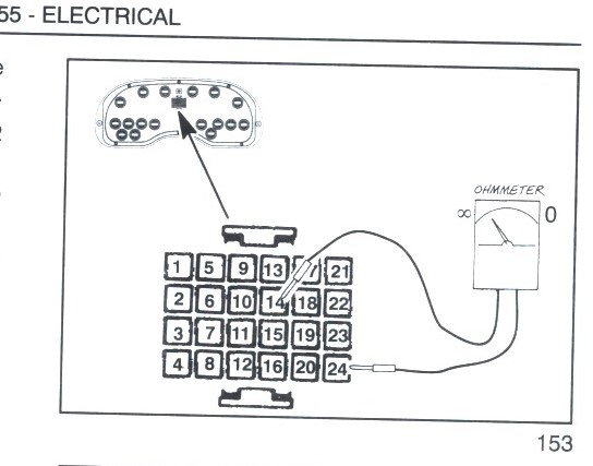

The Tach is connected to the alternator via one wire... it will be a single wire connector at the back of the alternator & will run pin #20 on the instrument panel connector.
You can check & make sure it is connected to the alternator first.... then you could check it for continuity with an ohm meter. With the connector plug removed & facing you Pin #20 will be on the bottom row, it will be the 5th pin from right....
Pic of the Plug

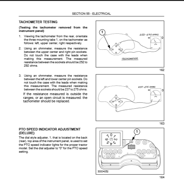

I also attached the testing procedure for the tach...
