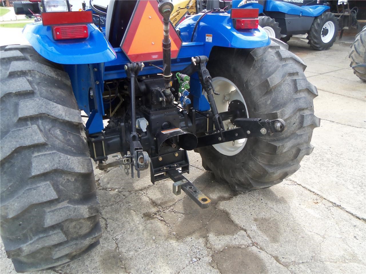

My neighbor has a NH T2410 and the three point is missing most of the stabilizer components. He's not very internet literate so I figured I'd help him. All he has is half of that looks like an anti-sway stabilizer that he says was used to hold the lower arms together and a bracket bellow the PTO with some pins in it.
Can someone help me find the parts he needs?

here is a pick of the rear to cross reference what should be there
   / New Holland T2410
Thank you so much! This will do it.

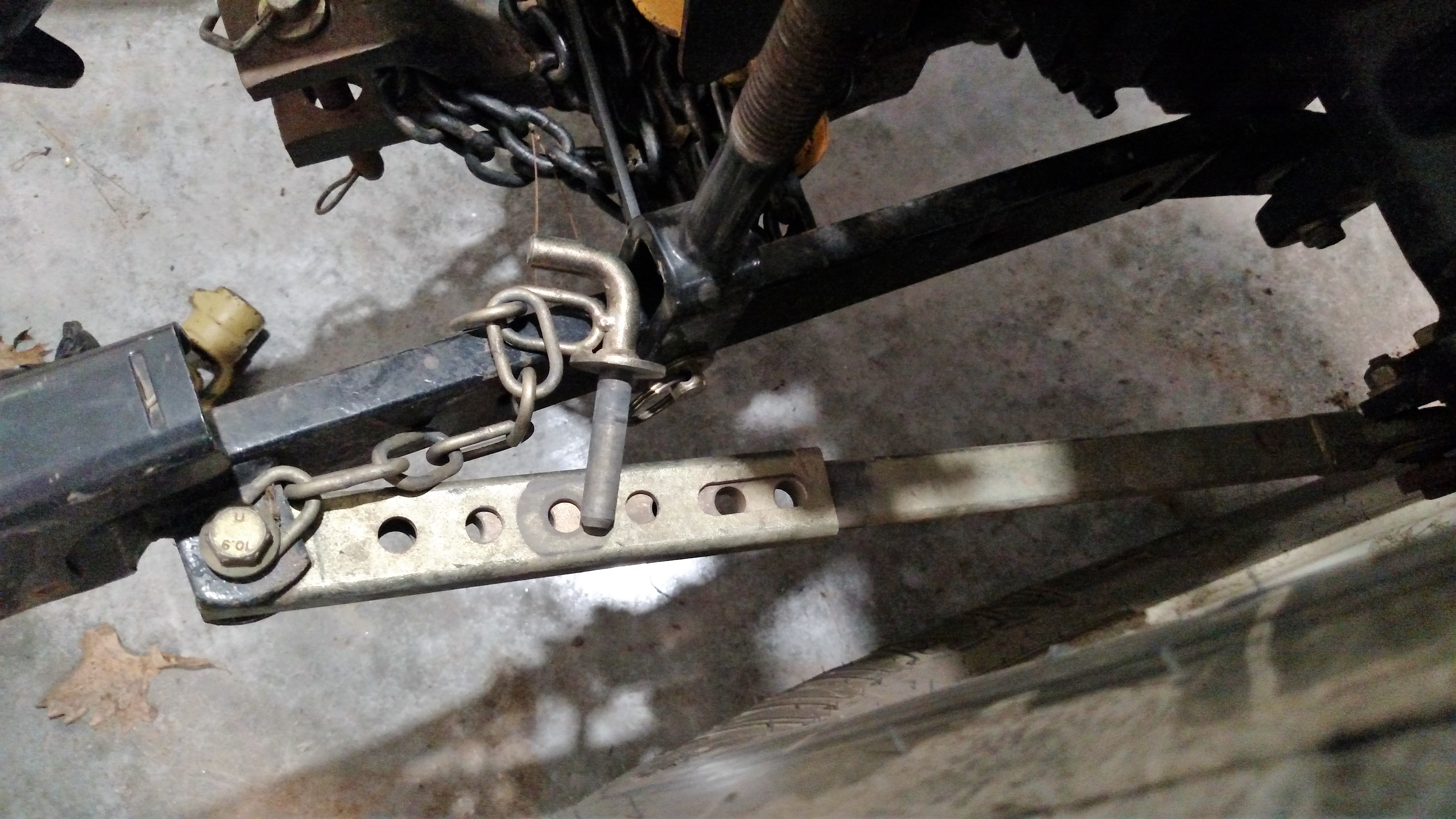

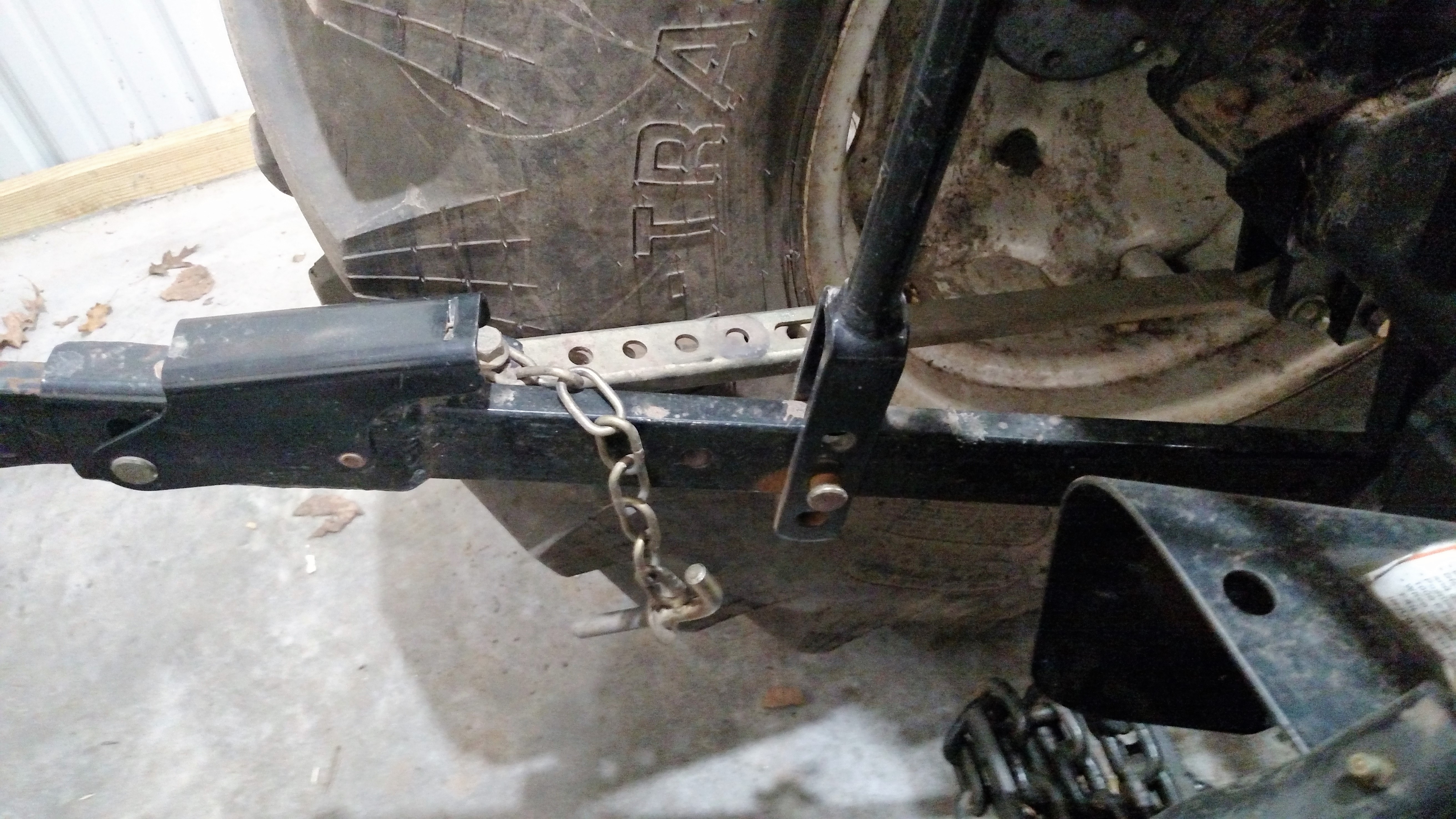

Here are pics of my T2310 stabilizer arms.
   / New Holland T2410
Thank you!
