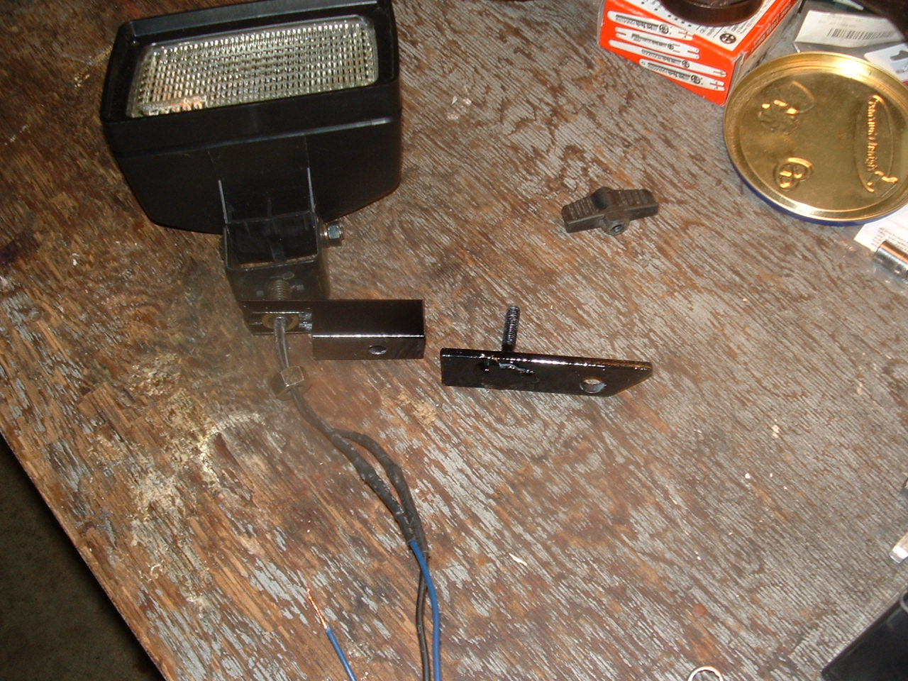

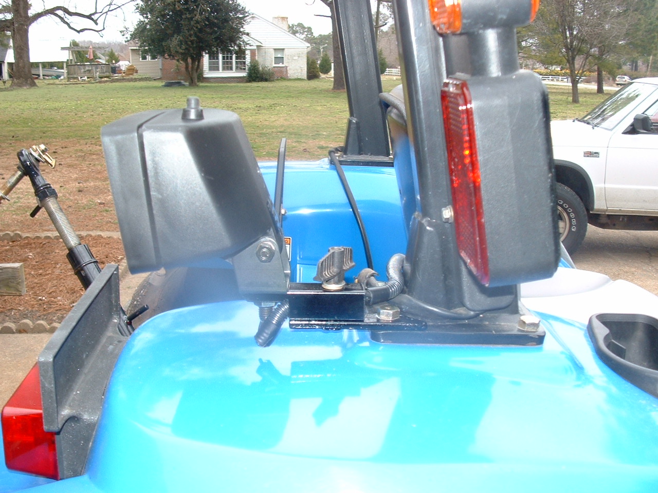

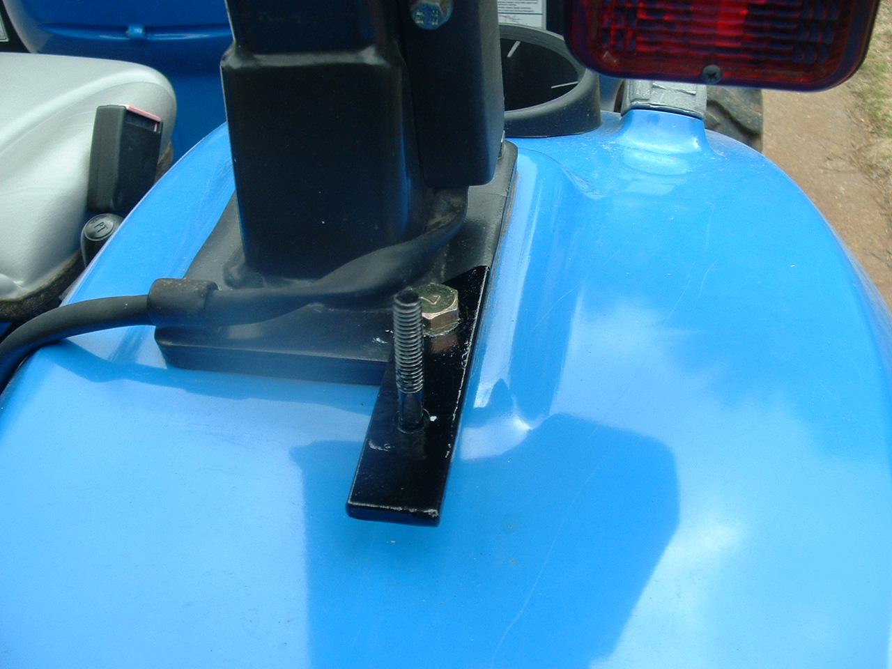

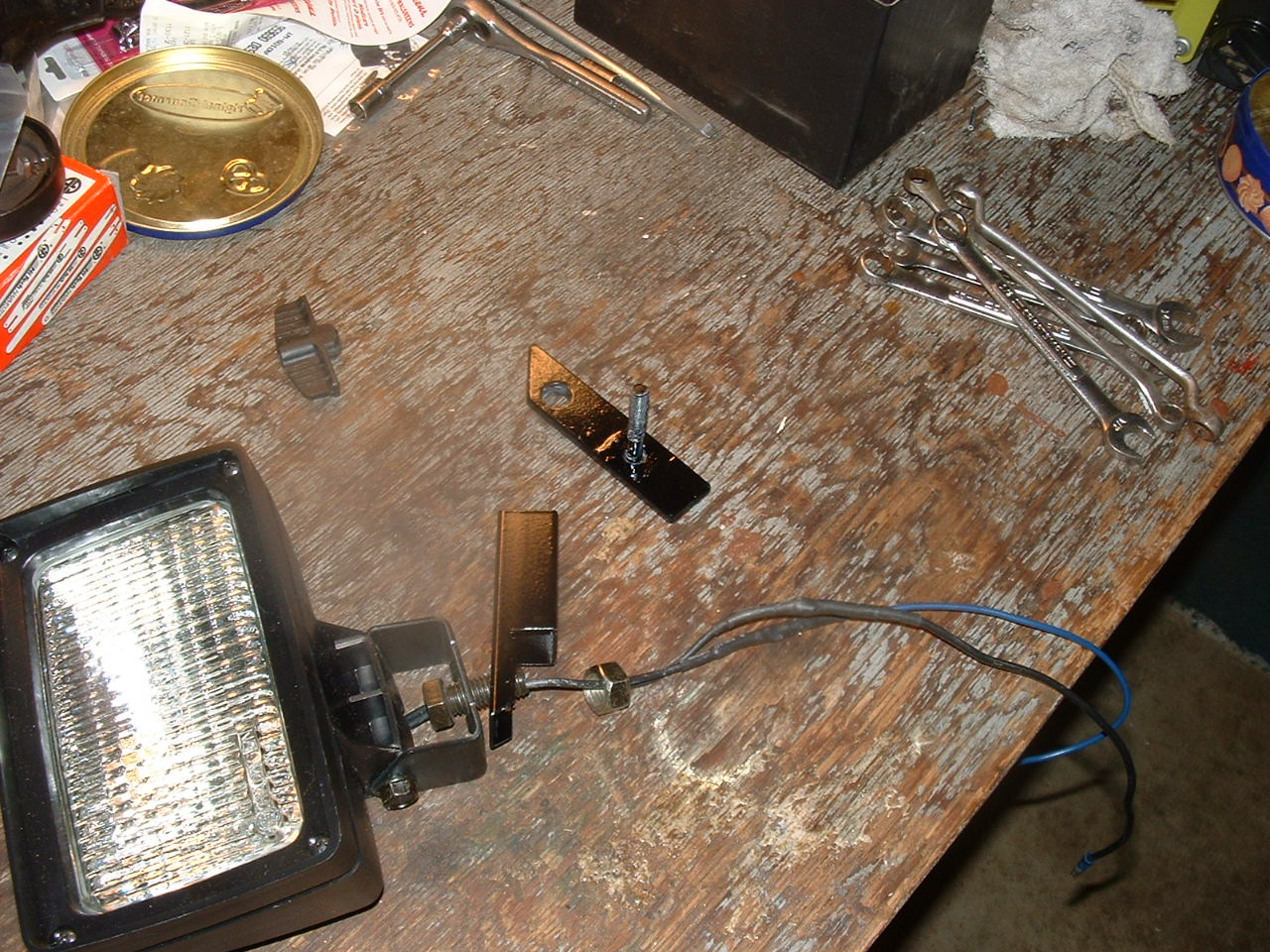

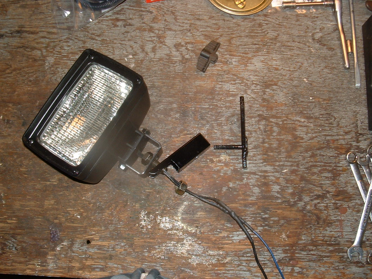

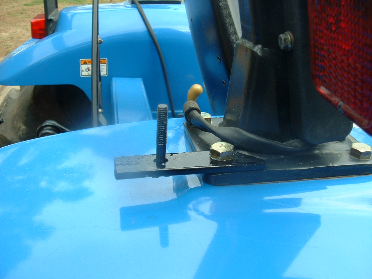

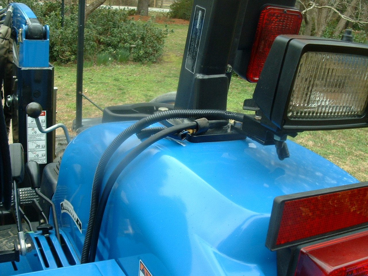

Decided just to use a simple bracket attachment rather than buying the bracket sold for the tractor. Not much to look at but hopefully it'll do. All connections soldered, taped and shrinktubed. Wired into lines made for worklight. Think I'll get one for other side too, may go with a high mount on that one. Used what was laying around. Plastic butterfly nut just something picked up along the way, probably found it in a parking lot.
