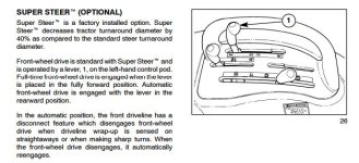

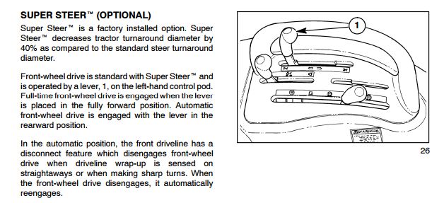

On the other hand :D, the attached would tend to substantiate what AGRIMAN posted above.
Does this imply that the front axle is the primary drive axle on this tractor? the only downside I see to that would be front tire tread life, but otherwise it seems like a handy option.

Welcome to the forum!
That is an interesting concept but, no, I don't think the front is the primary drive.

The sense track is designed to be use with the super steer front axle and its purpose is to engage/disengage the FWD while turning. When you have the lever in automatic and start to turn, it senses the resistance and automatically disengages the FWD to improve the turning radius. Once the turn is complete and the resistance is gone, it automatically engages the FWD.
When you have the lever in full, the sense track is locked out and you have full time FWD. It will not disengage when turning.
I definitely believe you are correct in your assessment. I had to see it for myself by making a sharp turn in both auto and full FWD. It's quite obvious that the front and rear are fighting each other when in full FWD but very smooth when in auto mode.
It's amazing in that the rear inside tire remains stationary during a slow sharp turn. I realize that any tractor with wheel brakes can do this but not without sliding the front tires "sideways" and doubling the speed of the outside rear tire due to differential action. It's also very hard to do a wheel brake turn with a hydrostat when the wheel brake pedals are on the same side as the HST foot pedal.:confused2:
I'm still wondering, however, how the one way clutch driving the front wheels is able to sense the "driveline wrapup" when driving straight on a paved surface and thereby "declutch" the front drive. This is very useful for guys like myself who might forget to disengage FWD when roading.
Would sure appreciate anyone who can explain this automatic stuff for me.

In automatic, the link is essentially a slip clutch, and only engages if the back wheels move faster than the front. This allows the sharp turning radius speed differential to work out. The negative part of this is that you don't get 4 wheel braking in automatic mode. When off road, I put the 4wd in full time.
