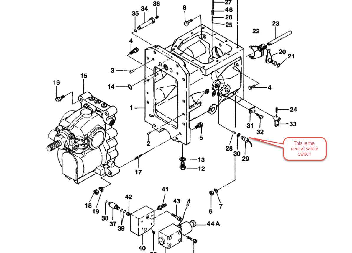

I have a TC 35 D, the owner would violently shift the range selector with key turned in on position until safety switch made contact, at this point tractor would start. I changed oil and filters in tractor, fired it up with no problems, turned unit off to check oil again, once I attempted to start tractor so I could lower boom and grease I am getting nothing. Any ideas here?

Could be your neutral safety switch is worn out. Looks like it screws into the side of the HST case. You could bypass it to check to see if it is the problem. I get my parts from Messick's, they are good people.
View attachment nh-53232-10491-53232-248982.pdf
