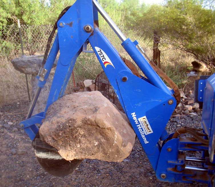

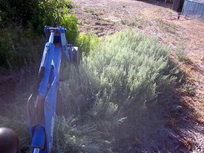

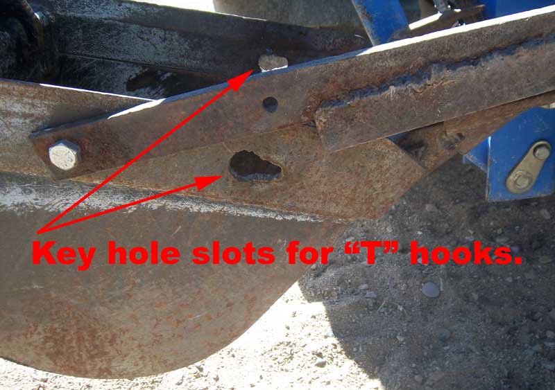

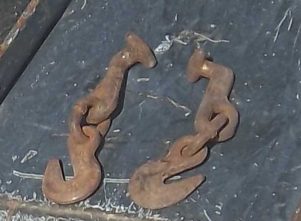

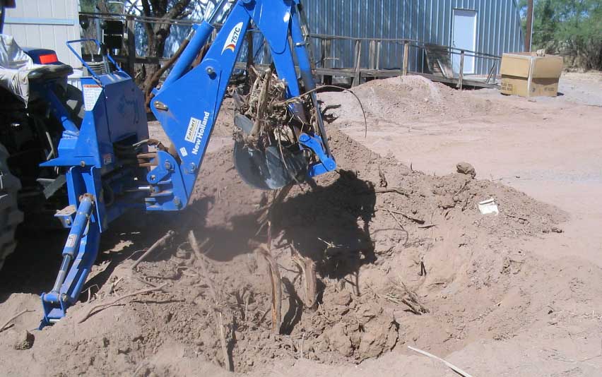

Another 2 cents. My TC45 is a hydro and after using for around 5 years, I would never go back to shifting. I had the back hoe installed at the dealer before delivery. A little expensive, once my check book got over the pain, it was a very good decision. I have found so many uses for the back hoe its used almost as much as the FEL. I also got a full hydro gannon, that almost never gets used. It Has not been on the tractor for almost 4 years.
3 Attachments "made for the back hoe" ( That term is used very loosely.) 1 a simple flat plate that bolts across the teeth, Pickle Fork trencher and Keyholes for "T" hooks.
