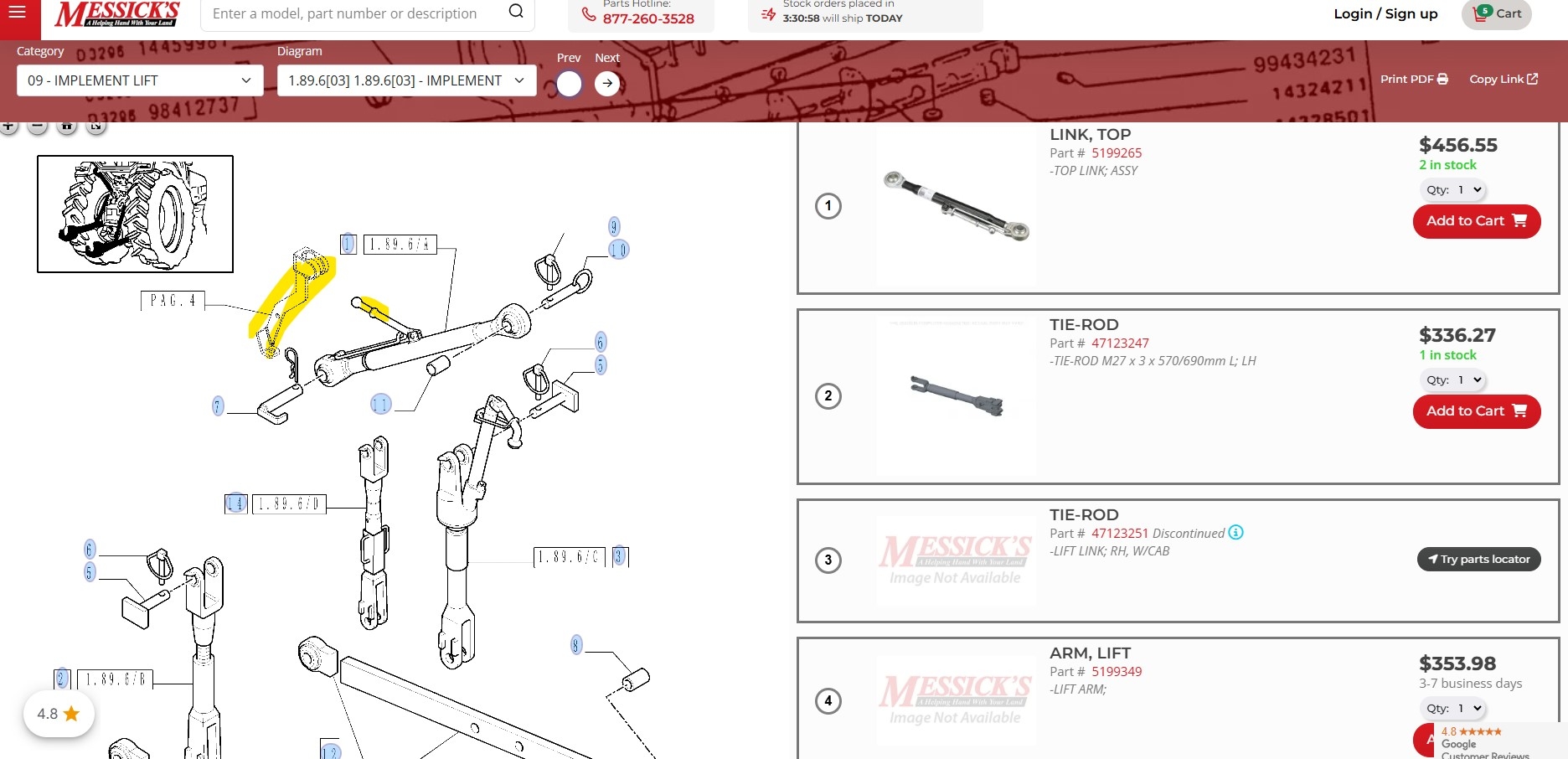

Hi i’m looking for some ideas or pictures for New Holland Center link hook ? Something to hold up the adjustable center link when I’m backing up to attachments there’s not one on my tractor or maybe it was removed. I seen a couple videos where a ball clicks into the hole on the back of the machine, but I looked today. I don’t have that or the hook. What’s out there? What ideas do people have to make hook up easier if the center link is in the air

I have only seen storage hooks for the toplink, that don't really participate in the actual hooking up implements. My last 3 tractors had a metal hook that cradled the toplink and pivots out of the way when not in use.
For ease of connecting implements, many users buy a quick hitch that is basically a frame connecting the lower arms and toplink, and the quick hitch has a hook for the top, and receivers for the lower links.
On edit: I use a heavy duty rubber bungee strap to hold up my toplink, because the metal hook is too small to hold the hydraulic toplink.

Are you talking about the toplink storage?

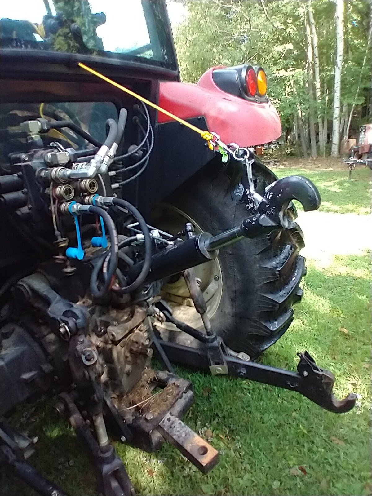

I use a rope, with my hydraulic top link it allows me to hold it in position and adjust the length as needed.
I also have a couple of loops tied in the rope to hold it up when not in use.

My LS came with a built in hook for holding the top link, but after I switched to a hydraulic top link the built in top link holder didn’t fit so I had to start using a piece of rope between the top link holder and the hydraulic top link, it works pretty well but I’m always on the lookout for something better. The hydraulic top link does make hooking up and unhooking much easier.
   / New Holland Center link hook? Dn75da #9
Similar to the rope, I use a bit of wire because it's what was on hand when I needed it. My OEM hook also is way too small. I just pull the wire through the end of the hydraulic top link and give it a quick twist at whatever length I feel like having it and it holds very well.
