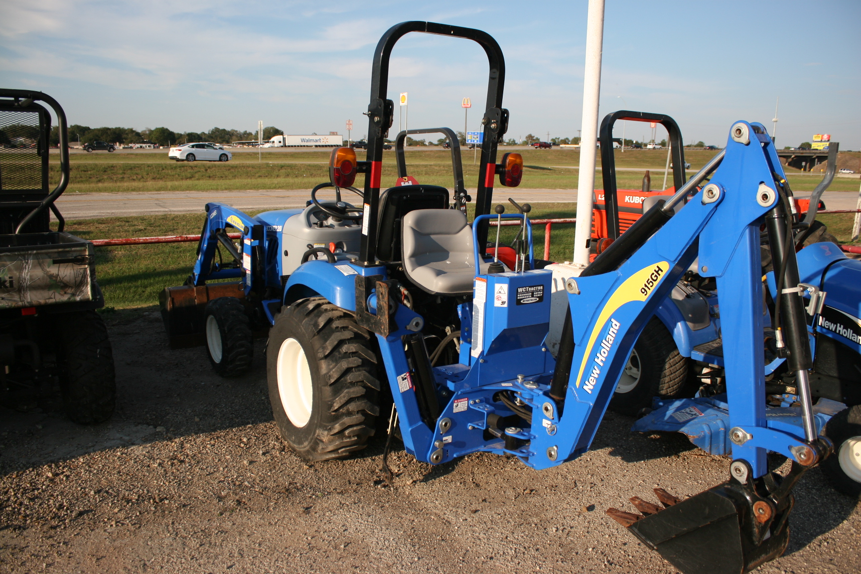

I am looking at a 2012 New Holland Boomer 20 (23hp) with a front loader and backhoe. I am looking for something smaller to supplement my L5240 Kubota in the tight woods/trees.
It appears to have a slightly larger frame than a BX25 and 2 less HP. The backhoe appears to be heavier than the Kubota and just measuring the arms it may have a slightly longer reach.
Kubota salesman said they weren稚 very well made.
I can稚 find much info on the tractor. Anyone have feedback on quality, reliability, issues etc?
The tractor has 200 hours. I don稚 want to buy someone痴 issues.
Thanks for the help.

It looks like a nice clean tractor, the only thing I notice is that the three point arm could get bent when you put the stabilizers down on the backhoe. I would take them off.
