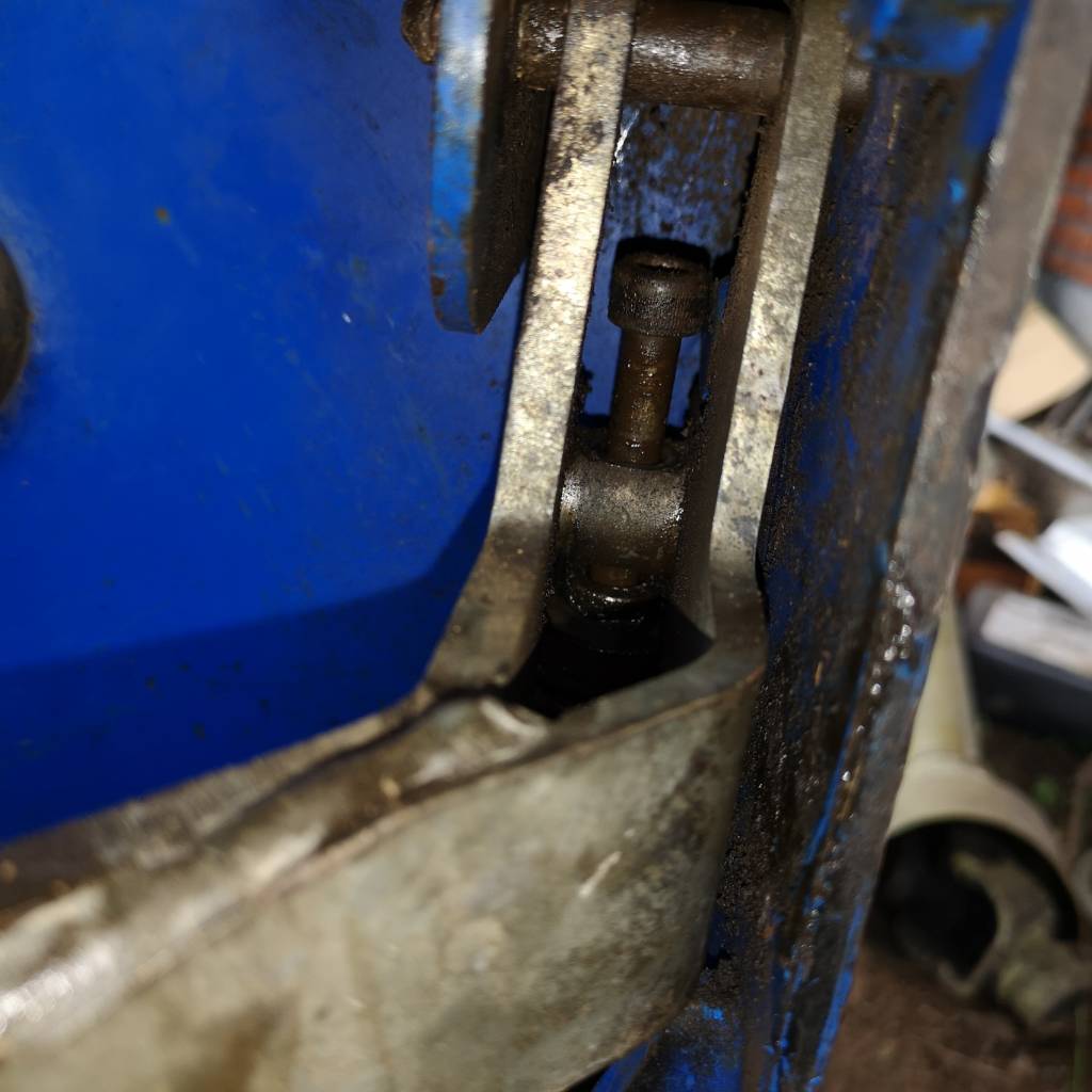

Need help with my loaded. When ever I try and backdragging my bucket comes off. ? I put my pins under load with a jack and I think I might need new springs? Or longer backstopsView attachment 613921 IMG_20190721_173421.jpg
   / New Holland 820tl FEL #2
Need help with my loaded. When ever I try and backdragging my bucket comes off. ? I put my pins under load with a jack and I think I might need new springs? Or longer backstopsView attachment 613921View attachment 613922
It is probably a low serial number loader, the 621TL had that issue. NH came out with latch pins with a different shape. They cured the problem, but ultimately they updated the entire QA plate. See your dealer about the pins, I bet they will fix your symptoms.
The issue is I'm in Mexico and I doubt they will help down here. Any part number or reference to the fix?
I will see if I can maybe just weld a little blocking plate tomorrow to keep the bolt from comming up
