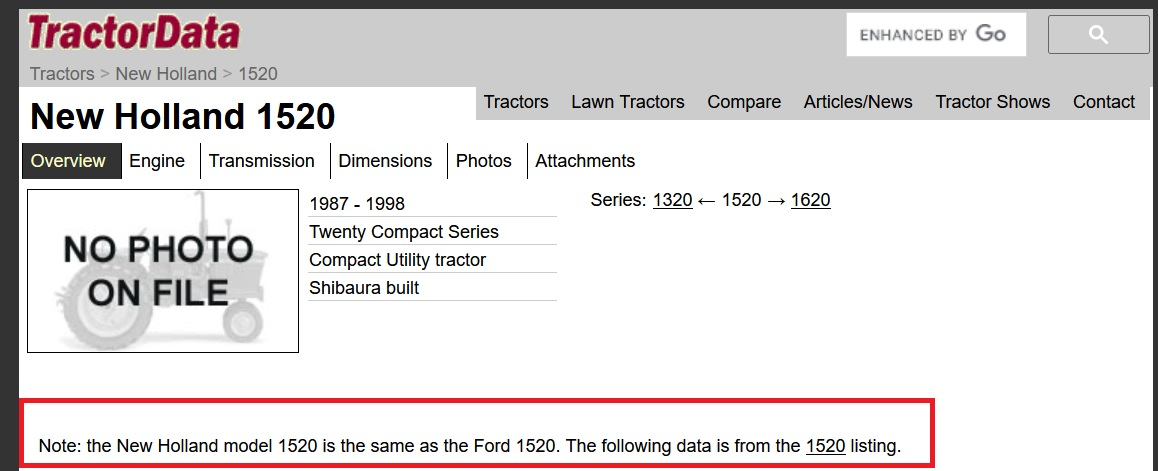

I have a Ford 1520 and it calls for the Ford 7108 loader but I can't locate one. I have found a New Holland 7108 and based on the pics and measurement I can obtain via phone it looks exactly the same. It's a long way from me so I want to be sure it'll work. Anybody have any advice. I can't open any spec's for either loader on my computer.
   / new holland 7108 loader #2
I see info on Tractordata.com which says the Ford 1520 and the New Holland 1520 are the same machine.
The on line loader spec's are here:
loader spec
Ford bought New Holland in 1985, and Fiat bought Ford New Holland in 1990. The Ford name on tractors soon became New Holland, but the blue color didn't change.
If I were in your shoes I would go for it. Both tractors are actually Japanese Shibaura's re-labeled
