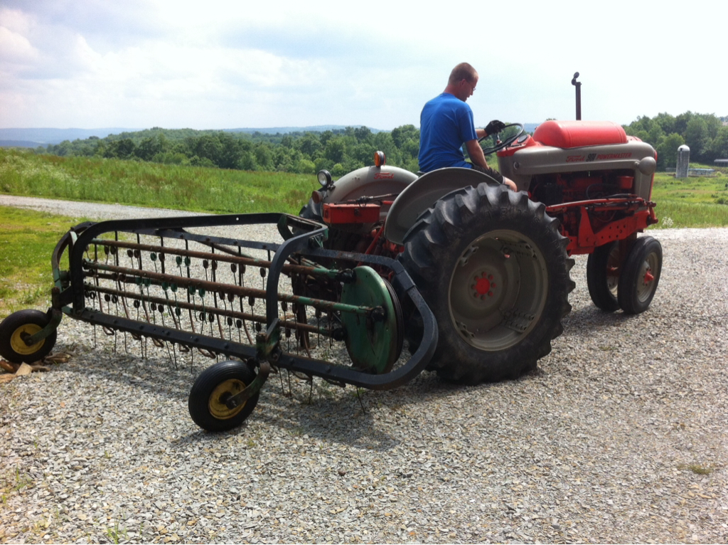

Do you have a picture? I use this old john Deere rake and adjust the length of the top link so that when I lower the 3point all the way the rake teeth are just barely scraping the ground.

Oh and ignore the goofy looking guy on the tractor. Lol

Ya you bet it's just like that one. How do you like it?

The one in my picture is pto powered and works very well. My neighbor has basically the same rake but is a pull behind with a single wheel in the front and two in the back. It is ground driven and I prefer it slightly to mine but the three point does the job and does a good job.

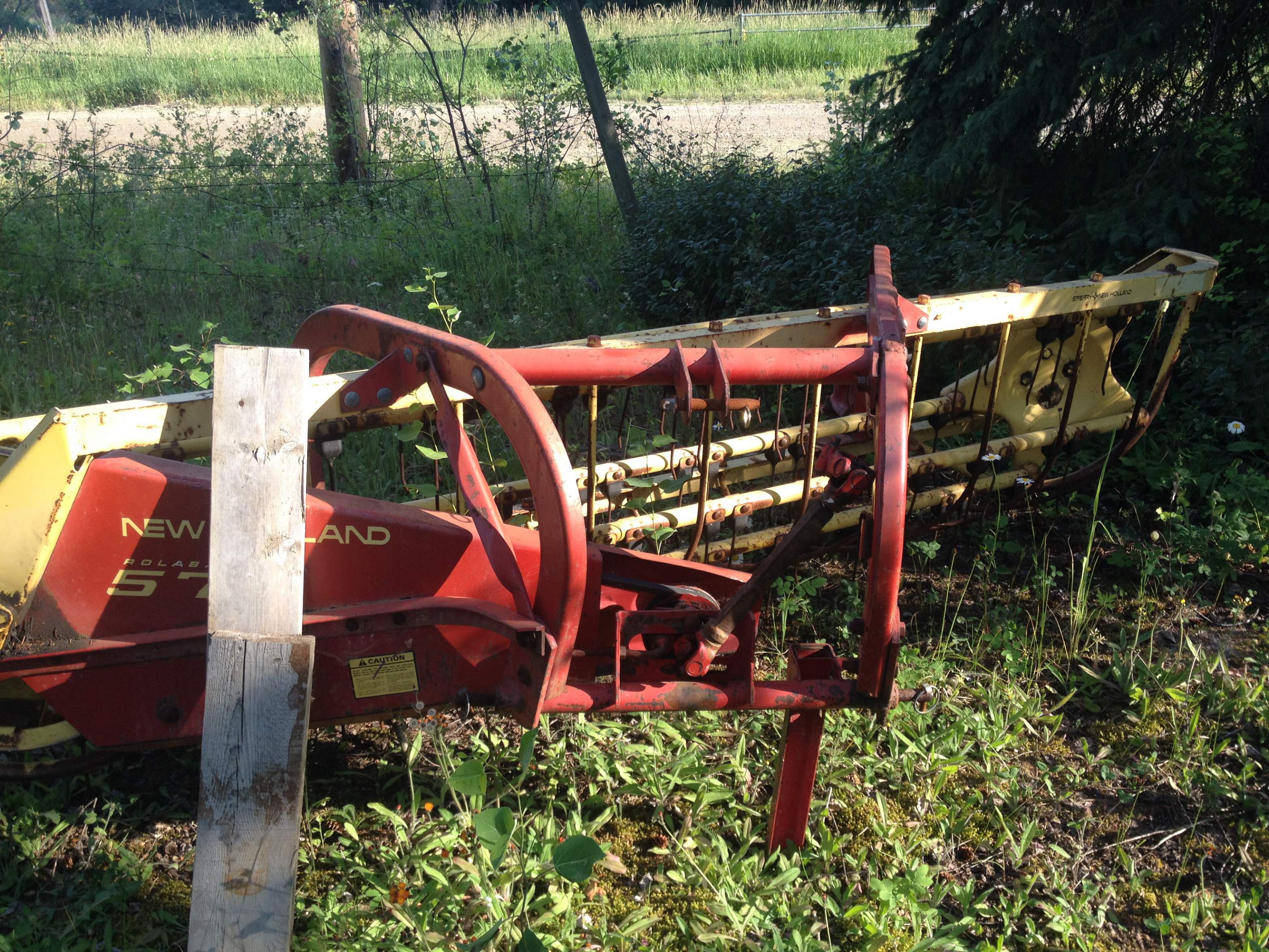

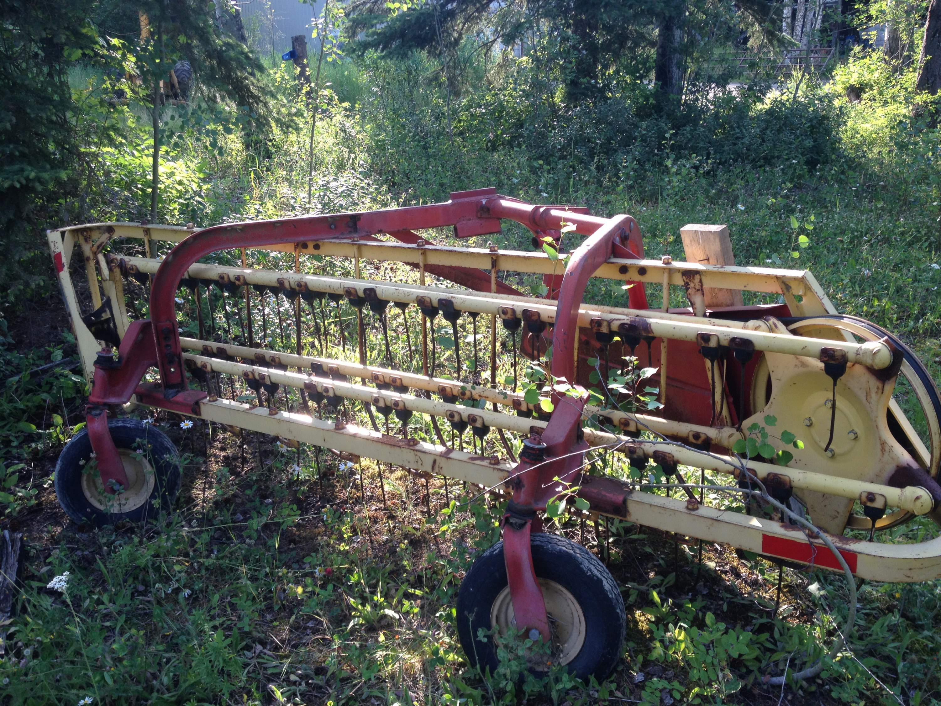

How much would you pay for this one? Good overall shape, good tires, 6 missing tines, spare belt.
I'd just have to modify for my 3 point.

That looks to be in pretty good shape. What do you need to modify?
