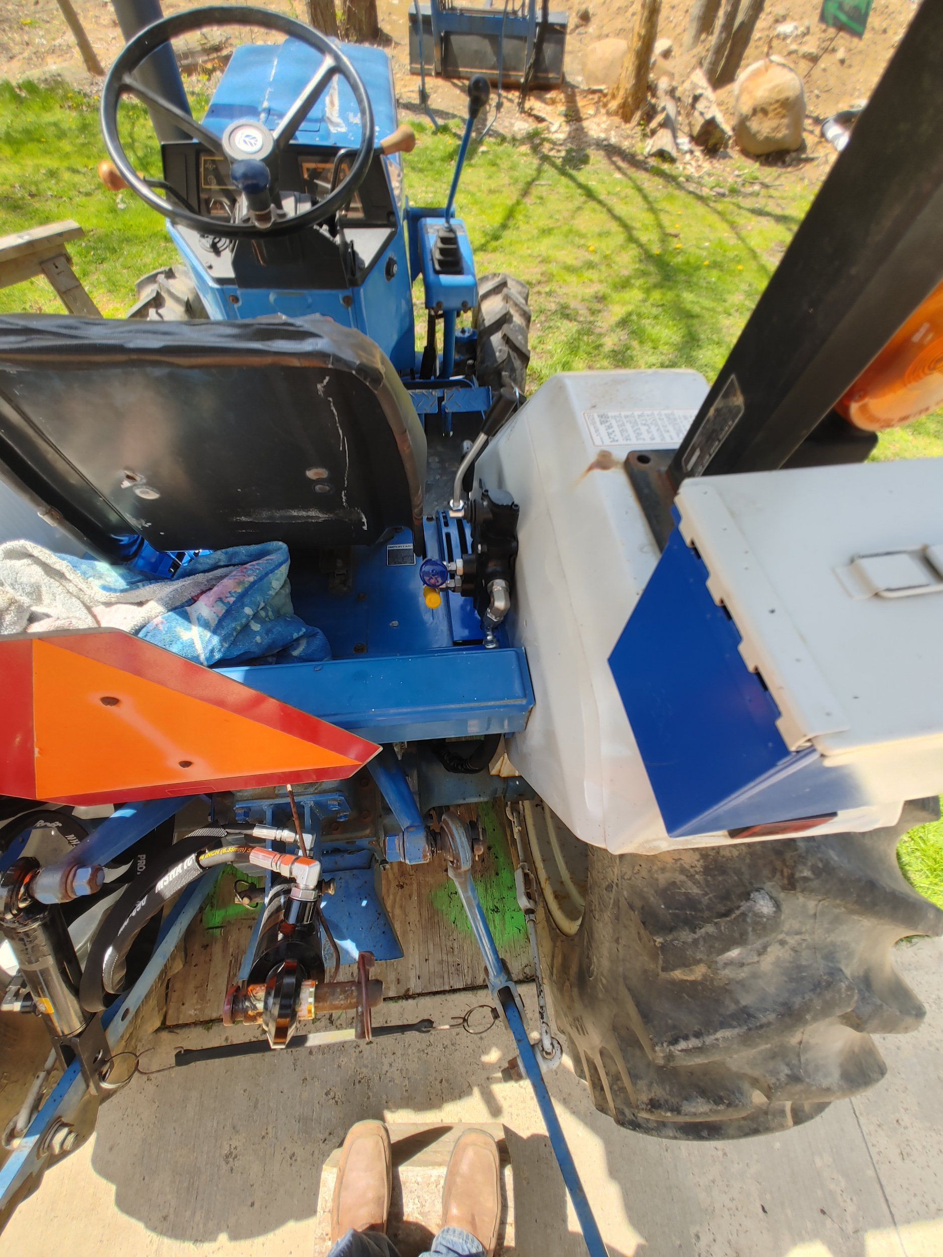

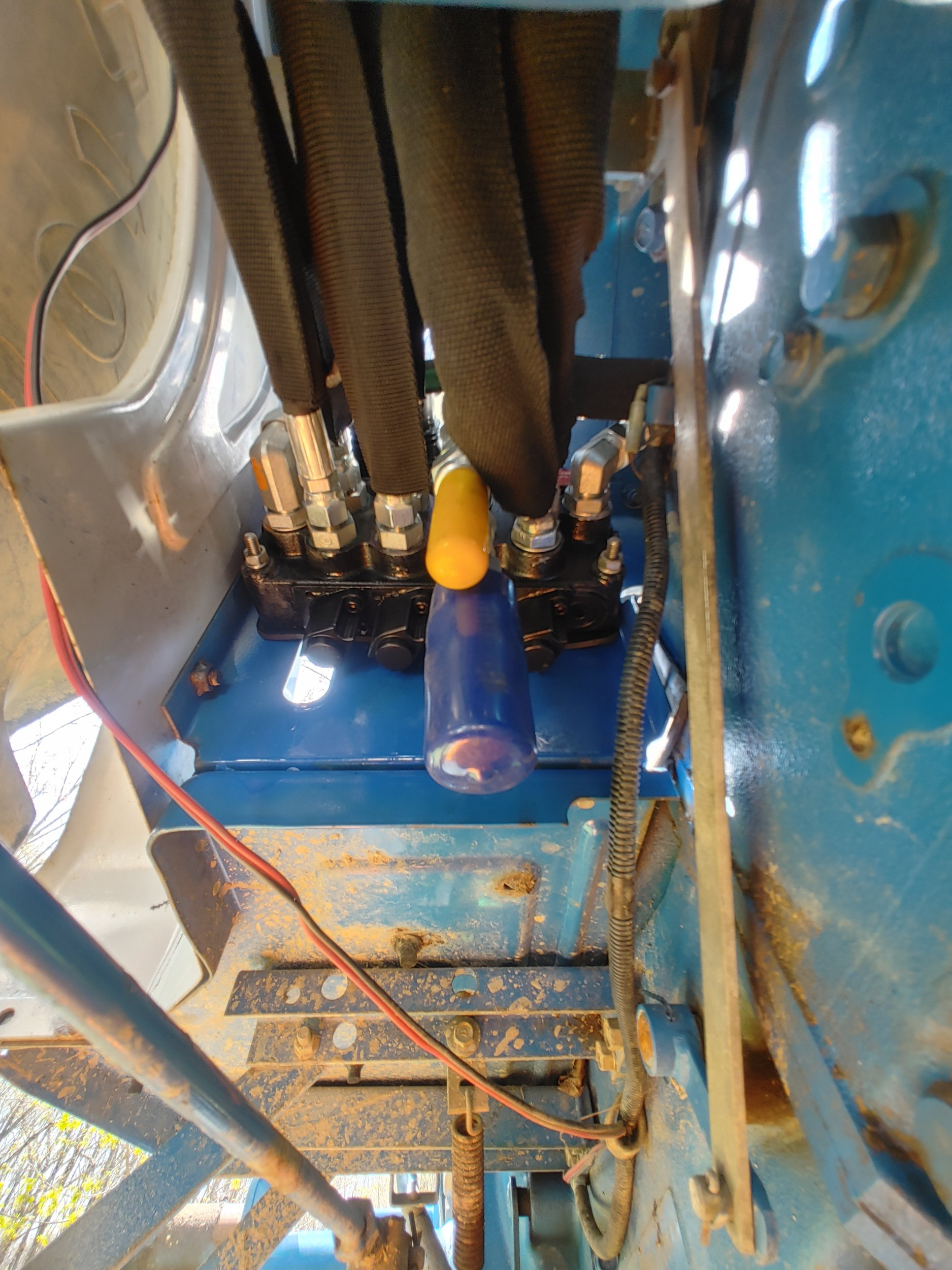

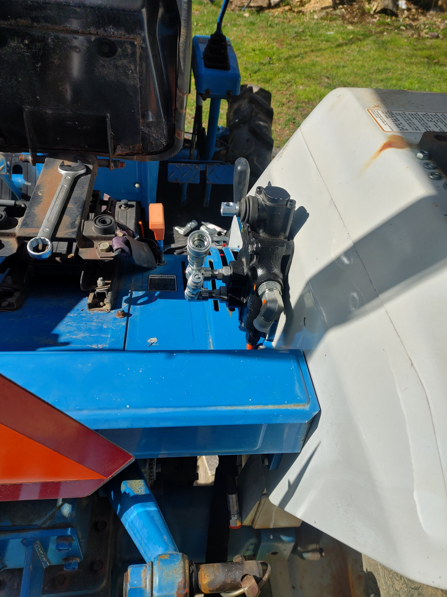

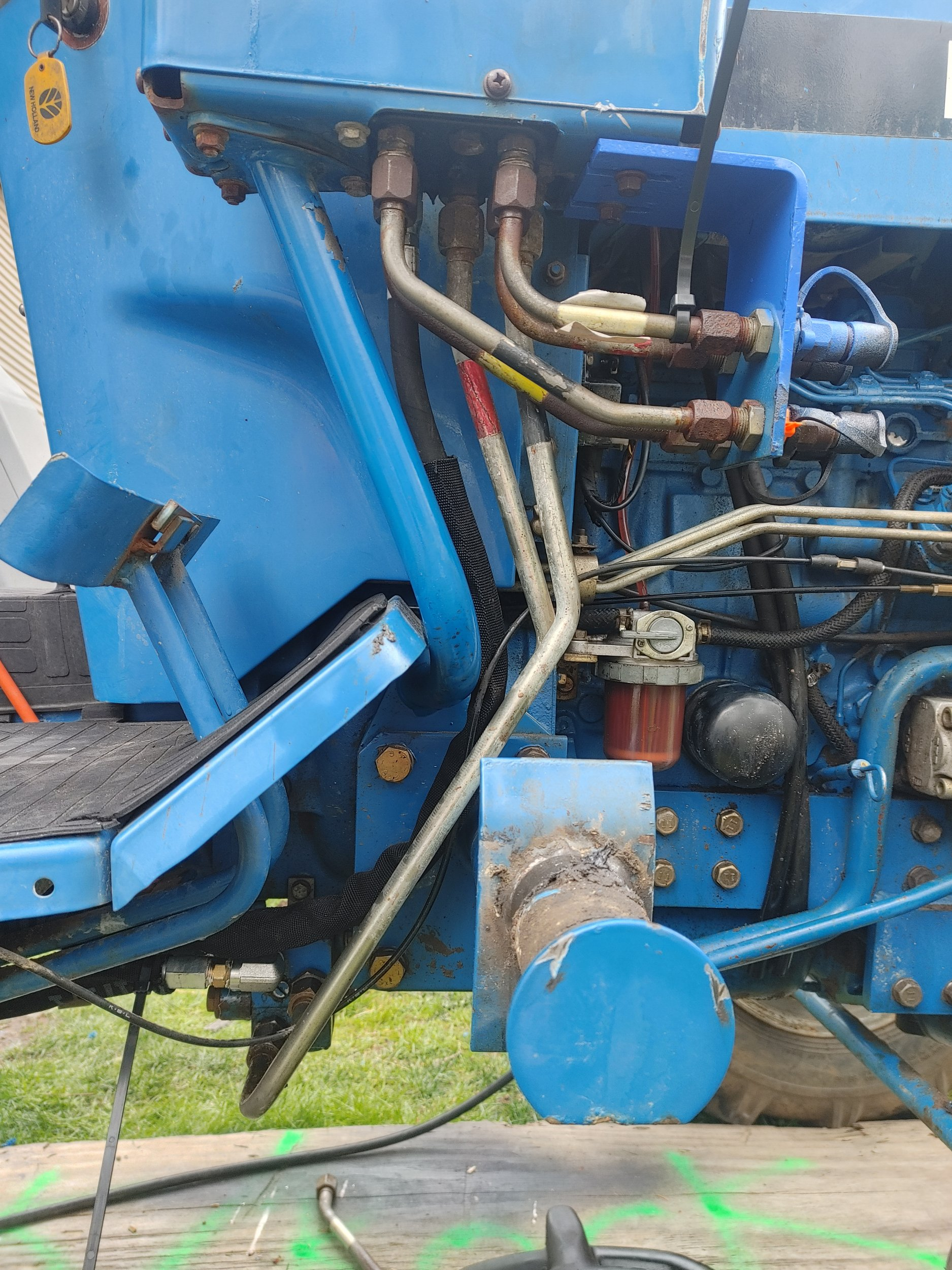

I saw Whitbread's page on upgrading his New holland 1620 while searching for answers to my own problems. (Big thanks for that thread!) pretty much the same layout as the 1620,the difference is that hydraulic filter is in the way on the right side fender so I plumbed the 4 spool in on the left side.

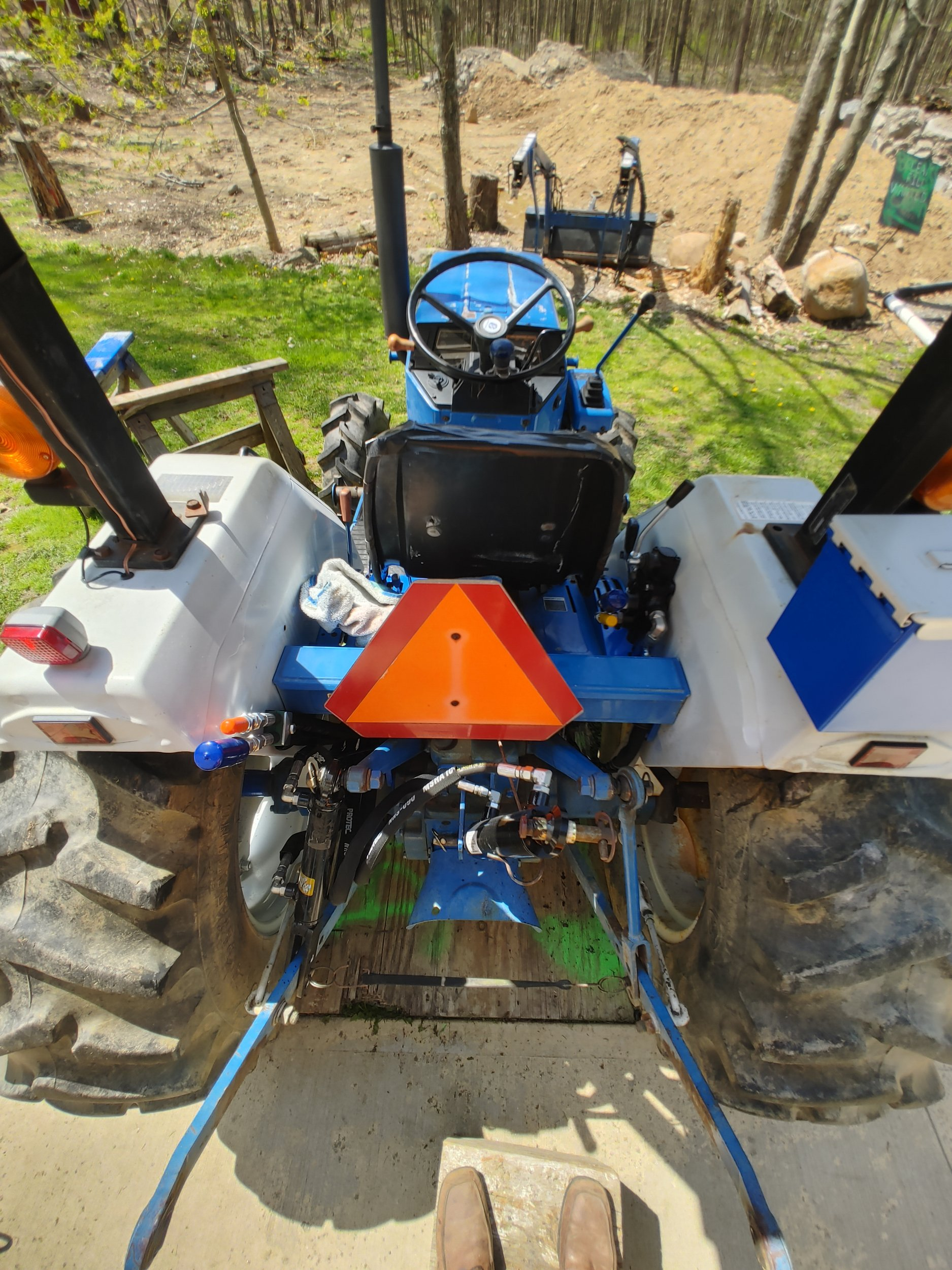

I wanted to add rear lines to my 1920 so I can be lazy and stay in the seat while plowing snow. The OEM style add a valve kits are pretty pricey for one extra set of hoses and a valve. I got most of the parts from Surpluscenter, with a few hoses from the local Napa at quite a bit more than I wanted to pay.
I ended up adding a 4 spool valve and a 3 position single spool valve for about the same price, but a little more elbow grease.

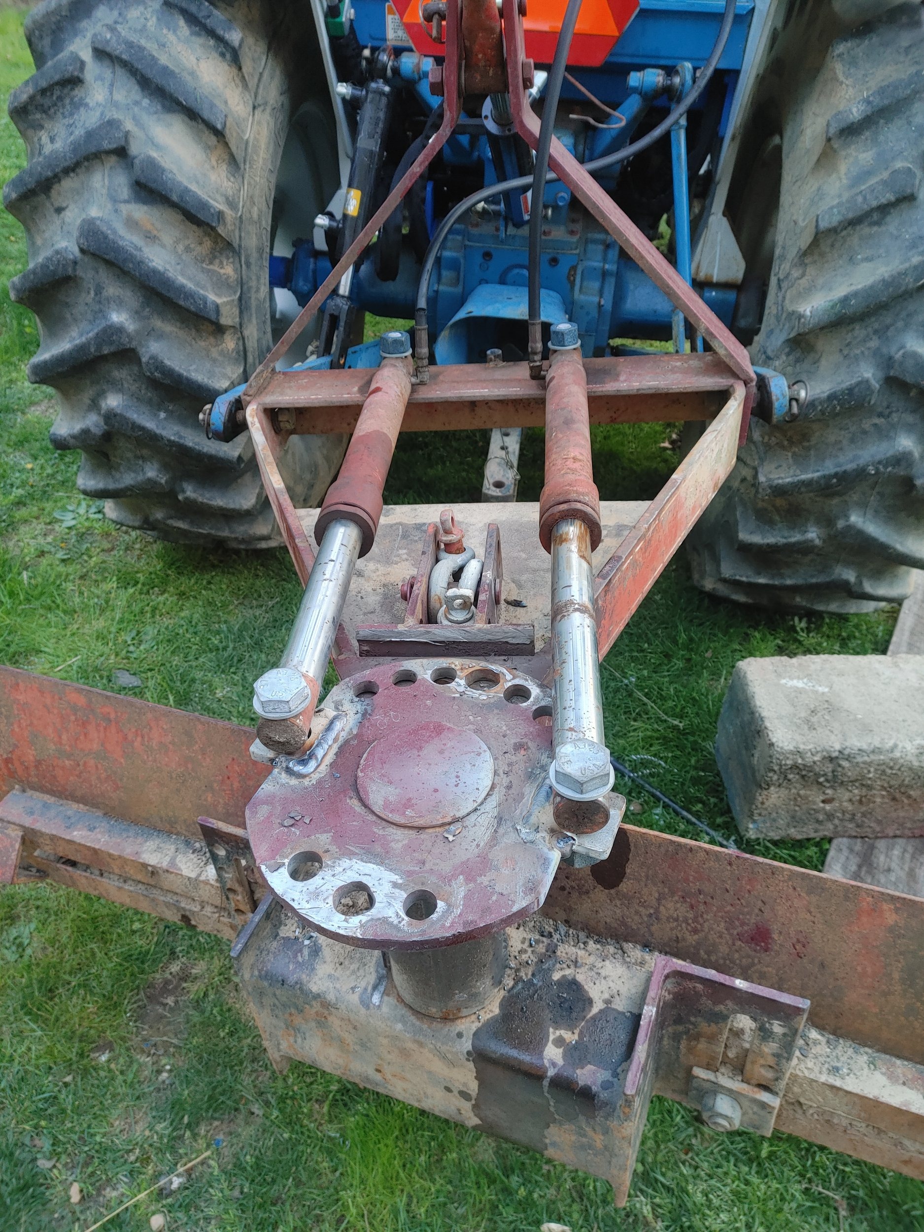

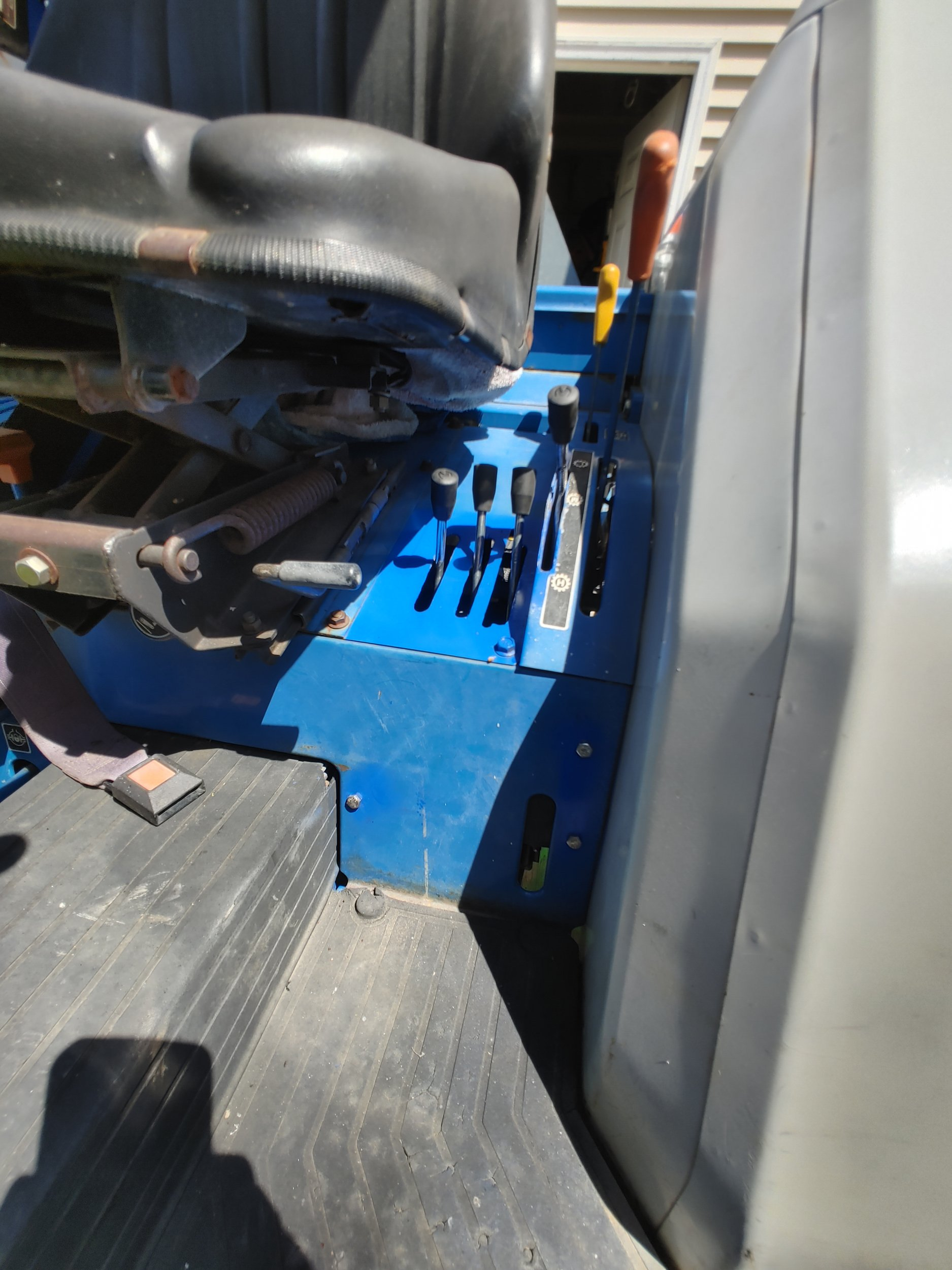

I now have a hydraulic top/side link a rear remote line, provisions for a front grapple/bucket thumb and a power angle plow and grader blade. The grader blade is still kind of a work in progress, just threw it together last night to check the function and if the salvaged cylinders I had worked.
