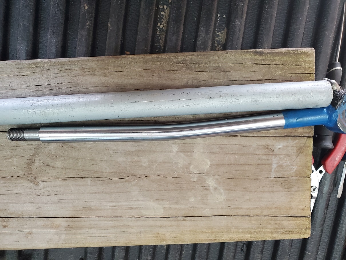

Finally started this. I called a few hydraulic repair places. Cost to replace the seals was around $250 - $350. A new cylinder from Messick's is $889.

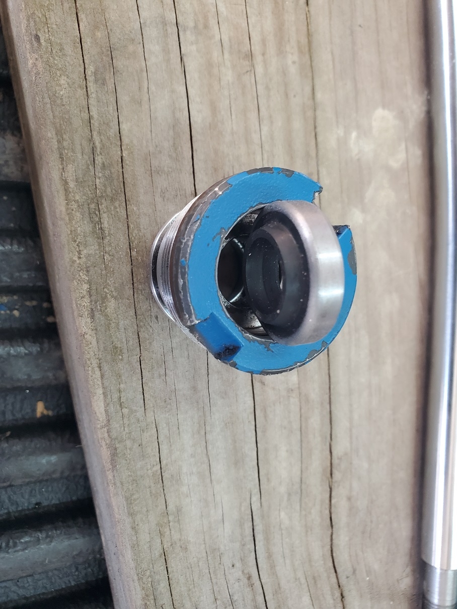

I bought the seal repair kit and took it apart today. First thing I noticed is the piston is bent. It rubs up against the front axle housing when turned all the way to the left. I can fix that by adjusting the steering bumpers. Can the piston be straightened or do I need a new one. If you run your fingers over the area where it is bent you can feel some slight irregularities. I would think that could cause a leak? Also the new seal is larger than the opening in the cylinder cap. Would need a very small amount of machining to the inside of the cylinder cap to fit the new seal in.
Are there any after market cylinders that could be used?

Wow! And you didn't see that before you took it apart?
   / New Holland 1620 - steering cylinder rebuild kit questions
It was not noticeable until I looked closely at it. Needs to be fixed so just continued the disassembly.
