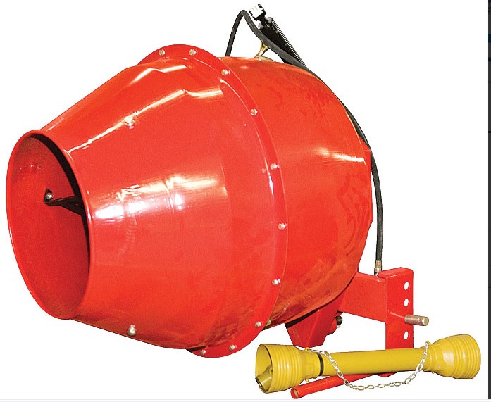

Three point five cubic foot cement mixer
