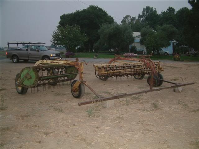

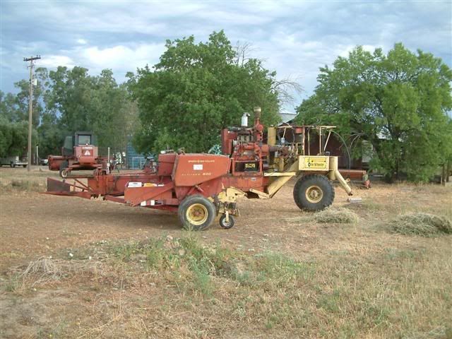

I assume you're into dry land farming and don't need irrigation where you are in Indiana.
My neighbor has three 10 acre irrigated alfalfa fields. He uses a NH 500 3-twine baler set up to be self-propelled.
The bales weigh 100-130 lb. He can bale 10 acres in about 45 minutes with this rig.
To rake the crop he uses a pair of side delivery rakes on a single hitch to speed up the process
He and his helpers buck the bales onto a wagon by hand. You'll probably want a bale accumulator that attaches to your baler. There are several vendors for this type of equipment. Just Goggle "bale accumulator".
He uses an 8-10 ft wide Brillion seeder for planting.
Discing is done with a 12-ft tandem disc pulled by either a D7 Cat or a Massey Fergusion 294 4WD tractor.

Forgot to mention that my neighbor mows his alfalfa with an old NH swather that you can see in the backgound of the 1st photo I posted.
