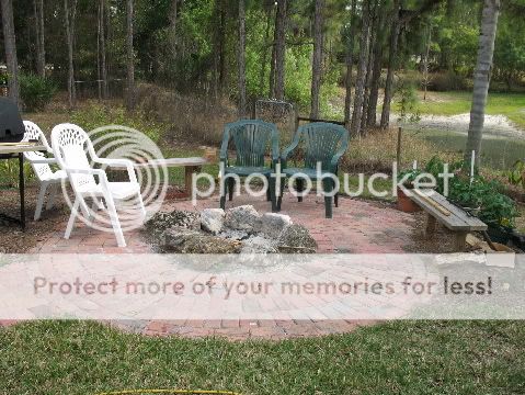

All of this vast supply of wood :D is for our little fire pit that I put in about a year and a half ago. We actually had a place to burn wood before this project, but it was in need of a makeover. I had to move a retaining wall and about 20 yards of soil and then regrade the area before laying the pavers. I was lucky enough to find the perfect pallet of "seconds" at the local paver manufacturer.
I just set the pavers on top of the finished grade because the whole area is just sand anyway and there won't be any vehicle weight put on the pavers. The water in the background is actually our pond, but in the wet season it tends overflow a bit.
Now, it is the dry season so it will give my firewood time to cure before I can use it. I'm just too nervous about causing a fire. This picture of the finished pit shows the current pond level, which is down about 7' from the picture above.
I used 300 sq ft of pavers for the project, but only had to cut a few to make things fit since I was willing to live with some fairly large gaps around the fire pit. I used paver edging to help hold the edges in place, and put down St. Augustine sod for the turf areas. I filled between the pavers with straight paver sand and broomed it in. It took me 2 days (not 8 to 5!) to lay all of the pavers and I had forgotten how much I disliked doing paver work. But it is rewarding to see the finished project and sit around the fire with a cold one.
   / New guy with a fire pit #2
Very nice job. You sure blended it in nicely with the existing landscape.

Nice job, Alwasy good to rub in the good weather this time of year to us northerners LOL:D
Seriously looks good. Im relaxed just looking at it always wanted something like that

Nice work, and form Oregon, that is a "cute" stack of firewood...:D

Nice job, it looks very relaxing and peaceful.
Is it normal for you pond to fluctuate by 7 feet or more? Seems like an extreme change in water level. Do you have any fish in it?

Eddie,
Yes it is normal and yes there are fish. I caught a 6" one-eyed largemouth in it last year! Mostly the fish seem to be walking catfish. We had a bunch of tillapia when we first moved in years ago but I think the catfish and the herons got them.
Down here we live on the world's biggest sandbar! There is nothing in the soil but sand and a little bit of organic matter which breaks down quickly in the heat and moist conditions. My pond level is roughly the level of the surface water table since the pond is just a hole in the sand. Our soil (and ponds for that matter) are nothing like the ponds in your neck of the woods. Your pond actually holds water, my pond is just missing ground.
Now, if you really want to have your building senses messed up read on. The sand that was dug out to make my pond was piled up to make a high enough place to build my house! It has taken me years to come to terms with the idea of piling up a bunch of dirt and building a house on top! I know that's not how it's done in E TX! But trust me, there is something to be said for having the grade of your finished floor at 24.5' above sea level. It keeps your feet from getting wet and it means you aren't that far from the ocean!
