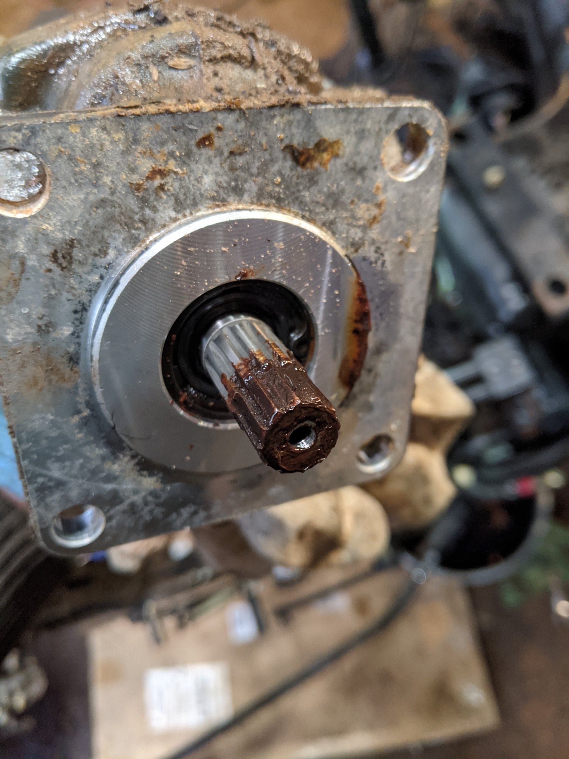

Greetings, All
As I mentioned in my "Introduction" post, I just signed for a 2005 GC2310 from a private owner. Complete with loader, backhoe, but no belly mower. Engine, paint, and electrical intact with no signs of "field maintenance" and paid $10.5k with 509 hours. I had inspected a half-dozen other brands offered by private parties local to me and both those with/without backhoe in my price range were rode very hard and put up wet. Thanks to all the reviews here I felt this was a solid package at a fair price.
After writing the check I had a sleepless night of course wondering "What have I done?" Came back here and *really* read the posts started by hknapp about premature failure of the aux hydro pump. OMG the seller must have seen this NOOB coming a mile off! Wondered how long he would have to flog this bomb waiting to explode before they found me, The Fool! :D Scared myself stupid overnight about how much more money this one was going to cost me and if I should have just gone with payments on $18,000 for a new GC1710. Soon as business opened I called both M-F dealers each an hour away and asked service if 1) they had heard about this problem on a thirteen year old tractor, and 2) would they suggest doing a premature replacement and what would that cost?
Selling dealer service desk got huge marks by being honest: "We haven't been a dealer all that long, actually." Guy researched and by the afternooon found there is a M-F TSB on the pump, and sheepishly admitted repair was expensive, their shop could do the work for ~$2500
Second dealer service mechanic with 40 years M-F experience: Finished my sentence for me, "yeah, the pump spline shaft shears off." Estimated $1500 repair cost.
BOTH agreed that the thing for me to do is to run it until it fails. A LOT of tractors written about here have failed with between 250-750 hours, but I wonder about all the GC2310 still running fine we never hear about. Some posters here mentioned "thousands and thousands of dollars" and someone $6000 for cost of repair, but those posts are all from around 2008-2012.
My Serial is JPA-20275. Wouldn't it be wonderful if the service manual split between pre-JNA and post-JNA was for an updated pump! Maybe I'll get lucky.
I am going to run it until (if) it breaks. The estimated cost of repair is not excessive in my opinion for the tractor I am getting. Wish me luck!

I had exact same model and power/feature wise it was a very good machine. Then the hydraulic pump went out...not really! I traded it in for a larger machine.
You already bought it so enjoy it just as dealers said. Even if a pump would go out with the quote you've received you'll still be $5k less than a new one. At some point you will put some money in it for something. As a side point, if you've run it hard enough with no leaks that is good sign for now. Even if it does leak sometimes it's a very simple fix.
Keep an eye on the hydraulic cooling fan under the tractor and make sure it does not get damaged.
Welcome to the forum and enjoy the tractor!
   / New guy meets GC2310 Aux Hydraulic pump failure for first time - Topic Update #4
If it hasn't failed at 500 hrs it probably never will. Also, can't imagine anyone charging $2000 to repair that with out going to jail - even $2000 is pretty steep.

The repairs quoted include losing the bearing inside the transmission case, then having to disassemble to fish it out and replace.

If you do the job premature, you only need the gear and not a new pump. That could knock the price in half and give you piece of mind.

i doubt the pump is rebuildable. I can supply most hydraulic pumps for around $500
   / New guy meets GC2310 Aux Hydraulic pump failure for first time - Topic Update #10
Can you supply pump parts? Say a new AND Longer Shaft for the pump that comes out of the GC2310?
Its a Shimadzu GPY10R708. KYB also makes a replacement with a 3/8" longer shaft (KP05106CSSS)
but I need at least a 1/2" longer shaft.
