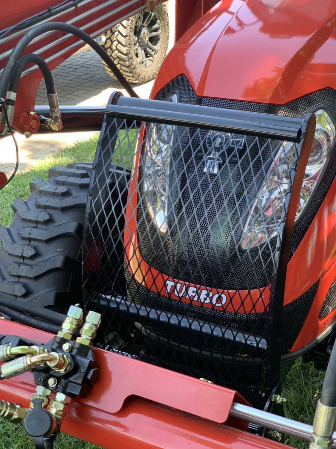

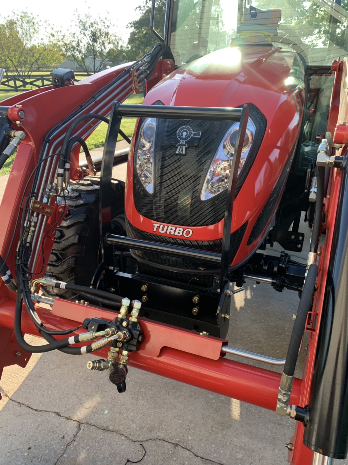

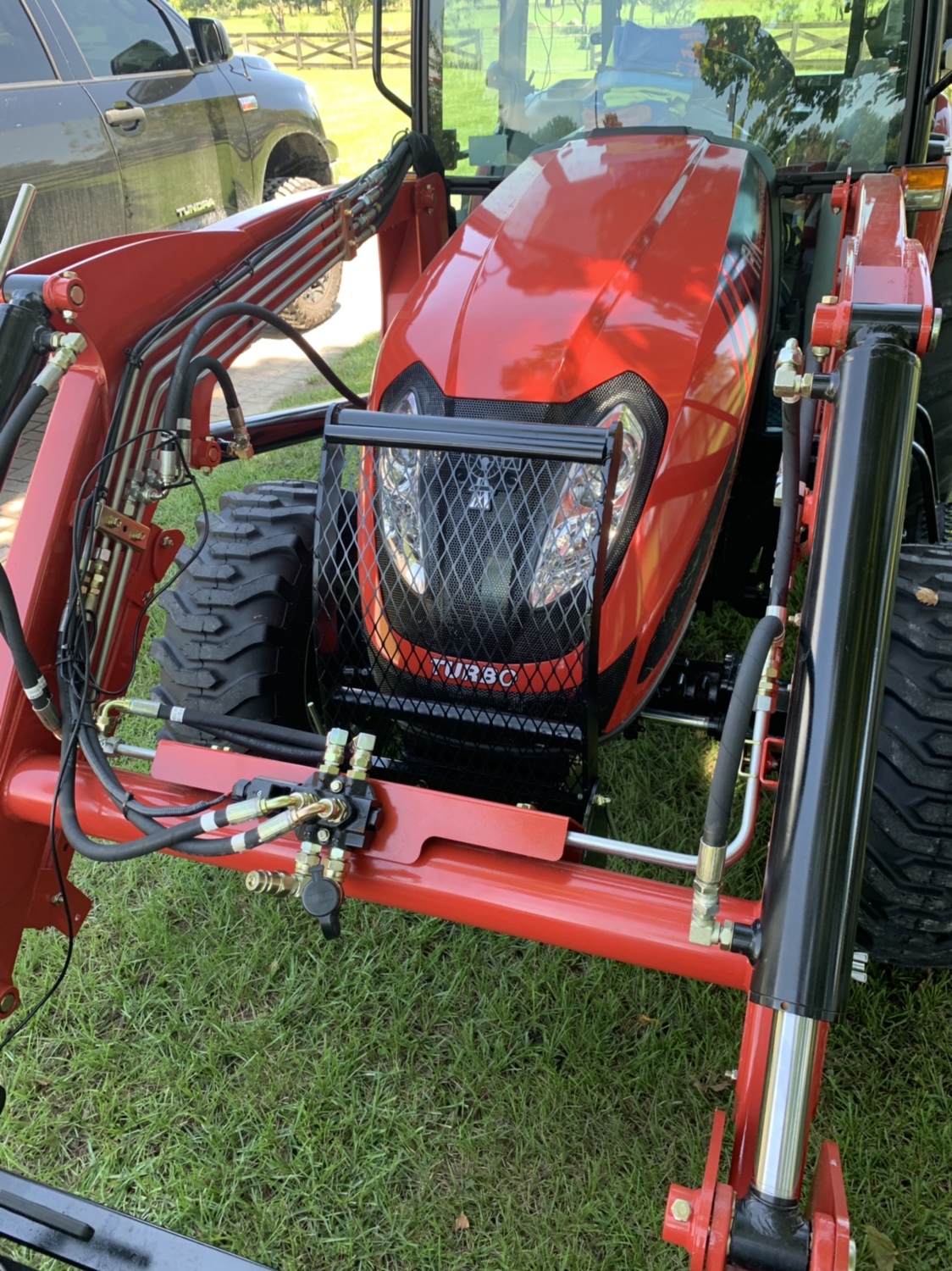

After watching a branch almost javelin the front grill I thought it needed something a little more heavy duty.
BEFORE
AFTER
Let me know your thoughts. It’s welded, and the top round pieces are PVC because the top and bottom edges were sharp.

Nice!
Thought: Instead of PVC, what if you used a length of thin-wall steel tubing? You could put it in the vice and cut a slot with a cut-off wheel in an angle grinder. Then slip it over the same way the PVC is and tack it in place. Or for that matter, you could just use a piece of solid round bar and tack it across the tops. Just thinking out loud for a more robust edge. :)

Thought of both of those. Which I like. I botched the PVC the same way as the thin wall steel tubing would have been. I could’ve tacked the expanded metal right to the frame. Not really sure why I chose the PVC, quicker and I’m battling a cold in July? I may go back and tack it up or see how this holds up.

Nice job.
I did the same thing. Went to a welding shop and got a 10ga. X-panded metal piece cut to my specs and cheaper then a box store, plus 1/4 in. x 1/2 inch wide flat bar to bolt mine on. Don't have a welder.
After clearing out about 2 acres of decayed mesquite and oaks the grill look battle tested and held up well.
You will really be glad you got that little beauty mounted up! :thumbsup::D
I did not install a top guard like you speak of, though it can use it. But the top is cut to short to add a piece.
Will have to warn the dealer mechanic when he does the valve lash check at the 400 hour mark...lol.

My brother put guards on my 5740 and 8540; used angle iron and expanded metal to cover a bit more. ovrszd made a real nice one for his M9540.
