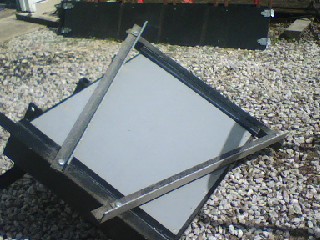

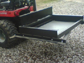

1. what RPM does everyone operate when running FEL?
I did find out that I will be needing a ballast box of some sorts soon. put 4 hours in the seat moving 12 yards of 3/4 gravel for a pool project and got alittle, light a couple of times. searched thru and probably will build something in the near future. So, do they make a top link hitch or is everyone make there own?
Was thinking about filling tires, where is a good place to find material for filling?

You can run at what ever RPM you feel comfortable with to get the job done. I built a 3 PT. carry all that can be loaded with what ever ballast you want. Plus I added some angle iron on the bottom to grade the drive. I haven't filled my tires. Plus you will need more weight then what you will get with the filled tires.
Doug
