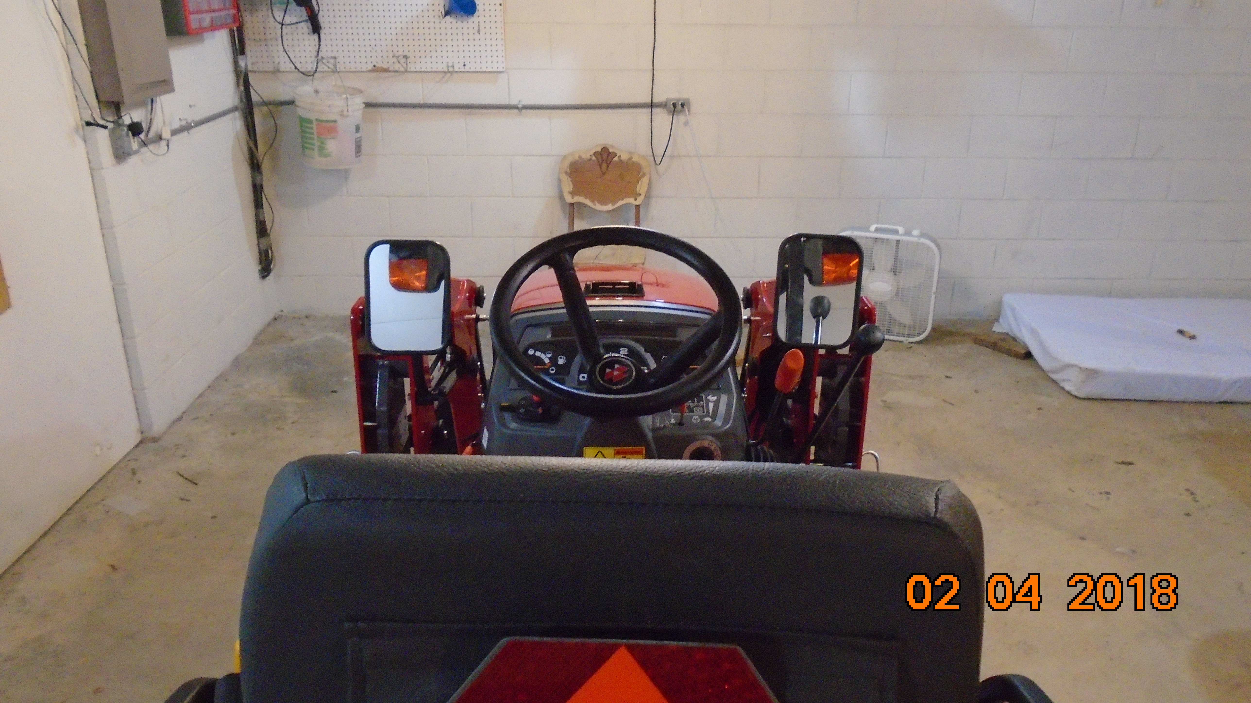

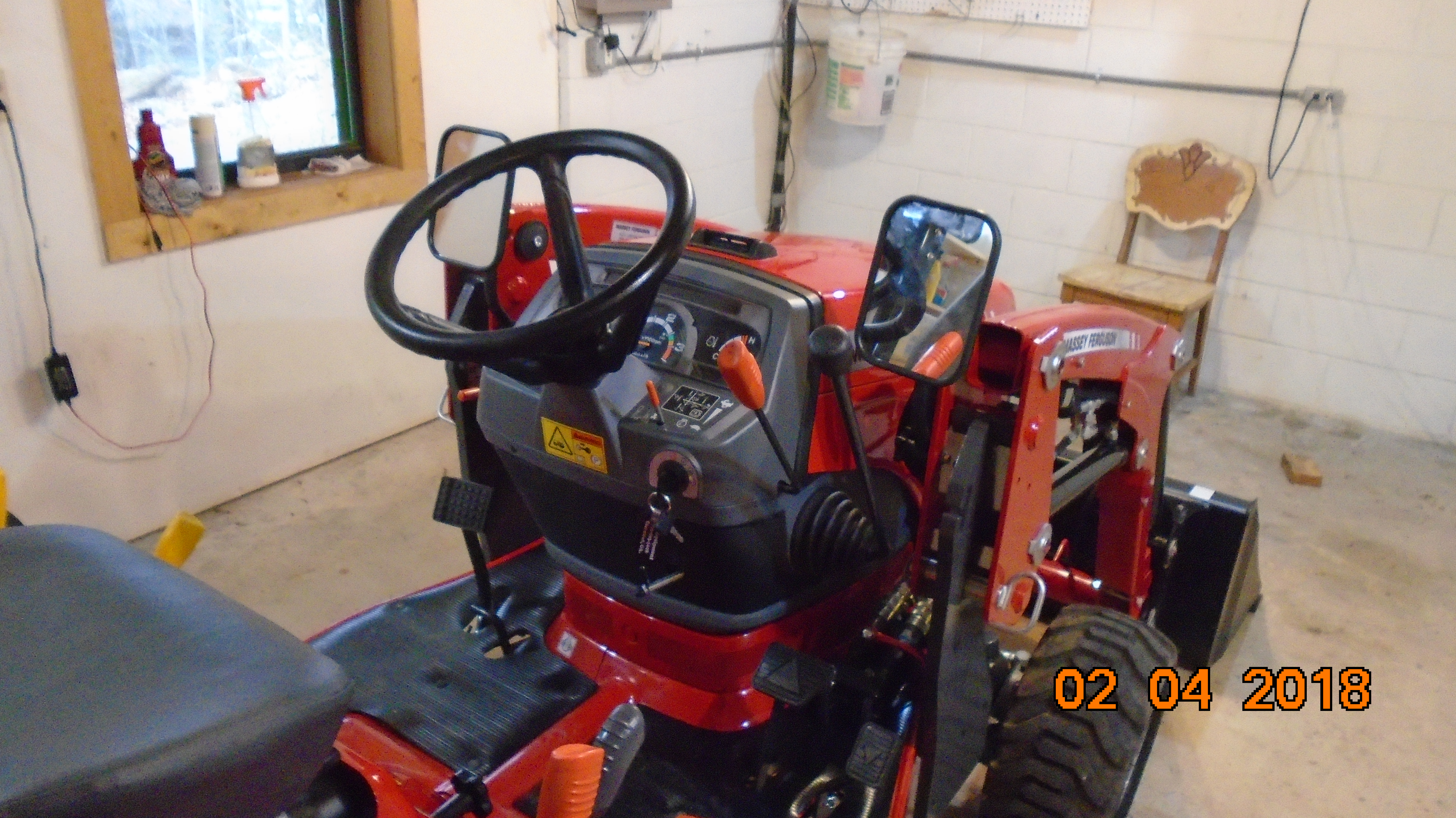

Cannot believe that MF does not even offer a mirror option. Well I made my own:

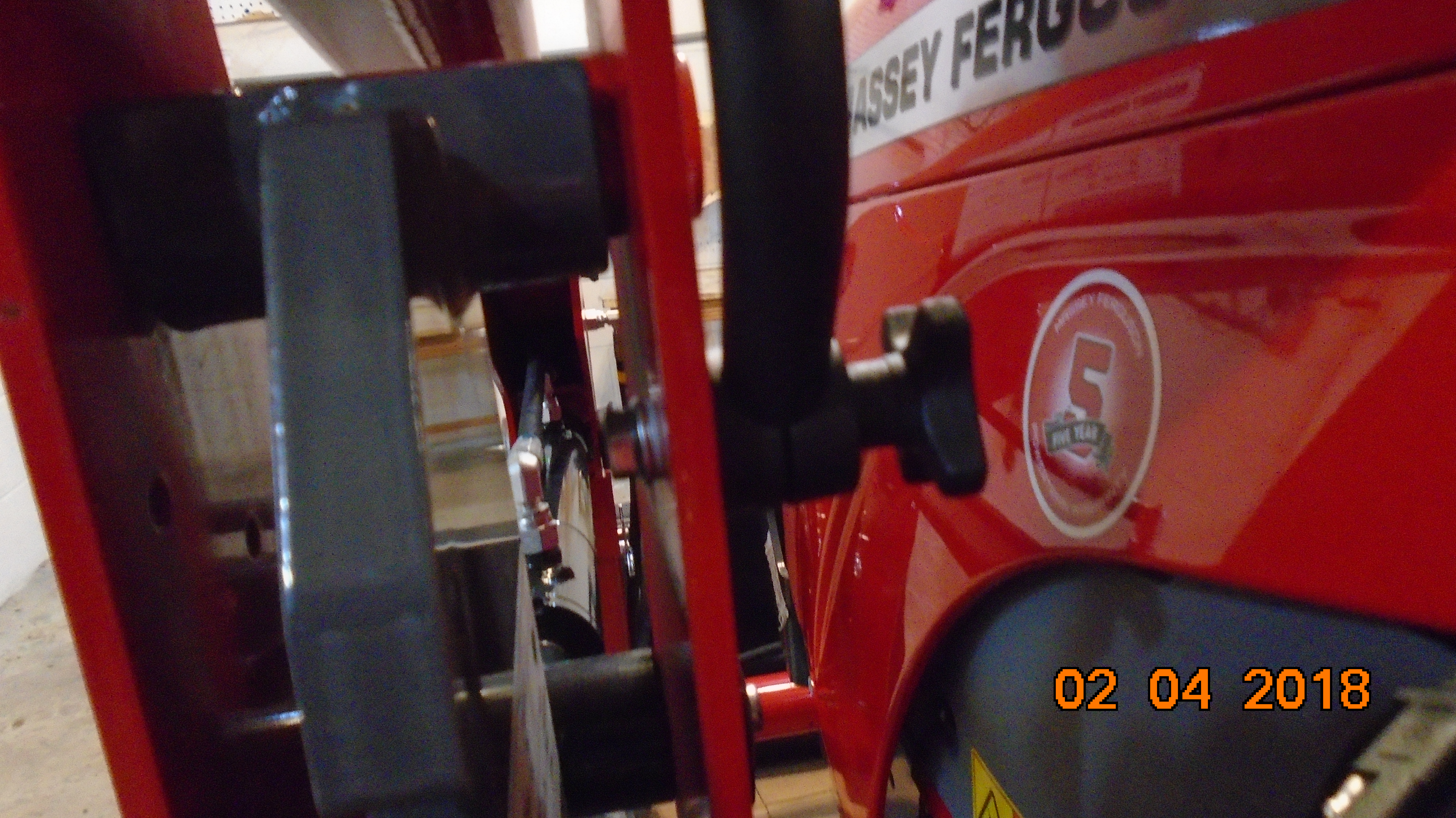

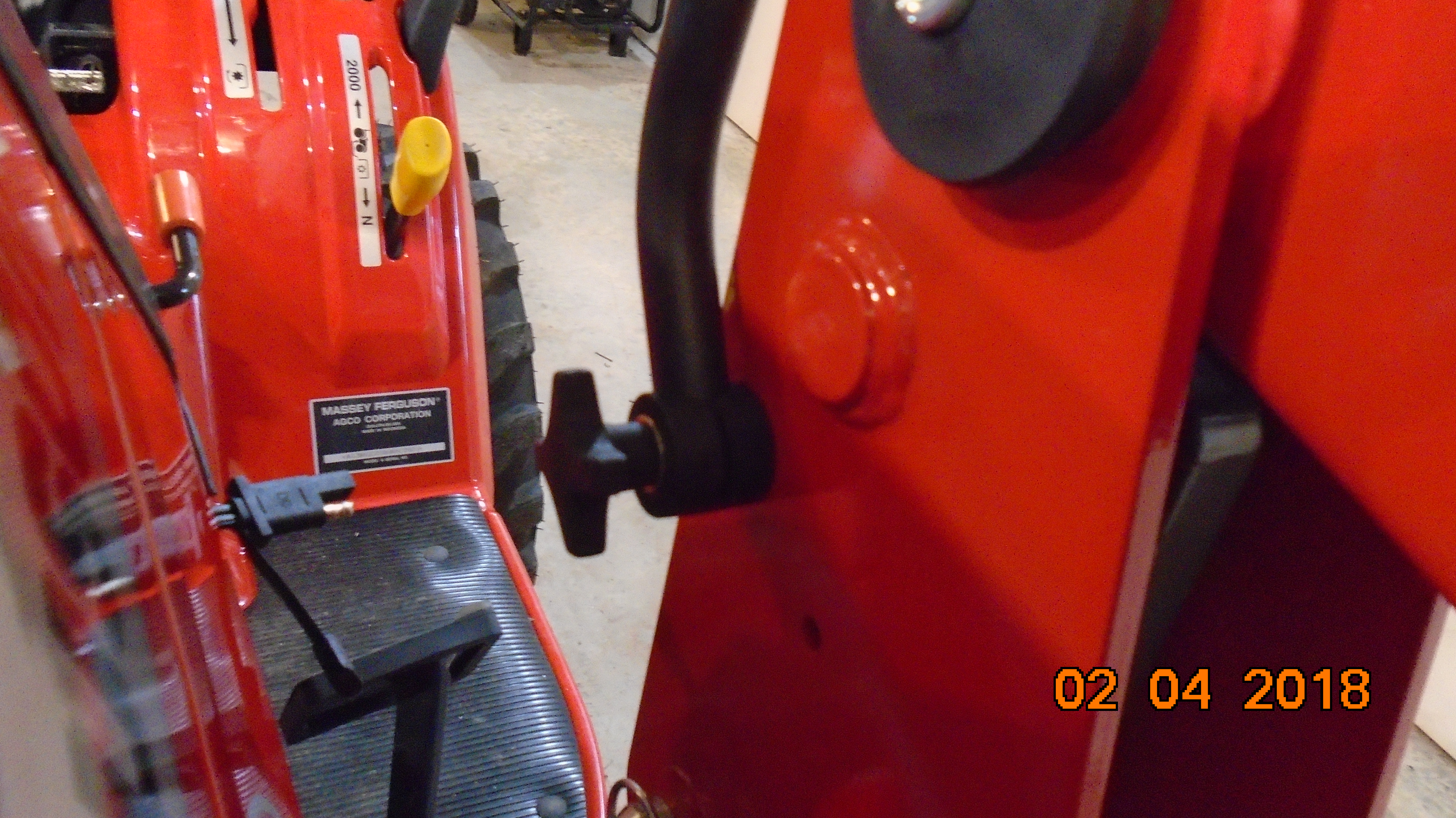

The mirrors are from Amazon, Jeep Wrangler Door off mirrors ($34.99) threw away the mounting brackets and had to drill a new hole in the arm so they would mount straight up. Used the existing hole on the FEL arm.

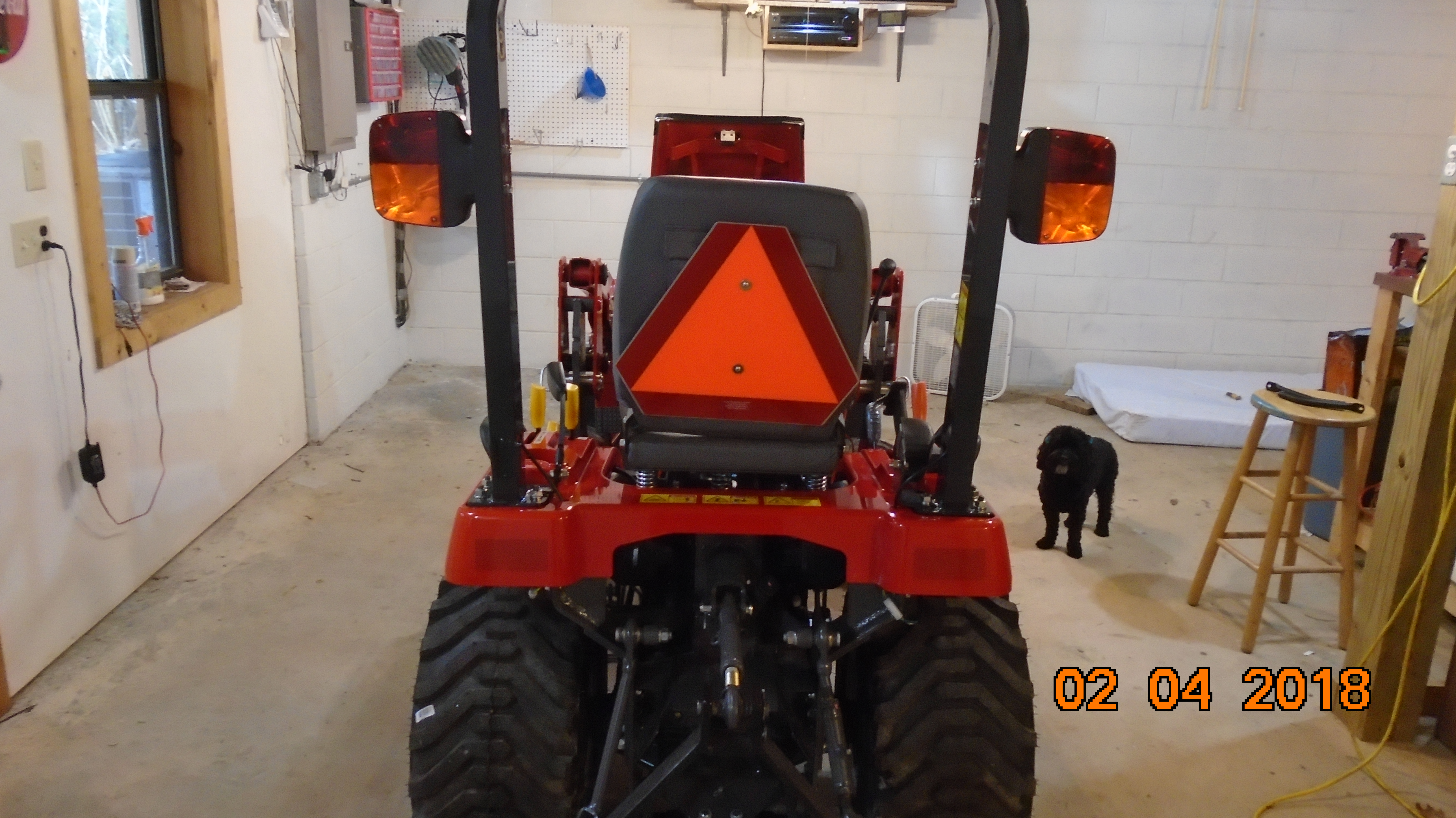

Also moved my SMV triangle, put a 9 x 12 piece of 3/8 plywood in the manual pocket and removed the rivets on the sign and screwed it on.
I just cannot get the "engineer" out of my blood. So far I really am happy with this 1705, everything I need and more.
Got one more project, move the tail/signal lights inboard

I liked your mirrors very much. When you put your fel in float mode does your right hand hit the mirror?
I'm curious why you moved your triangle. What advantage does that give you?
   / New GC 1705 Mirrors !
Benton,
No, I made sure it was far enough to the side.

The mirrors are from Amazon, Jeep Wrangler Door off mirrors ($34.99) threw away the mounting brackets and had to drill a new hole in the arm so they would mount straight up. Used the existing hole on the FEL arm .
Do you have the asin or a link for the mirrors? I found this thread looking for gc1710 mirrors and would like to copy what you did.

Might want to move lights on ROPS inboard.... Engineer who designed them did not understand tree limbs.... New assemblies are $127 ... Don't ask....
