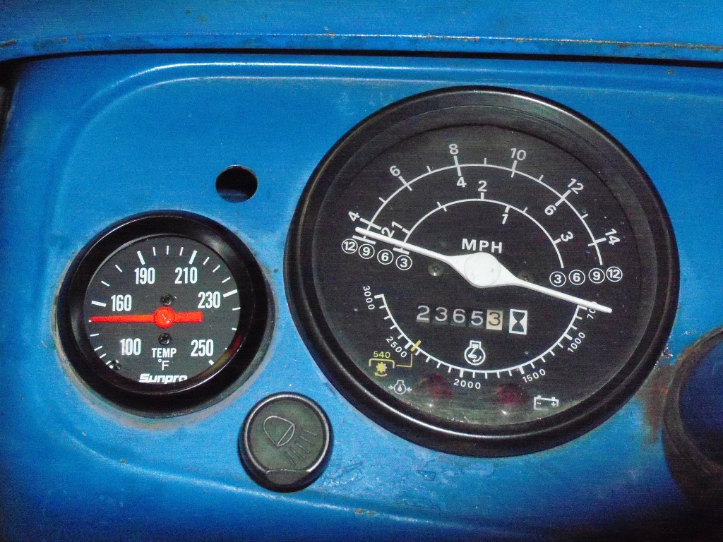

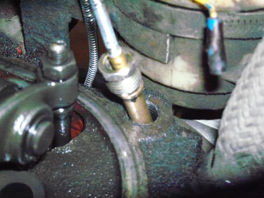

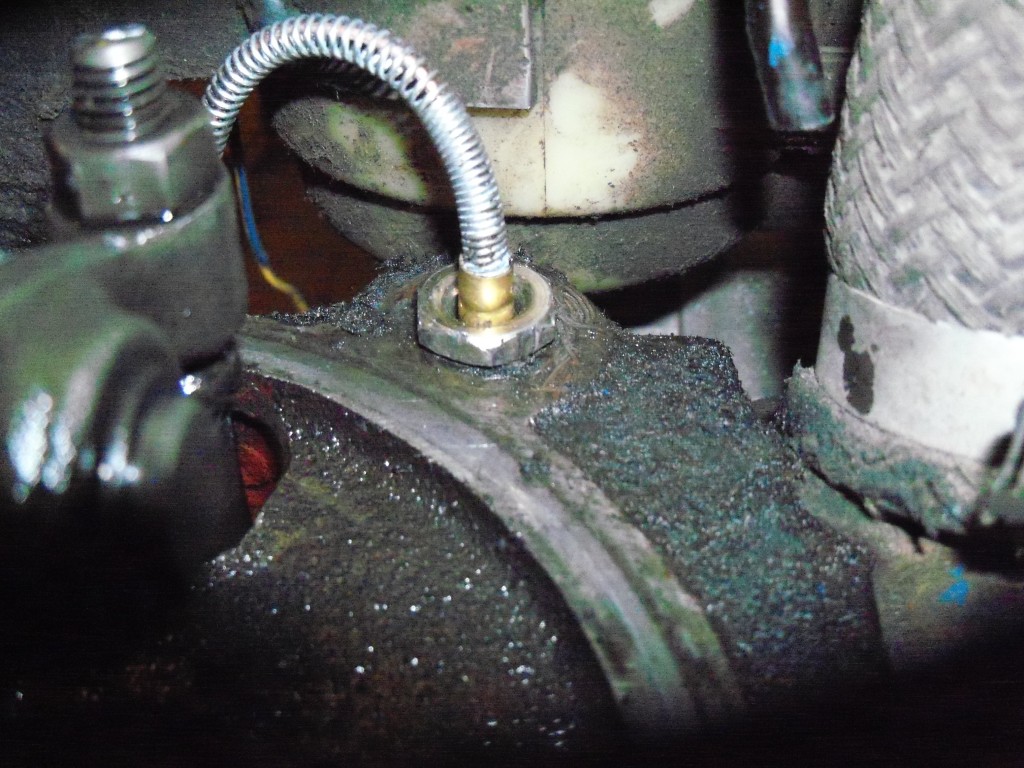

I have never liked the temp. gauge on my 1900. You never new how hot it was. I also didn't like just having an idiot light for the oil pressure. I bought a mechanical temp. and oil pressure gauge . The are 2" gauges made by Sunpro.These are cheap gauges but I have always had good luch with them. The temp probe on the new gauge fit in place of the factory sending unit without any adapters. I replaced the factory temp gauge in the dash with the new mechanical gauge. I used a 2" hole saw to cut a hole in the right side of the dash for the oil pressure gauge. I removed the factory sending unit and installed a T in the block and and hooked up the gauge to one side and the sendind unit for the idiot light to the other. I now know I have 40 psi of oil pressure at idle and the warmest I could get the engine in the shop was 165 deg. Every thing worked out good. I wish I would have done this several years ago.

Are the threads in the block NPT or metric, I'd like to do the same thing.
   / New gauges for the 1900
I had been told by a very knowledgeable person(that I believe) that the threads are metric. I don't know what threads the temp prob for the mechanical gauge is but it screwed rite in. The threads on the oil pressure gauge fittings I know are 1/8 pipe. I screwed a 1/8 nipple in to the block added an 1/8 T and installed the idiot light sending unit on one side and the fitting for the oil pressure line on the other. If the threads in the block are not NPT they are something so close that pipe thread works. I warmed the tractor up to operating temd and had no leaks.

I know this is kind of out of date but which sunpro gauge did your purchase for the temp. I had to replace the temp gauge on my tractor and the sensor will not fit, even with the adapters that came in the kit. But the guage does not show the right temp (I am guessing) because it warms up quick and then goes to hot (over 290) but the tractor does not seem hot.
   / New gauges for the 1900 #8
I got mine off ebay. I think it was less than $25, works fine and fitting screwed right into block.
   / New gauges for the 1900 #9
But what model number of kit did you get. My gauge fit the hole but sensor would not work. Would help to know what I was searching for on Ebay.
Thanks Mel
   / New gauges for the 1900 #10
There is no kit, a mechanical gauge comes with the tubing already connected to back of gauge. Check this item # on ebay
021467082170 . This looks similar to what I used, cost $14.99, how can you beat that. I believe I did wrap Teflon tape around fittings when I screwed into block.
