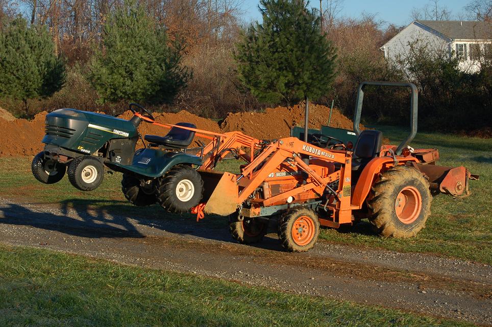

The pic I did attach was this morning's job. The ball joint snapped off the tie rod of my lawn tractor (which has been relegated to trailer towing and mail getting duties, mostly used for bringing the trash to the curb, much too far to push a can or carry a bag) the other day and since I don't have a ball on the kubotas we were without a runabout. I had to bring it over to the back door to get it near the welder, and needed to lift it up to get to the broken parts. Decided to kill two birds with one stone. FWIW, yes I did weld under it like that and yes it's stupid. Yes, however it did work and sometimes that's what matters.

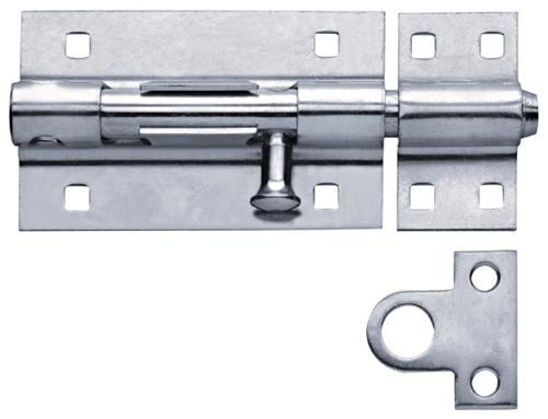

The kubota lifts 730lbs, to a height of 7'. Not quite enough to work with. The biggest problem is that if I leave a balcony such as you suggest, I have a two-story room right there to heat and cool, which is orders of magnitude more difficult/expensive. I agree that there is no safety, but 99% of safety is in the user. I don't plan to use this as a daily use people elevator (they're ridiculously slow, on the order of one to three feet a minute; making for a roughly 10 minute lift cycle) but as a freight elevator to carry things that are too heavy/bulky to bring up the conventional stairs. I do plan on having locks in place to act as a safeguard when the elevator is in the raised position, probably metal bolts through protruding straps. See attachment. I'm thinking 6 of those or something similar, with the bolt section lag bolted to the upper floor surface and the strap section lag screwed to the vertical sides of the elevator floor. I also am vaguely thinking of making the edges of the elevator floor tapered slightly, smaller at the top, and the hole in the upper floor matching so that it has a taper fit, which would also make it somewhat self-aligning. I don't plan to use the elevator floor as storage area, and as for being a minus when it comes time to sell, removal of the elevator is as simple as lowering it to the ground and removing the cables, or putting lag bolts through the join between the elevator and upper floor and making it permanent.

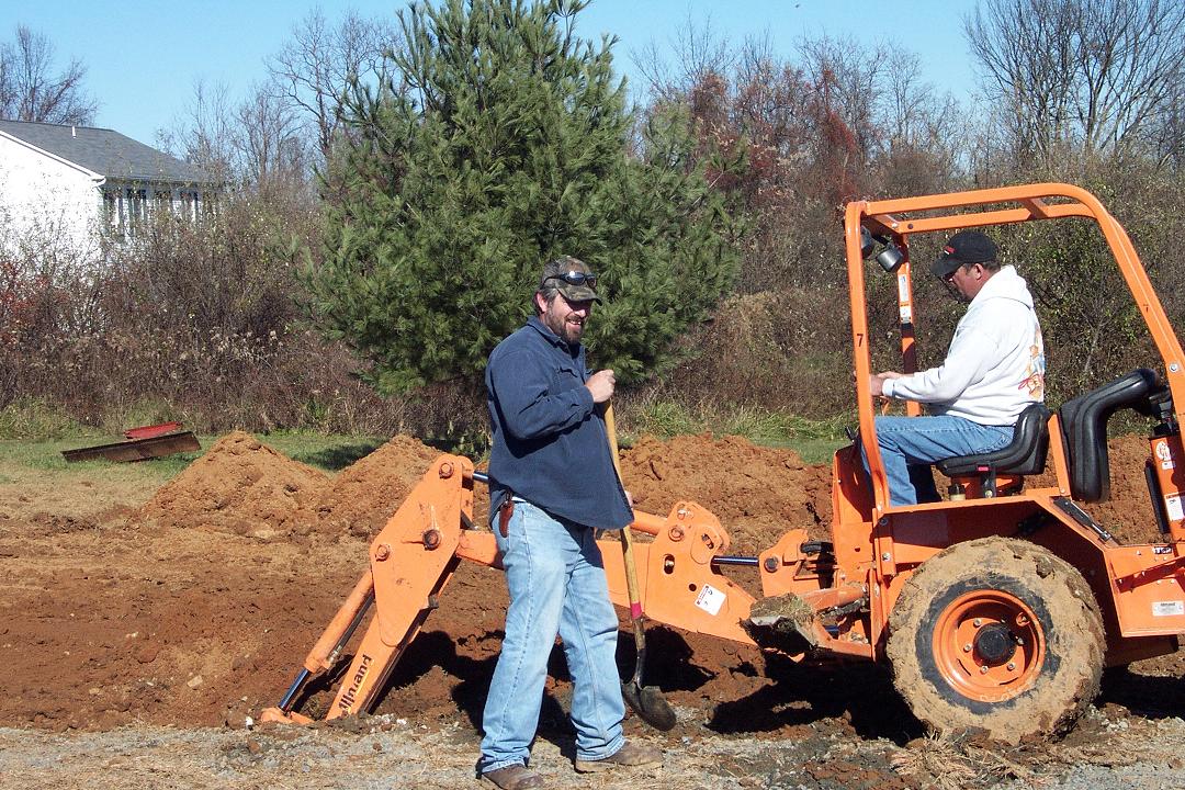

First pic is the TLB straddling the trench. Look at the mud coating the tires.
