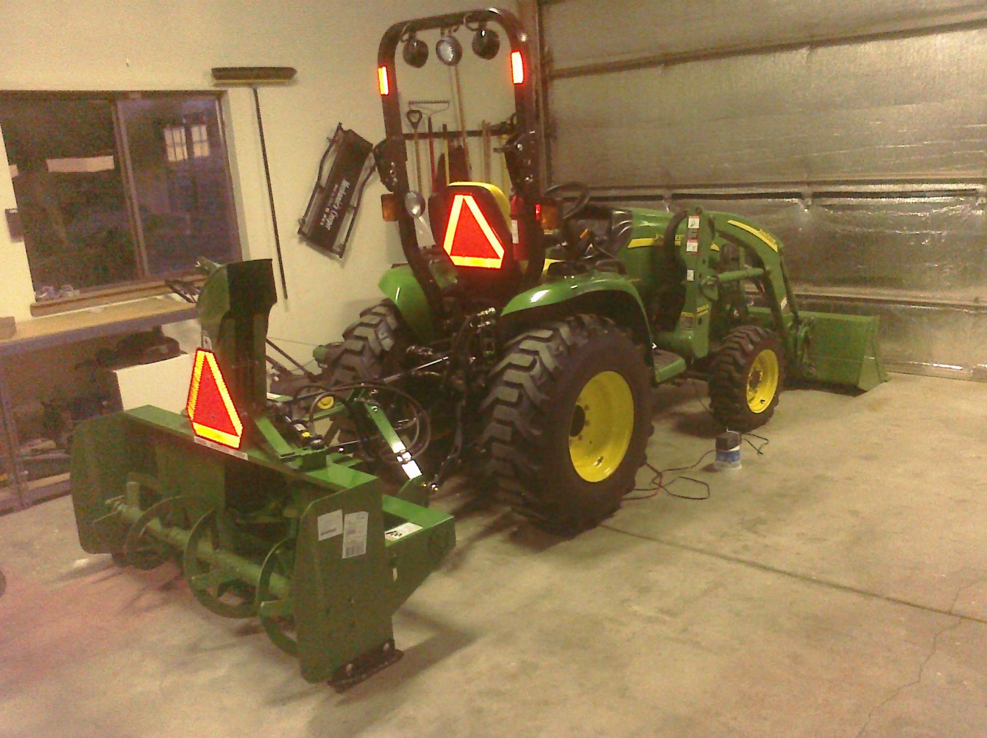

Took delivery of my Frontier snow blower today during 55f temperatures here in Colorado. I sprung for the hydraulic chute rotation but presently have only one hyd port at the rear so I am waiting anxiously for my electric selector valve to come in from Surplus Center at the suggestion of KennyD. I had to cut a large chunk out of the pto driveshaft to get the driveline to fit. A fairly good workout with the hacksaw tonight!
Am looking forward to some snow. It has been extremely warm and dry here so far since I ordered this thing.
Mike

Nice rig for snow. :thumbsup: As the weather changes.....snap a few pics, and keep us posted on how the blower works out for you.

Will let you know if it ever snows here in CO! Does anyone have a similar Frontier snow blower with
The skid shoes? I am interested in how they do on a paved driveway. I wonder if people rest the blower skidshoes on the ground or just let it float slightly above the ground. I am sure experience will be the
best teacher but a little advice sure doesn't hurt either!
Mike
   / New Frontier SB1164 #6
from my experience, IF the ground is frozen and you have a coating of snow and ice......then I like to let it ride on the skid shoes (with a proper adjustment to keep the lead edge just off the ground).
If you don't have a good base of snow to rest your skids....then I use care to not pull up stones and gravel or damage paved surfaces. (Which also can be hard on shear bolts and parts.)
Kinda a judgment call based on your base. ;)

Foggy, thanks for the info. Makes sense to me. I have a paved drive but the neighbors is
recycled asphalt. Hopefully your guidance will keep my drive from having divots and my
neighbors house spared from needing a siding job from flying gravel!
