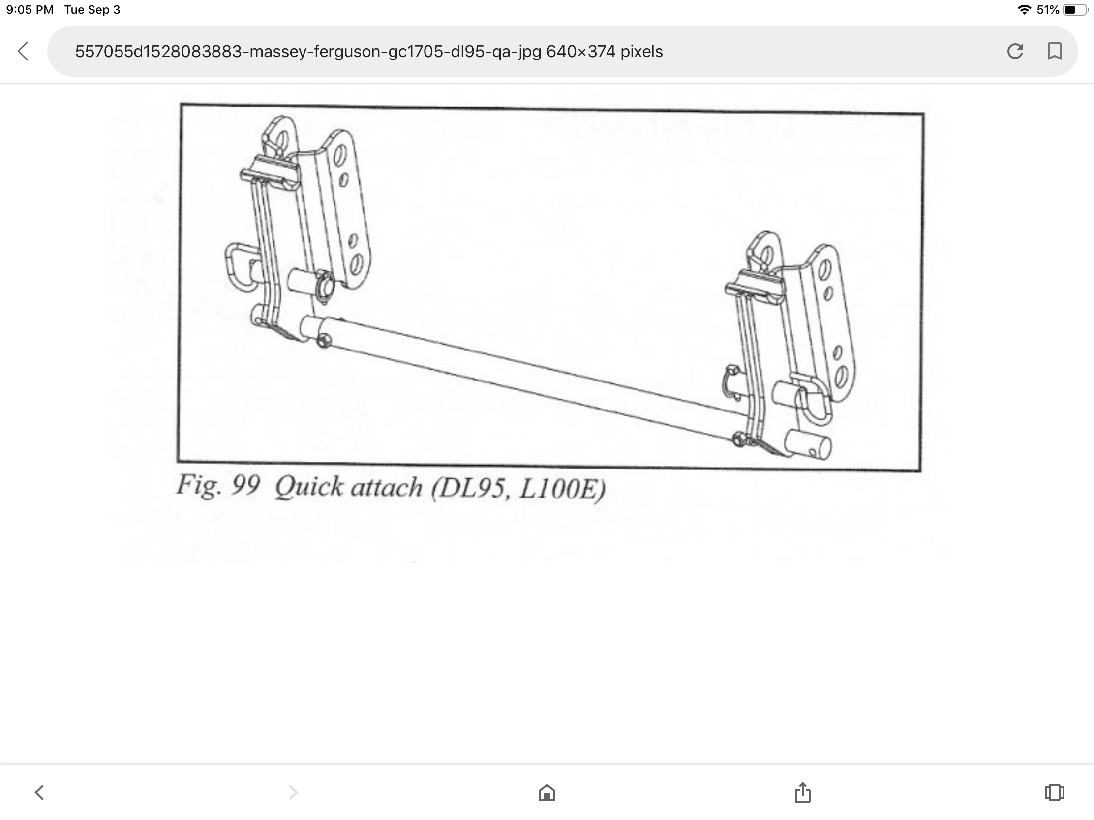

Would I be able to retrofit my GC2410 to SSQA?
   / New forks for my GC2410-been wanting for a long time. #6
That's a great question. What's your loader model number? DL100? If you search agco's parts book using the loader model number and look under attachments AGCO calls an SSQA "tool kit" and not Quick Attach or Skid Steer Quick Attach. Over the years there's been aftermarket SSQA's for both the DL100 and DL95(which is what is on mine)

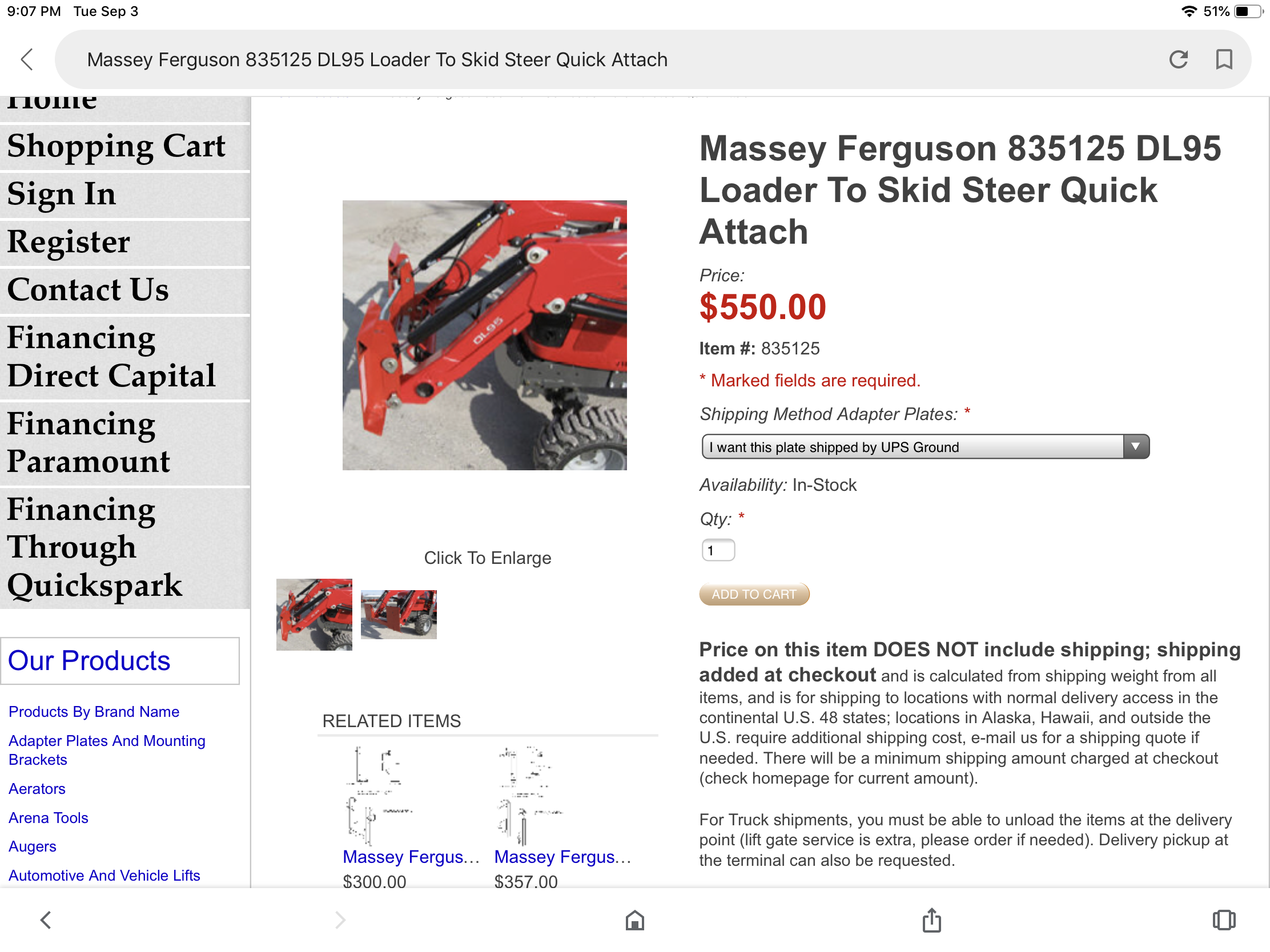

U.S.PAT. # 8,393,59
I've seen folks rave about this place for older DL100 units as an aftermarket solution. I believe it's their own quick attach system but they have super light forks which double as 3pt mountable as well. They also have other attachments like a grapple if that's in your wheelhouse. I looked up the DL100 which I assume you have and AGCO/Massey didn't make a SSQA system for that.

Thought I seen a video where they said this fits both 95 and 100 FEL.
The manufacturer of the DL100 and DL95 are different so I'm not sure the geometry is the same.
Ill have to look at the measurements and go from there, would be nice to have. I also just realized that I am a dumb ars-I forgot that the edge tamers I have for my loader also have an extender option-only 12 inches. nothing I can use for pallets though.
