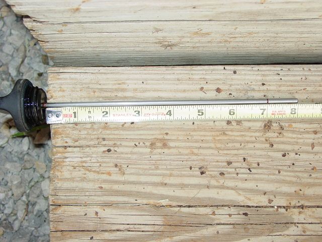

1. Just recently changed my trans/hydraulic fluid and noticed that my dipstick looks to be homemade. Took out hydraulic filter and it was fairly clean but there were some metal shavings on it. Anything to worry about? Put the 5.8 gallons that the manual calls for and the fluid still does not even touch the dipstick yet all hydraulics work great. Do I need to add more fluid because I have the FEL? Also if anyone could give me a length on the dipstick from the bottom of the cap I can fab up a new stick sometime.

1-Look at the pic below. Make sure your home made dipstick conforms to it. Normally the same is right level with the loader while the bucket is o the ground. Bucket up and obviously the level goes down but at no time is below the intake of the hydraulic pump. My Ford 1700 does not have a hyd filter but a screen in the diffy. did you see metal shaving there?

Thanks JC. Yes the screen did have some metal shavings on it but I dont think it was anything to be worried about. It was actually pretty clean compared to your photo of the screen on yours and other photos that I have seen. The trans/hyd fluid also looked fairly clean as well but it was mostly just a piece of mind thing for me with winter coming up. Thanks for the dipstick picture, I will work on getting a new one fabbed up. Any idea how much a hyd block would run me for the rear remote? I meant to put in my second post yesterday that the starting problems are only when I first fire up the tractor for the day whether it is 80 deg in the summer or -10 deg in the winter. After the intial start for the day it is always fine. And once the engine is warm there is never any white smoke and I never have to use the glow plugs until it sits overnight. I do also run an inline heater on the coolant line in winter time so insure that I have a warm cooling system on first start up. You ever mess around with putting a frost plug block heater in? I would rather have that than an inline coolant heater. Did not see any oil residue in the radiator when I did the water pump swap this past February. Of course when I did the swap and drained all old coolant (which was kind of dirty and old looking) and topped it off with new 50/50 mix. Thanks again for any advice. Still pretty new to the tractor scene and diesels as well.

I have never has issue stating it in cold if I preheated for 20 second, so no I have not messed with it. I would not worry about the shaving. It might have been first time it was drained and hyd oil replaced. I don;t have you have any issues on how it starts with the glow plug. Below couple of link that might help you with the hydraulic.
