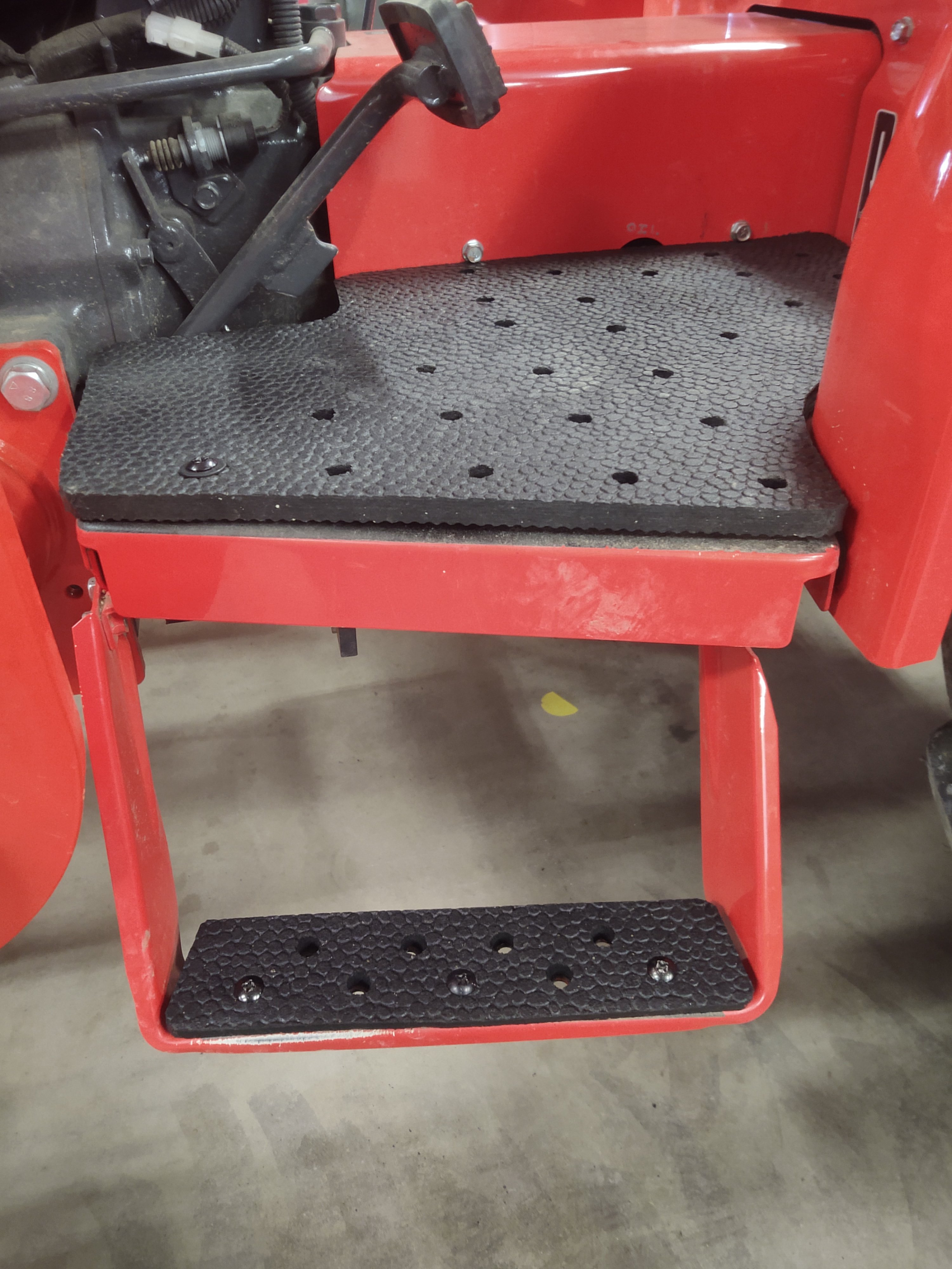

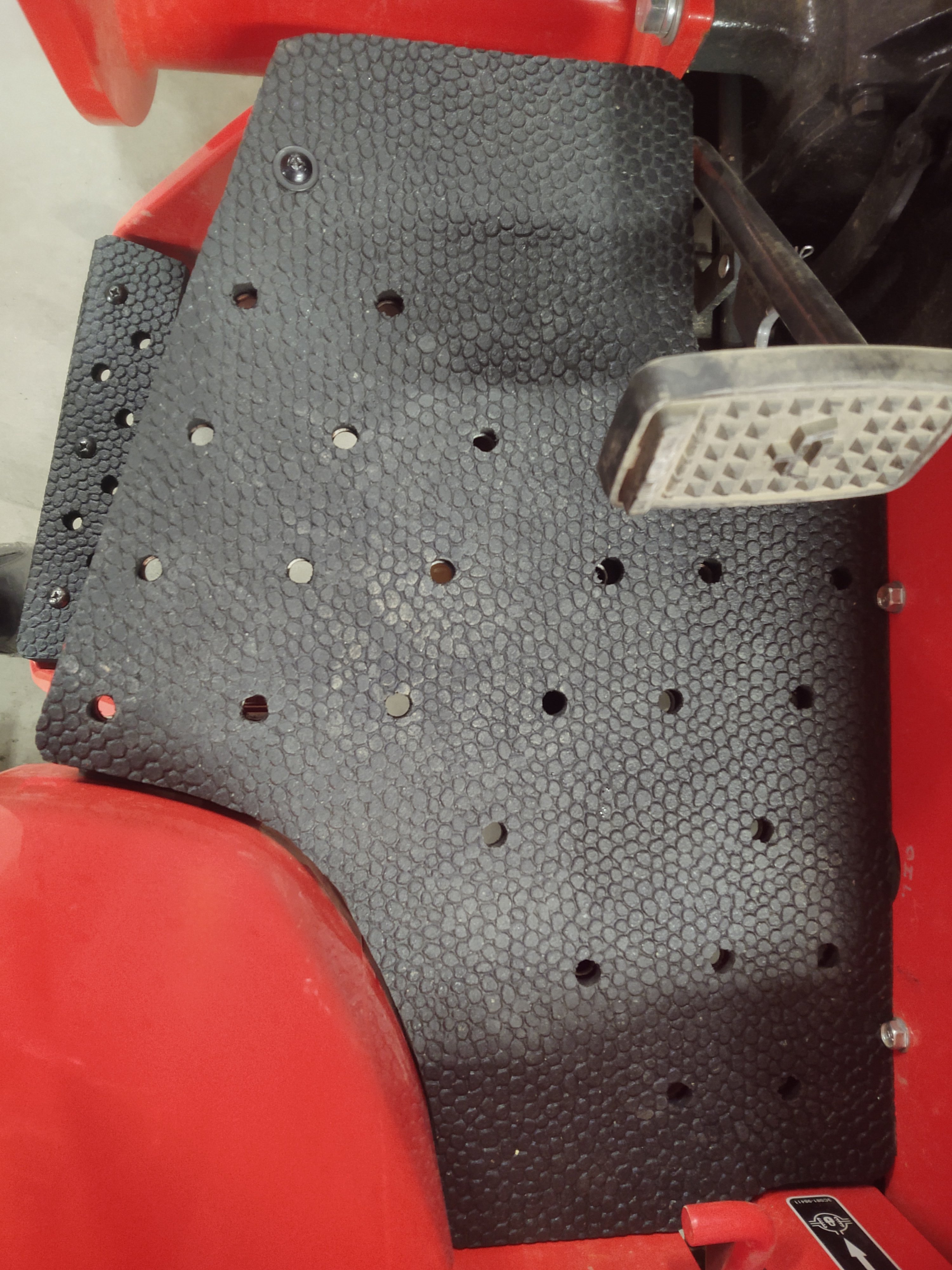

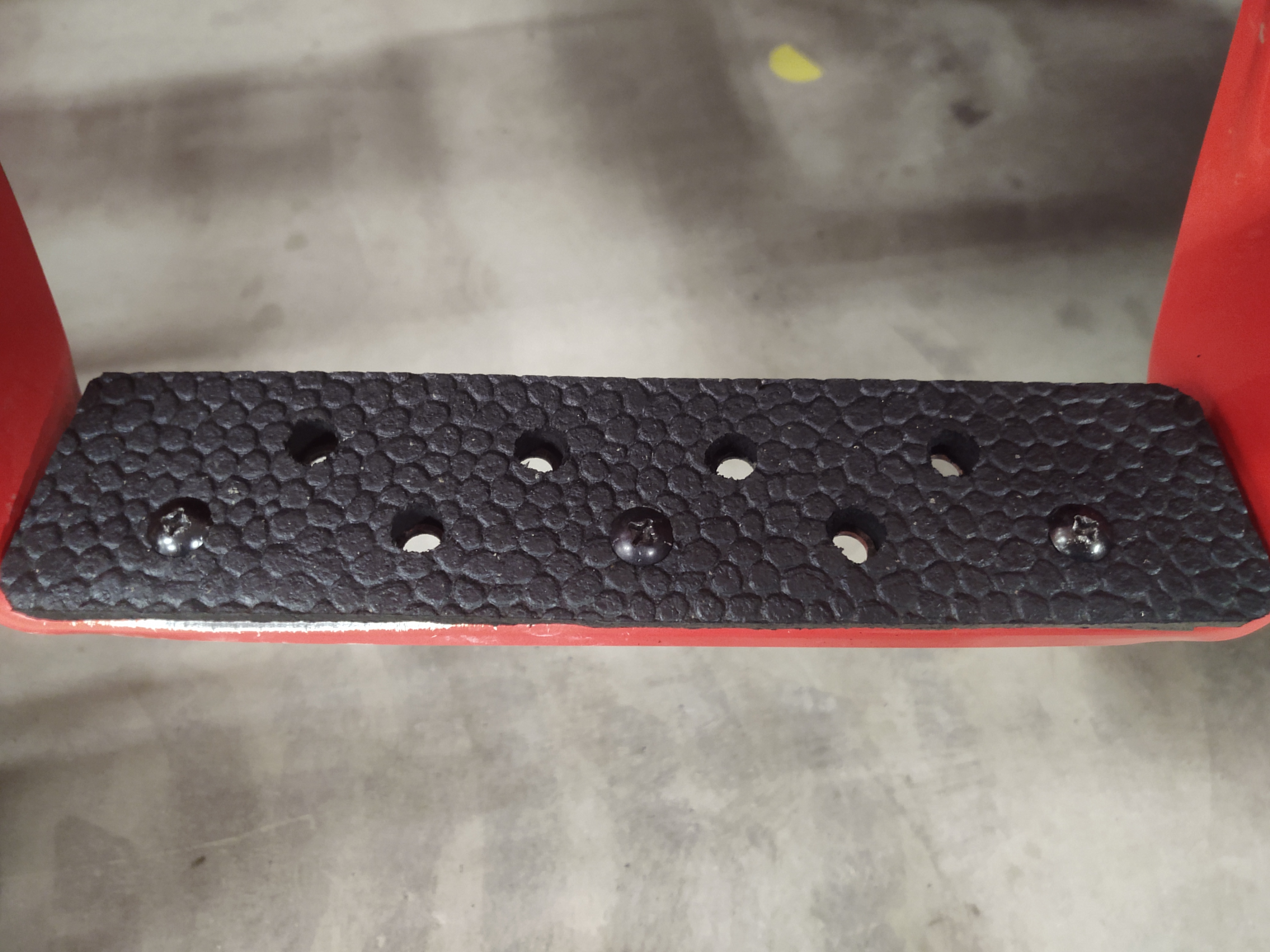

Made these from the thinner size stall mats at tractor supply. Stole another person's idea, but definitely a keeper.

I had previously done the spray rattle can bedliner but wasn't holding up, and was still slippery hopefully this will be better.

That will work well. I used it for a bed mat on my truck. It has performed perfectly.
   / New floor mats #5
I don't care where the idea came from. The OP's execution is commendable. 5/5 :)
   / New floor mats #6
You'll like the difference. (y)

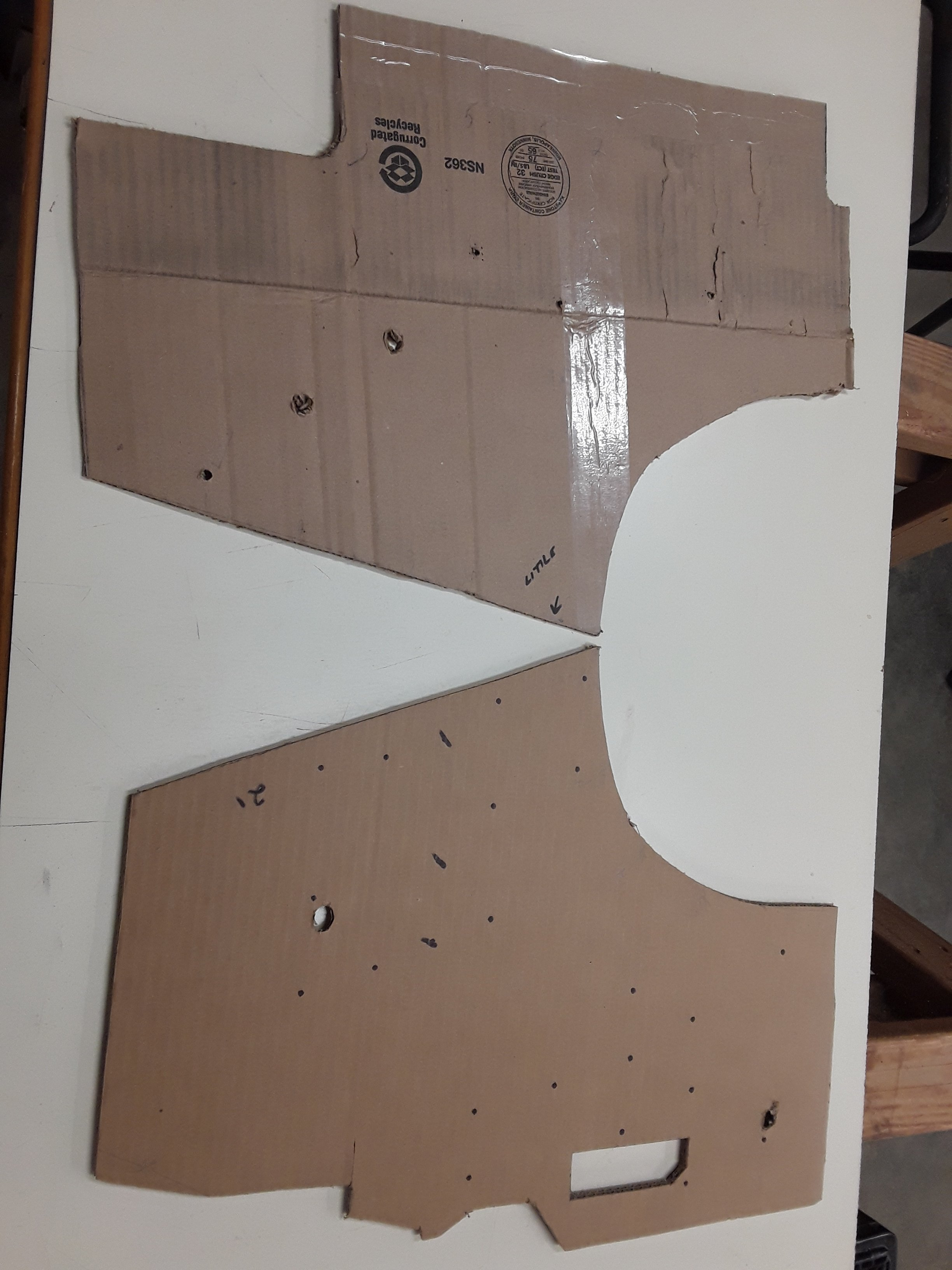

just curious, how did you cut them out and make the holes? very professional job!!
   / New floor mats
Utility knife, with a couple new blades. I used a cardboard template, then once I had the mat cut out and in place, crawled under and used a sharpie to mark the holes. A kinda dull drill bit, that would heat up and melt the mat as it went through. Then on the bottom side I used a step bit to open the holes a bit to fit over the stock holes on the floorboard.20210306_094957.jpg
